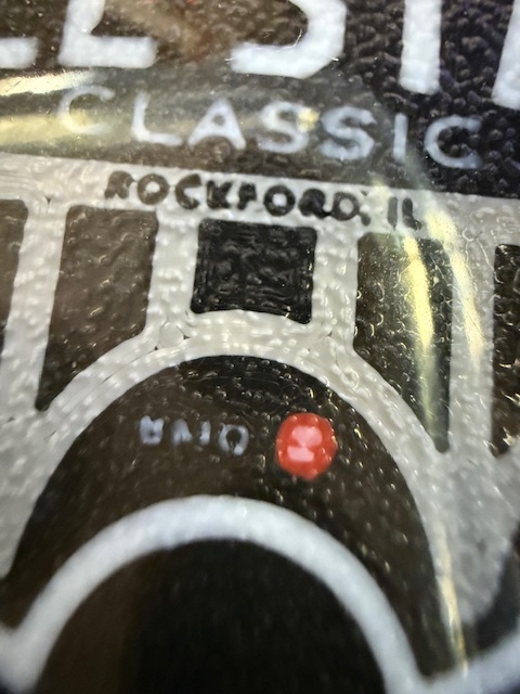

I’m saying that more from a quality standpoint with current steppers and absolutely see more to come from other aspects. As an owner of and a big fan of toolchangers I’m excited about Bondtech’s up and coming system but also feel much of the print quality issues people are experiencing on all printers are stepper related. I’ve not found a stepper yet that doesn’t give VFA’s at speeds under 120mm/s. I print a lot of PETG and it hates higher speeds and lower print speeds give the VFA’s. Stepperonline 2504’s give me the best results on my home built but PETG prints are still mediocre at lower speeds. Qidi and Orca added a “resonance avoidance” setting to their slicers to help avoid speeds that cause issues. The H2D not being compatible with Orca is the biggest drawback with the printer that I have.

most corexy printer do the worst in 70-120mm/s range. VFA has nothing to do with layer height though. Unless you’re talking about layerheight being too high causing underextrusion, which then causing matte finish, which then is hiding the VFA slightly better.
It doesn’t help nearly as much as I hoped it would, ultimately I set my minimum print speed to 140 mm/s in cooling and bump up flow rate to minimize VFA’s.

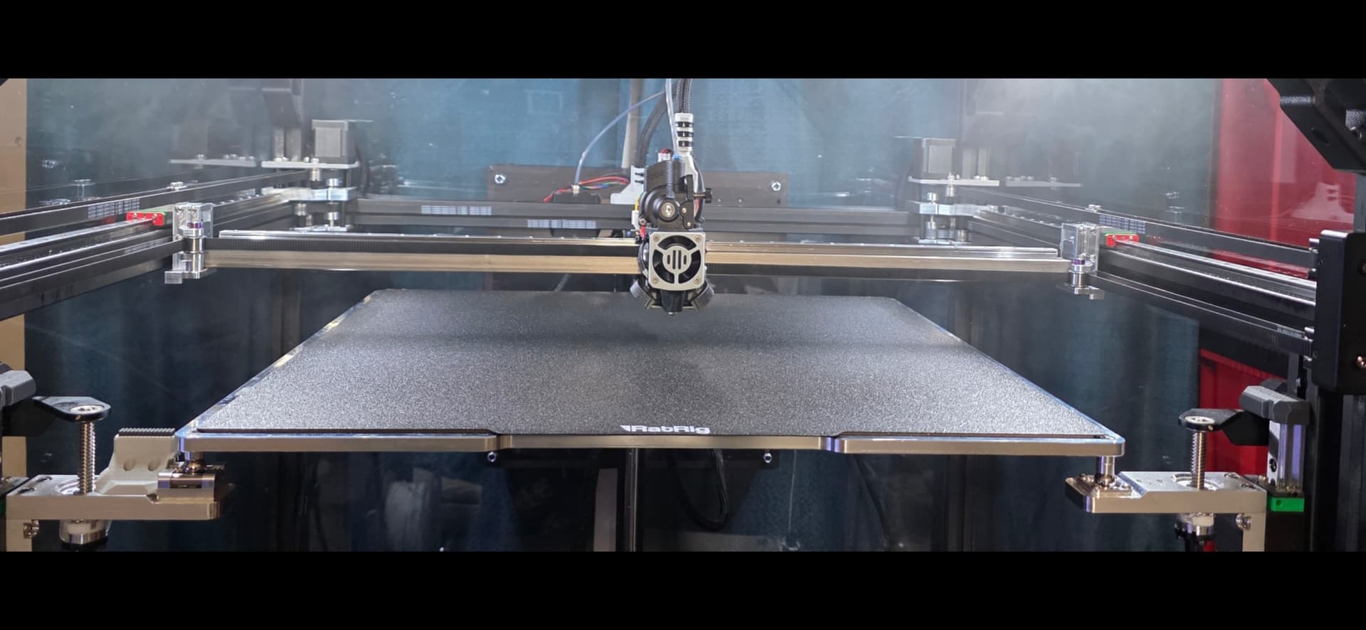

This is my other printer… It exhibits the same VFA’s at similar speeds as the HD2 does. It prints slightly slower than the H2D and is much much louder and it’s not nearly as hit print and walk away as the H2D has been…

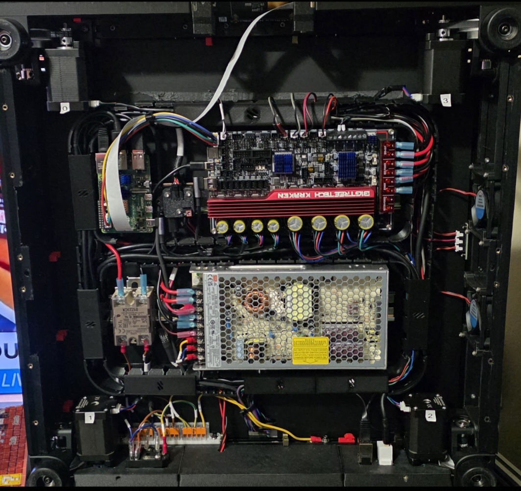

Try ldo super power 2804AH(2504 if you want to go 48 volt) steppers and TMC2240 drivers. Awd will make a huge difference too. Also going up to 3030.

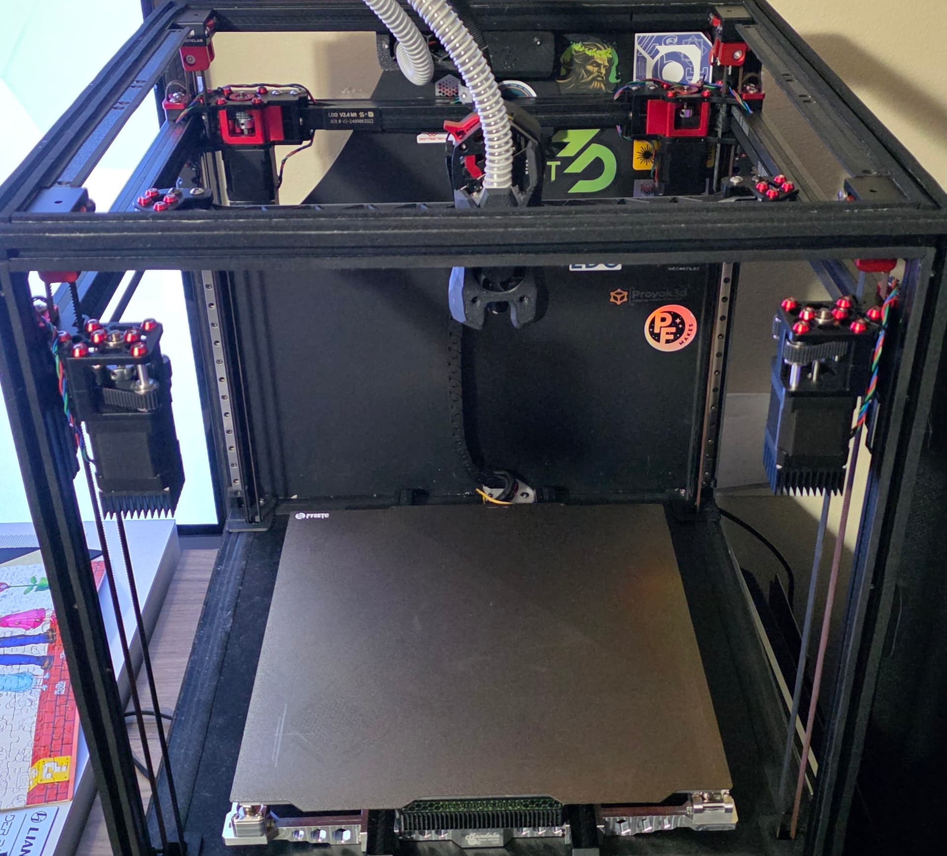

My Voron

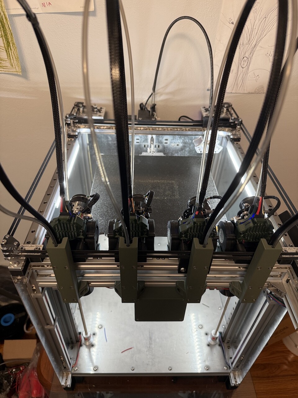

Ratrig
