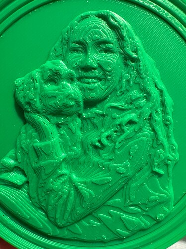

I don’t know why this downloaded STL file from Relief Sculpture Maker is printing so bad???
This image is the file in Relief Sculpture Maker:
This is how its printing
I bought a X1 Carbon and second time ever printing small tests.
Thanks
Mark

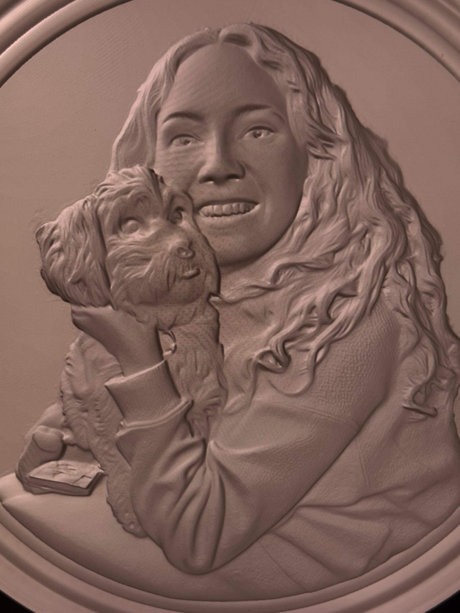

Thanks
Mark
Download the .3mf file instead and you’ll see that it’s supposed to be printed standing upright at 0.08mm. Yours looks like you printed it laying flat on its back.
Thick layers, so no problem with the model, just with the print settings.
You can try to print it flat with very fine layers or upright with very fine layers…
Have you had success with this? I had a successful print with vertical orientation, but with a circular frame it left some pretty ugly support marks at the bottom.
I tried printing it flat and same thing happened. Put it back in the vertical position and it came out really nice.
