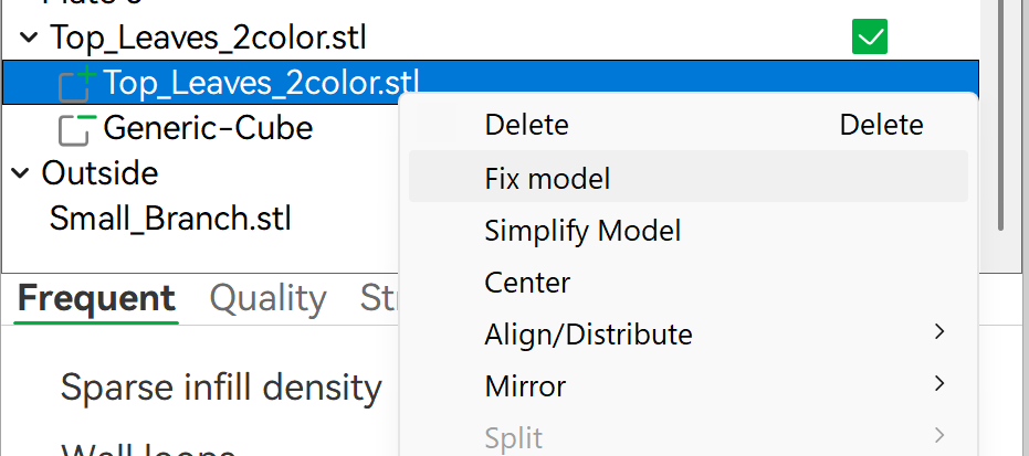

You may need to use Fix Model to tidy up any damaged manifold objects if it complains
Does not work unfortunately, gives me an error: “Unable to perform boolean operation on model meshes. You may fix the meshes and try again. Reason: Part Top_leaves_2color.stl has self intersection.” I don’t know what that means… I also don’t understand why I can’t remove anything from this specific object with another primitive and a boolean operation. It completely ignores boolean operations!
No, it can’t be split. Gives me an error.

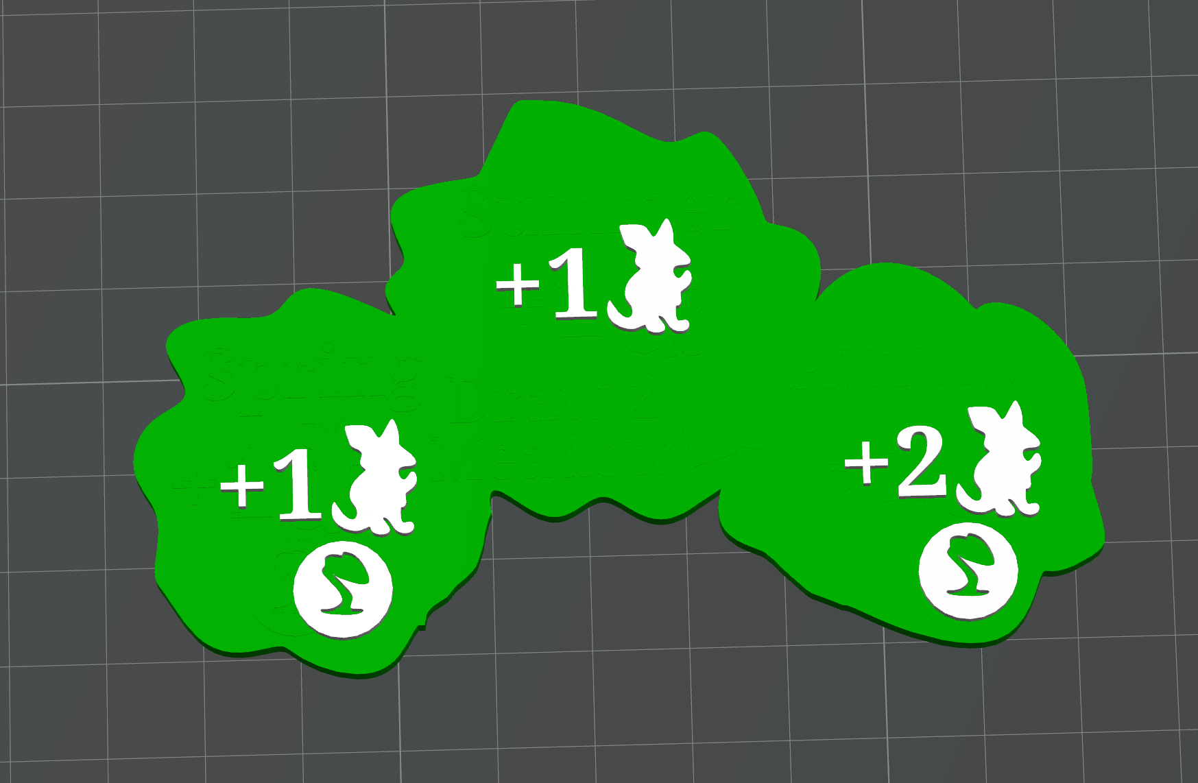

Is that what you had in mind? I tried to fix it, but the model seems to be damaged, so it didn’t work with boolean operation. I did a workaround with cutting. You can still move the individual parts; I have separated them.
Everdell Tree Plates.3mf (1.4 MB)
Usually, you can correct the model clicking on “fix model” when an error message appears, but that doesn’t seem to be working on this model.
