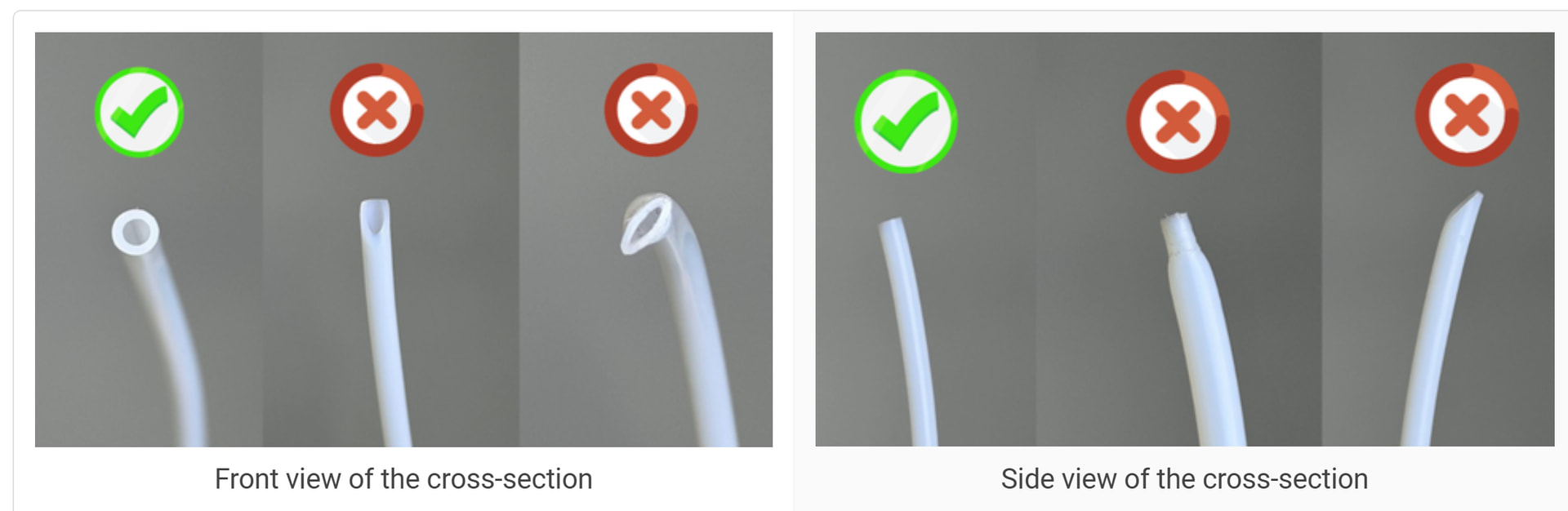

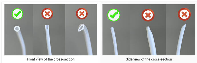

Show us your PTFE routing please. Both outside and inside the printer.
And just to add: The cuts on the tubes must be clean and straight.
