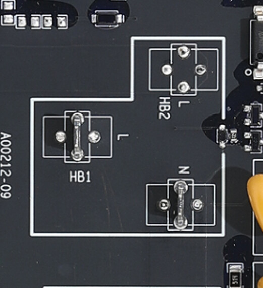

Long story short, my bed failed and Bambu sent me a replacement. While taking apart my H2D, I noticed my printer has an AC board with three bed cable ports (for the red, brown, blue cables), but the new bed only has two (brown and blue). The replacement guide doesn’t mention this at all.
I found a note in the H2D → H2C guide saying if your bed has three cables but the board has two ports, contact support—but nothing about the opposite case. Looking at the shop images, it seems they’ve updated the AC board and removed the third connector.
I’ve contacted support but won’t hear back until after Chinese New Year. Posting this as a heads-up for anyone replacing their bed, and to see if others in the same situation just plugged in the new one. For now, I’m not touching it until support replies, just to be safe.

Edit: I did not look at your picture, so it’s 2 lines and 1 neutral, so no ground. Could be 120/240V but most likely 2 heating elements that are now interconnected within the bed.

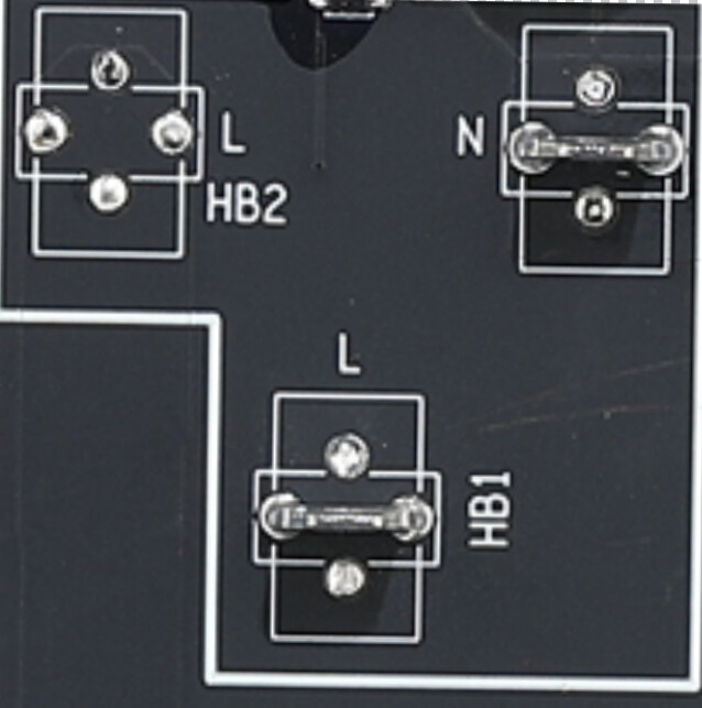

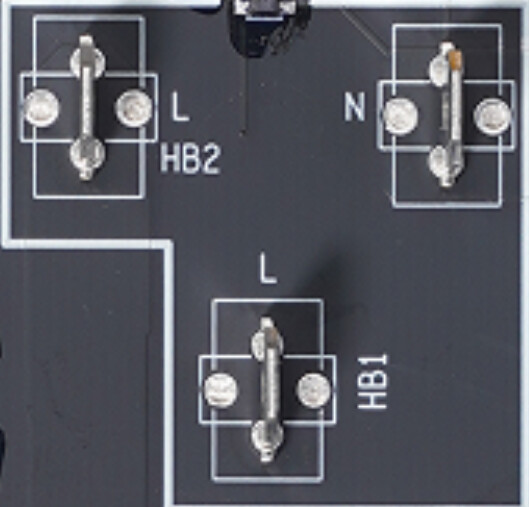

Yeah looking again at the store listings I realized too the connectors on my board are vertical, and the new version seems to have made them horizontal (utilizing the other 2 solder pads)
Old version
New version
If you rotate the picture, it’s the same is it not?
I went ahead and edited the photo to be rotated, sadly tho it appears they solder in a different directions as well as removing one of the “load” ports.
