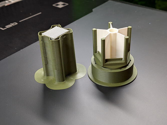

In the image below, you can see the same part printed 3 times (the two on the right were aborted):
  1. The print on the left is printed in a single color printed without issue.
  2. The prints in the middle and right were printed with two colors and you can see the gnarly issues on both the model and also the prime tower.

As a test, I printed this part using multiple colors but with a single nozzle & purge. The part printed well (as can be seen below) without the issues I’m seeing when using multiple nozzles. Even the prime tower is cleaner which feels like a clue.

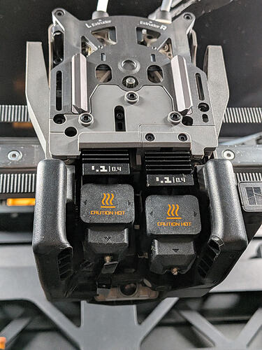

Unfortunately, I cannot pinpoint a specific time when this issue began as I’ve been using this device for single-color prints for some time. For reference, here’s an image of the toolhead - you may notice that I’ve installed the TPU High Flow kit but this issue was present before and after the installation of that kit.

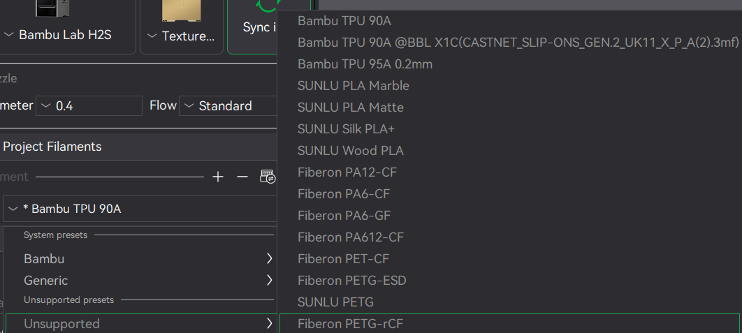

I understand the tower results are expected with the h2d , are the filaments the same type ? are you using a unsupported profile ? personal profiles (filament) appear to be constantly been moved there , especially on other printers , even though they appear to remain in the 3mf
In these tests I’m using the Bambu profiles and testing the same rolls of filament in other devices (using the same profiles) and can confirm that they print without issues on other devices

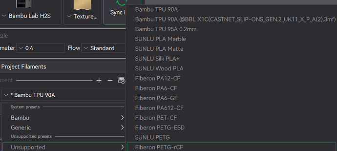

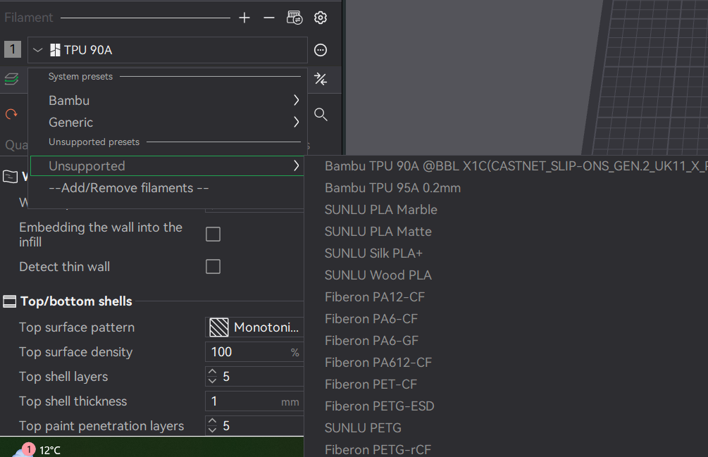

I recently had a model with a custom bambu lab filament profile for tpu 95a , i found its profile was unsupported and had been removed , it came from another printer , once i changed it back to its default it was back on the supported list within studio . so i thought it was worth asking
I found the model (90a tpu)

Thanks for this idea - it was good to check. I was able to confirm that I’m using supported Bambu presets in this case but I’ll be on the lookout for this in the future.
