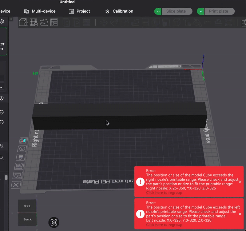

I have 2 ams pros, 2 filament white pla, one on each ams, but in bambu studio, I cannot use both of them to gain full build volume?
To print the full 350mm width you need to:
  1. Cut the item into parts
  2. Add multiple instances of the same white filament
  3. Paint the cut piece with the secondary white filament
Keep in mind the place where the part is cut will have subpar strength and a visible seam.

Would the interlocking paint layers setting help a little bit with the loss of strength?
Yes probably, but you will still have a seam in the object at the boundary that is visible. If you set the interlocking to start at layer 0 it will be even bigger.
Totally a known restriction in the specifications when purchasing the printer new. You will have to work around the limitation.
Whoops nevermind, it was a glitch. Cause it was multiple parts but it only showed that I had one white filament when I have 2, one of each ams. It let me this morning.

I managed to get it working, I think it was a glitch on my side because separate parts, only one ams roll registered instead of both of them.
