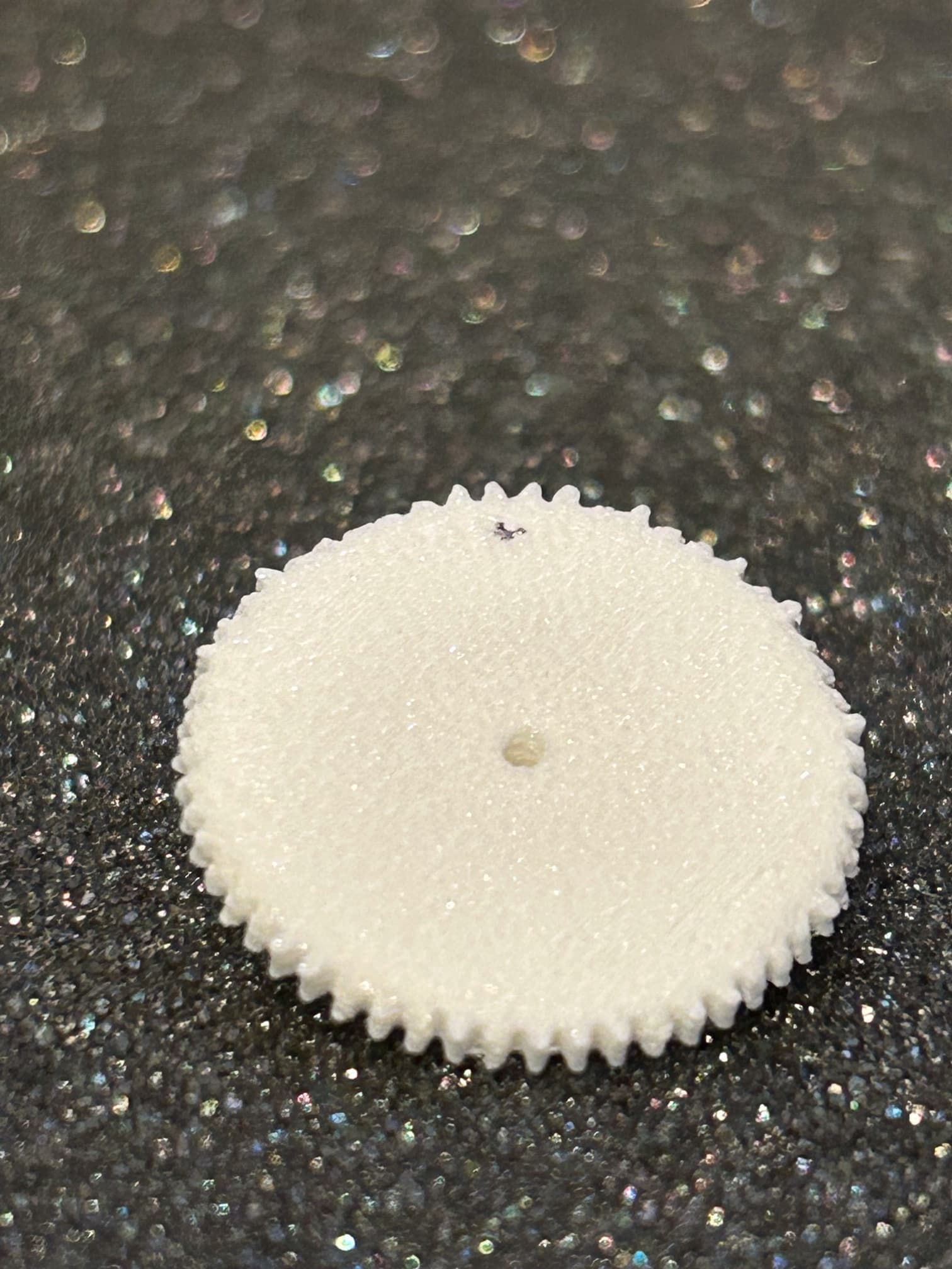

I designed a small gear (internal workings for a vintage turntable) using OnShape and after the print, the piece seems to have a reverse elephant foot thing going on (narrower at the bottom)…it isnt a huge amount but it may impact the ability to mesh the teeth.
Are there any settings I could try to get more square edges?
I hope the following will be enough info, and I can supply more if it will help with troubleshooting:
P1S with AMS, standard PLA (12% humidity), .2mm nozzle, .1mm layer height, random seams, have tried speed of 120mm/s down to 30mm/s

Show the side that was attached to the build plate if possible
Running with @Impeller_Warehouse’s idea currently and for @Bullocks, here is a 3pack image of one of the test prints…hand for scale, profile, bottom surface

Bottom looks like your first layer Z is pretty close to perfect. Additionally, the teeth are getting messy pretty far above the first layer, so elephant foot probably isnt in play.
On super small parts like this it might be a lot of things.
My thoughts:
  1. It looks like it might be curling up on each individual tooth, which might be remedied by less plate temp / nozzle temp, extra fan if not at 100% already, or using a non-textured sheet. Those gears teeth are basically the same area as the speckles in PEI, so like… hmm. Smooth plate (with glue) if you have one?
  2. Try arachne wall generator, it can maybe make those tiny extrusions even tinier…
  3. Pressure advance calibration, but if you said it happened even at 30mm/s this might not be the relevant issue.
Ran the print again with the elephant foot compensation setting and this is the result (didn’t change much), but it did provide more info…according to the new pics, it looks like the teeth are not curling up but just not laying down material.
The pic of the bottom has a small black dot for reference, those teeth seem to be fully formed.
The two side profile pics show one where the edge is more “square” vs the one where the edge looks angled.
**sorry for the quality of the pics…hard to shoot something so tiny up close
OH…the black speckles are coming from a piece of foam I am using to shoot against, it isn’t a print plate (and unfortunately I only have the textured plate…will buy a smooth one eventually)
I’ll give it another try with the arachne wall generator setting…luckily it is a really fast print and takes about 3 cents of material

You can try to MacGyver a “smooth” area on your textured plate by smushing it with gluestick and evening it out with a wipe. I think it’s telling that some of the teeth seem to retain shape, and some do not, - and the ones that do not, look like they are pulling up. If you’re available to be bored to death, it might be interesting to visually watch it as the first layer goes down. Make note if the teethies are adhered after layer 1 finishes, and then check back at the end of the print and see if they exhibit the same pulled up look.
Might want to slow down those print speeds and turn the part cooling and aux fan all the way up. Seems like the filament isn’t cooling fast enough in time.
To me, it looks like you have some warping to the print. This translates to thinner top layers and hence increasing overextrusion of layers as the height increases.

Update:
HUGE improvement with this last run. For best troubleshooting, I will only change one parameter at a time so it is easier to determine what worked…“I changed 11 things and now it works, but I have no idea what fixed it” is something I learned years ago.
This last run was with the aracne walls and the teeth are much more crisp and defined with verrrry little of the angled “lifting”.
Going to do one last test with all the fans maxed out…I noticed the parts fan would not spin up when I manually turned it on, the connector may not have been fully seated after swapping the nozzle.
