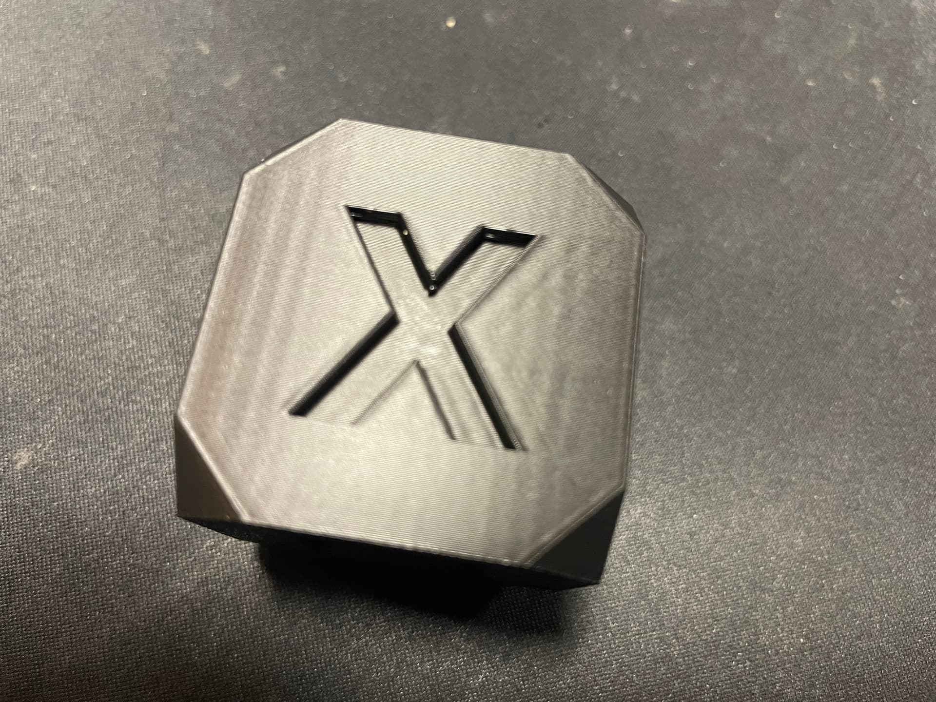

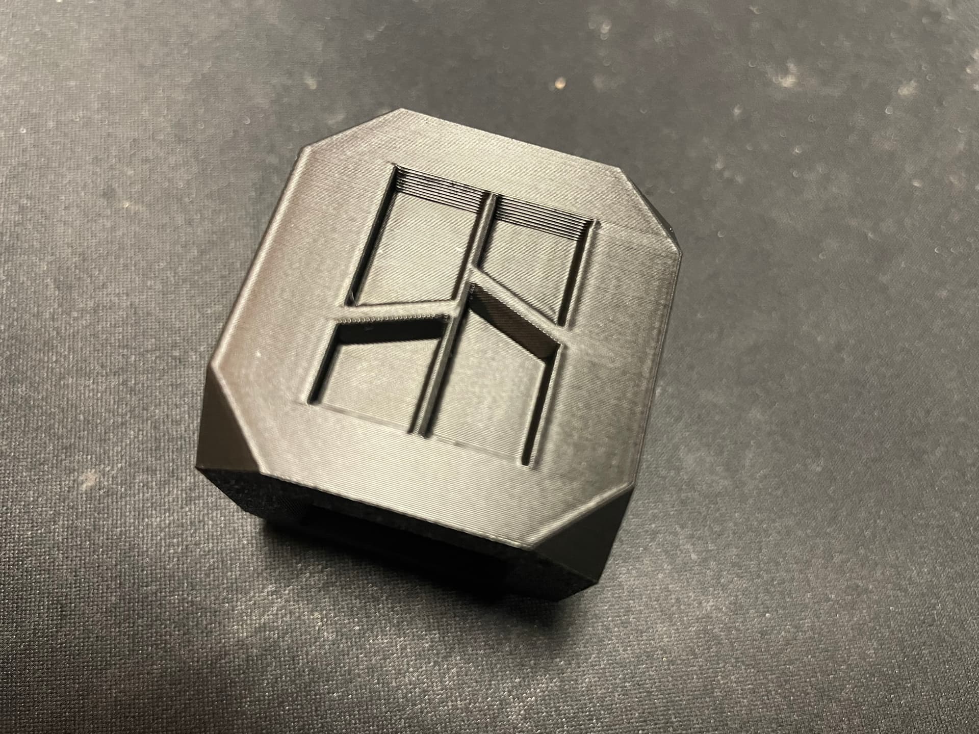

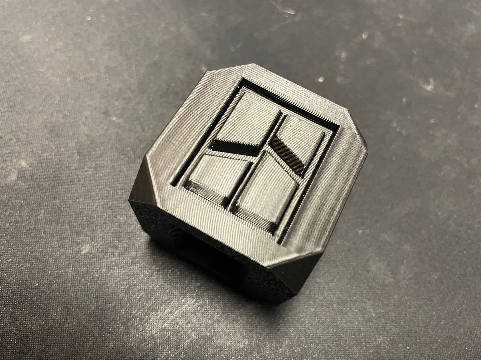

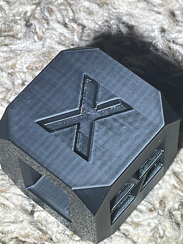

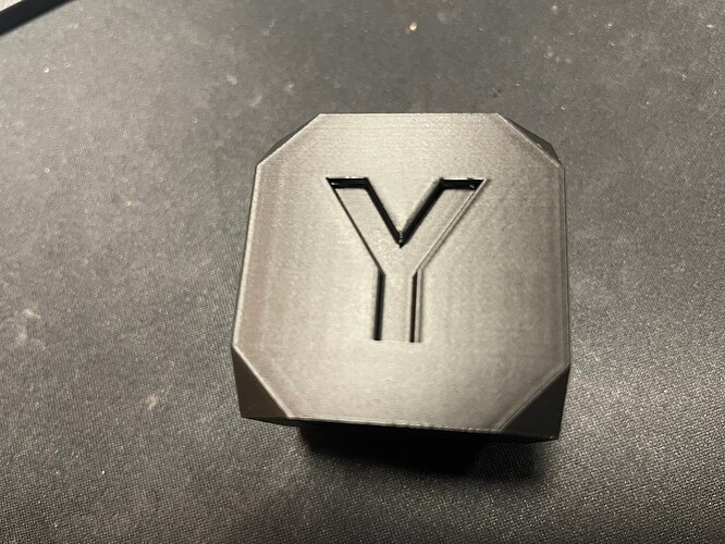

I have put over 350 hours of print time on my P1S since I first got it. The other day however, I began to notice issues in ringing/banding/ghosting/VFAs (I know it has a lot of names). I’ve been messing around with different things because as far as I’m aware there’s not a whole lot I can do hardware wise. I’ve already re-tightened the belts at least 10 times and I used some IPA wipes to clean off the carbon rods, then re-ran calibrations after that and every other time I tightened the belts.
I contacted Bambu support. As of now, it’s a bit early to say much, but they provided me a test print to do with one of their profiles. It revealed that ringing on the Y-Axis was almost non-prevalent; instead, the ringing/VFAs were most noticeable on the X-Axis. This is nice to know but also not, because I really don’t know what to do from here.
Most other threads on Reddit/this forum that I’ve seen about this issue all have various answers, with some suggesting it’s impossible to fix, others suggesting it’s a speed issue, and others suggesting it can be fixed by changing the idlers to teethed idler
So, what should I do? Attached are images. Any help would be nice.

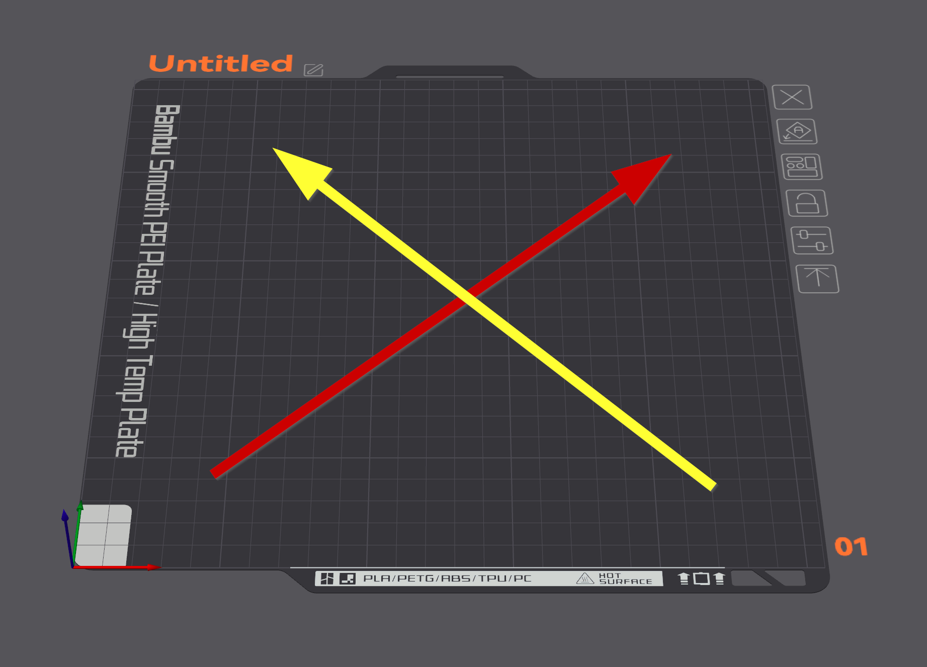

The movement of each belt/stepper motor combination actually only moves the print head in a 45 degree direction. To prove this to yourself, power off the printer so that you don’t damage the machine when you do the next part. Move the head with your hand in a 45 degree direction and witness which belt moves. What you will see is that only one belt moves.
So this would suggest that the problem is not likely mechanical in nature but somehow related to the firmware or control logic of the board.
I’m sorry that’s not an answer or remedy but what you might try is to experiment with orienting the cube 45 degrees and seeing what change occurs. Then feedback that data to Bambu lab and ask them to comment.

I tried the last part of your response about downgrading both slider and printer firmware, and unfortunately yielded no differences in results. I will try rotating the object and post the results here. But I’m a bit concerned thus far.
I would be concerned too. I must confess, I do enjoy a good problem to solve, especially when I can remain objective. Although it sucks for the individual experiencing the problem, I derive new knowledge when a problem is solved, whether by me or the community here. But this one is truly baffling. Based on everything I know about how the machine’s mechanics and logic function, I can’t think of any way this could occur. The truth is, without that photo, if this were just a text post, I’d be questioning the poster. But there we have it: your indisputable photographic evidence. :man_shrugging:
With the revision levels ruled out, I am looking forward to seeing how the problem can manifest itself with the 45 degree print. Will it show on both side or just one?

  1. What does the opposite side look on the X side? Does it have the same ringing?
  2. Have you attempted this with a simple cube primitive? I ask because although you said it does show ringing, it would be interested to see how pronounced that ringing is on a smooth surface. It shouldn’t make a difference but is it as obvious on a smooth surface as one with a feature?

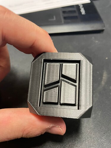

Thanks for the replies.
Keep in mind, in the images attached to this reply, the cube on the left was printed at a 45 degree angle, and the cube on the right was printed normally. The only exception is the primitive cube.
Interestingly, printing at 45 degrees seems to add a tiny bit of ringing to the Y-Axis that wasn’t there previously.
The primitive shape seems to match what I’m seeing in the calibration cube, with larger amounts of ringing in the X-Axis than the Y-Axis.
I’m completely lost now lol

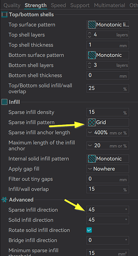

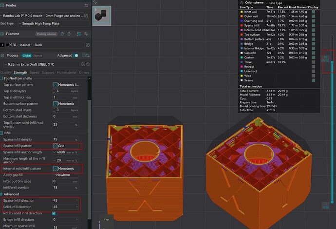

It just occurred to me. We never did check the infill direction. If this is infill related, one would see these sort of phenomena.
Let me illustrate. If we take two cubes and rotate one at 45°, the lines of the infill do not change their orientation.
Can you upload a screengrab of the sliced file along with the strength tab. These are the parameters that are most interesting as well as a cross section of the slice.
You could also manually manipulate the infill angle to an odd angle like 17°. Anything that is not along a 30°, 60° or 90°. What we are looking for is changes in the ringing.
The theory I’m trying to test out, however unlikely, is this even ringing at all but perhaps rather an influence by internal structures.
I think you’re enjoying problem solving a bit too much :laughing:
Actually invested in this :smiley:
Unfortunately, this didn’t work for me. Sure enough, my infill did look exactly like yours. I changed/messed around with the infill angle, percentage, and type (I tried gyroid and lightning as well). Unfortunately, nothing I tried made a change or any positive impact on the outcome of the model.
I won’t share any additional images because they came out pretty much the exact same as previous set of cube images I shared.

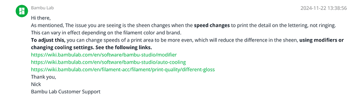

Any other ideas? Bambu support is telling me it’s normal.
That is NOT normal no matter what Bambu is telling you. The fact that it’s happening in one axis and not the other is telling and baffling at the same time. The only other remedy I can think of is increase the wall thickness and slow down the print speed for the outer wall. Outside of that, I’m out of ideas. Did you say this does this with all filaments?

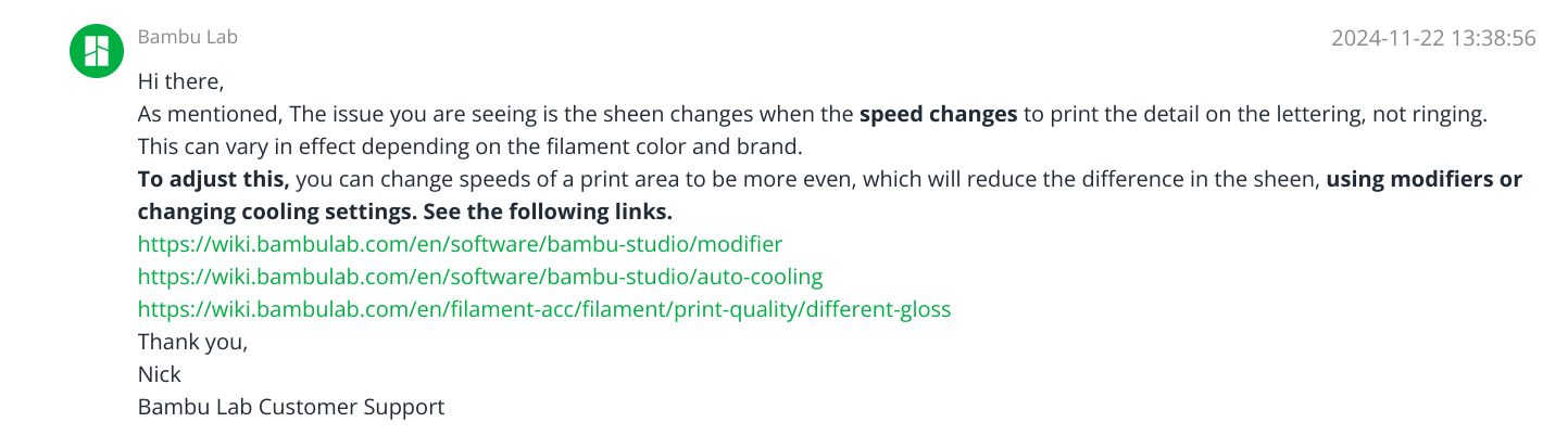

Adding on to this- here is what Bambu has told me.
