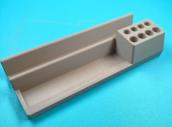

  2. Your model pictures, especially in the web view, are very “artsy” - less focused on the actual object. The pen holder is a good example, I would want to see actual details of how it actually holds pens. Ditto your watercolor storage solution. The app pictures are better.

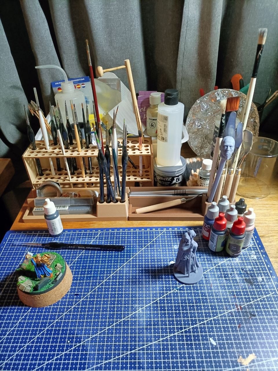

Man that turned out great! Thanks for sharing the photo :+1:
