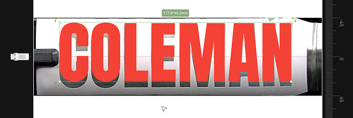

Currently the laser processing on the rotary attachment is etching incorrectly based on the design and placement within the machine. It’s doing this with text and images. It isn’t egregious, but does make tracing over a previously lazered area impossible.

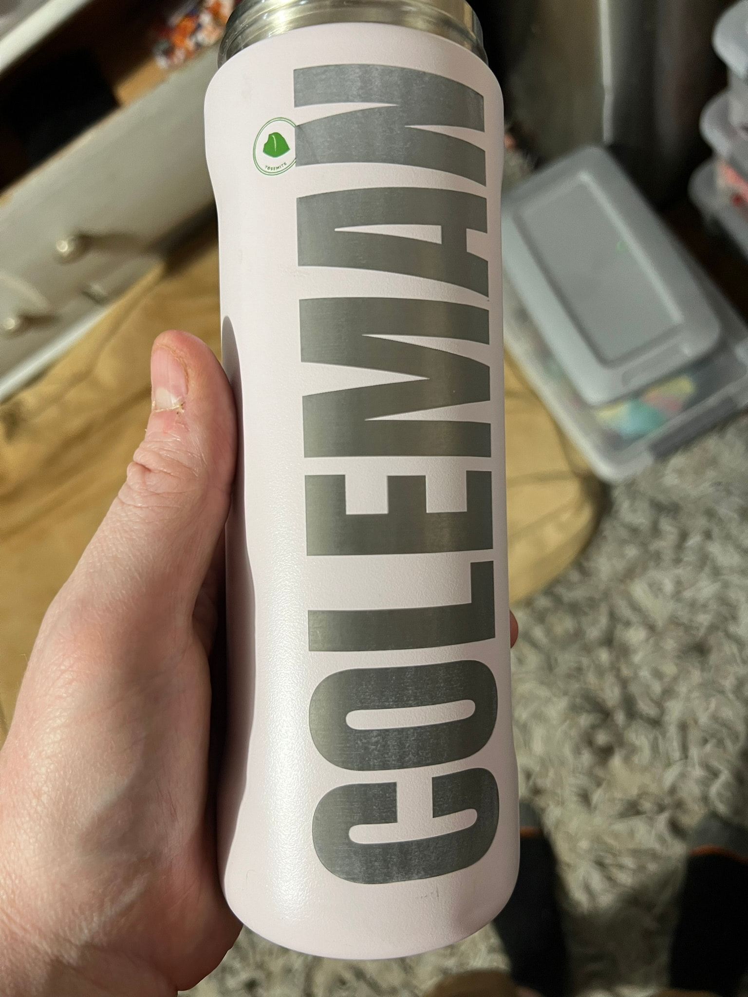

As you can see from this photo, the results do NOT match the design put in place.

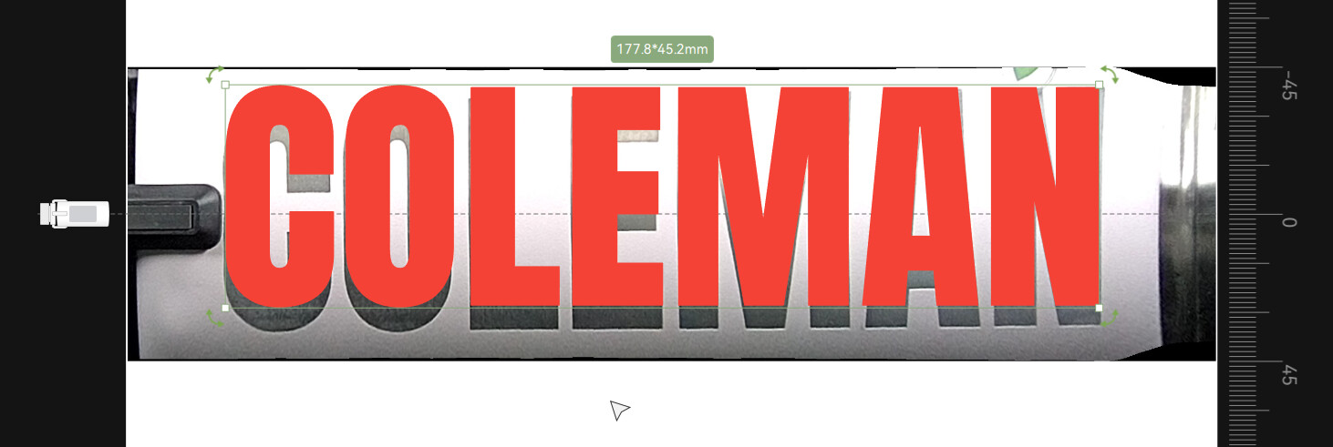

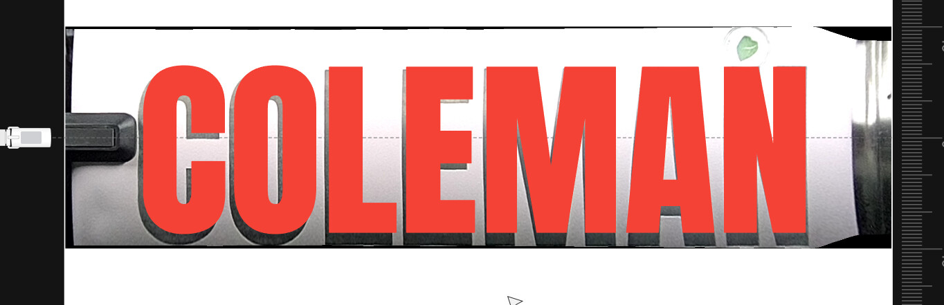

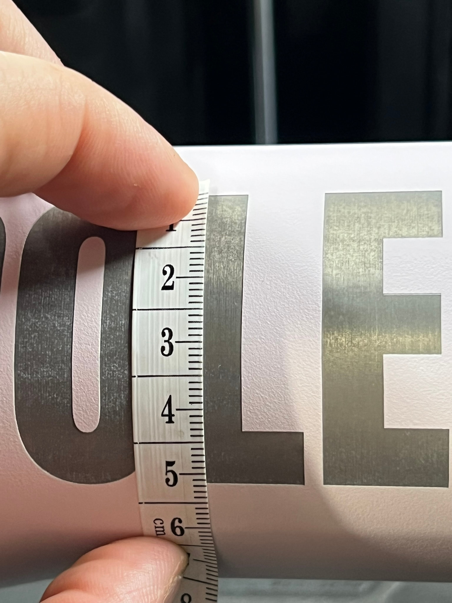

This text design is taller by about 1mm from my measurements, and I am unable to line it up in Studio, even moving it around and re-taking pictures. This etch failed on the far right letters and I need to etch it again, but I don’t think I can without true accuracy.
My thought is both the picture taking / display is a bit off, and the actual laser process, since it’s measurements do not line up with what I expect. I’ve also seen stretching on some images, especially the further around the bottle it goes.
I’ve got an H2D with an upgrade kit for the 10W laser. I’m lasering at 42% power, 190mm/s, 3 passes, with dual scanning on.
The only option I’ve seen to really increase quality is the cross scanning, but that takes about 10x the time and isn’t a viable option for larger laser projects. Anyone seen or dealt with this problem?

A photo of the engraving results. I’ve had these issues where the further out from the center you laser, the worse the results get. As you can see the LEM are all perfect, but all the outside letters contain residue. I now believe this is related to the photo taking / processing, as Bambu Studio doesn’t accurately get the outside edges of bigger laser files.
I don’t know why, but consistently the outer edges of every laser project I do with the rotary attachment has these results.
Does increasing laser power/slowing the speed help the edge texturing? It is entirely possible the coating is thicker on the edges. Additionally, the 1mm drift seems within what i would expect with a unit like this.
While the set up is not cheap, bear in mind it is not a dedicated laser much less one fine tuned for cylindrical objects. If you are selling lasered pieces off this machine plan on having at least one sacrificial piece to build your calibrations.

My initial conclusion a few months ago was that the coating was thicker around the edges. This is possible, and I’ll run some tests on this bottle to see if that could be there case.
A 1mm drift is acceptable? I’m new to using laser’s, but in the 3D printing realm a 1mm drift would be totally unacceptable. This machine is certainly capable of being extremely precise, which I expect it to be.

The 1mm drift is more of a calibration thing then a mechanical one. The machine could be extremely accurate, but I would expect a couple tries and making adjustments to get there.
