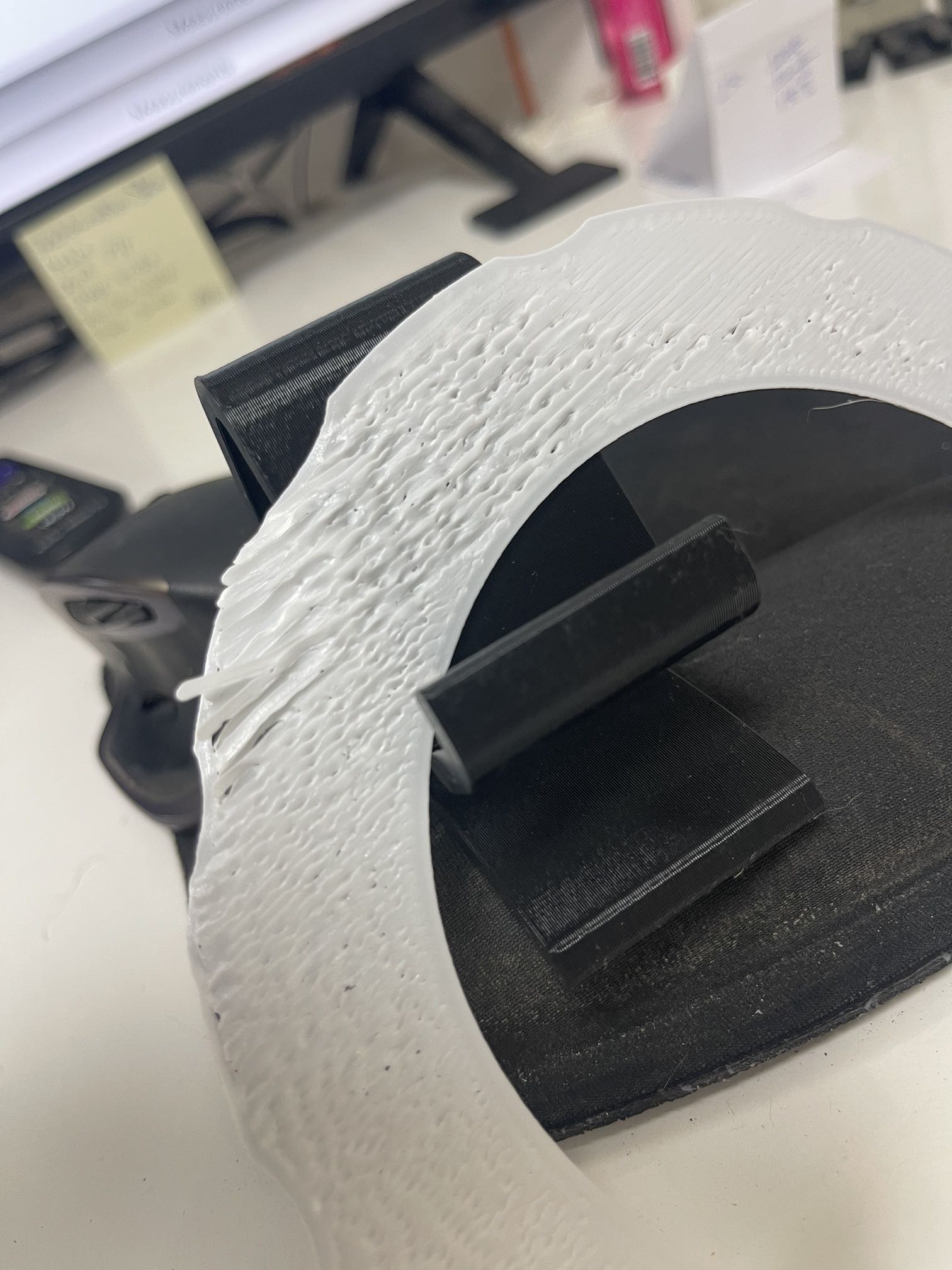

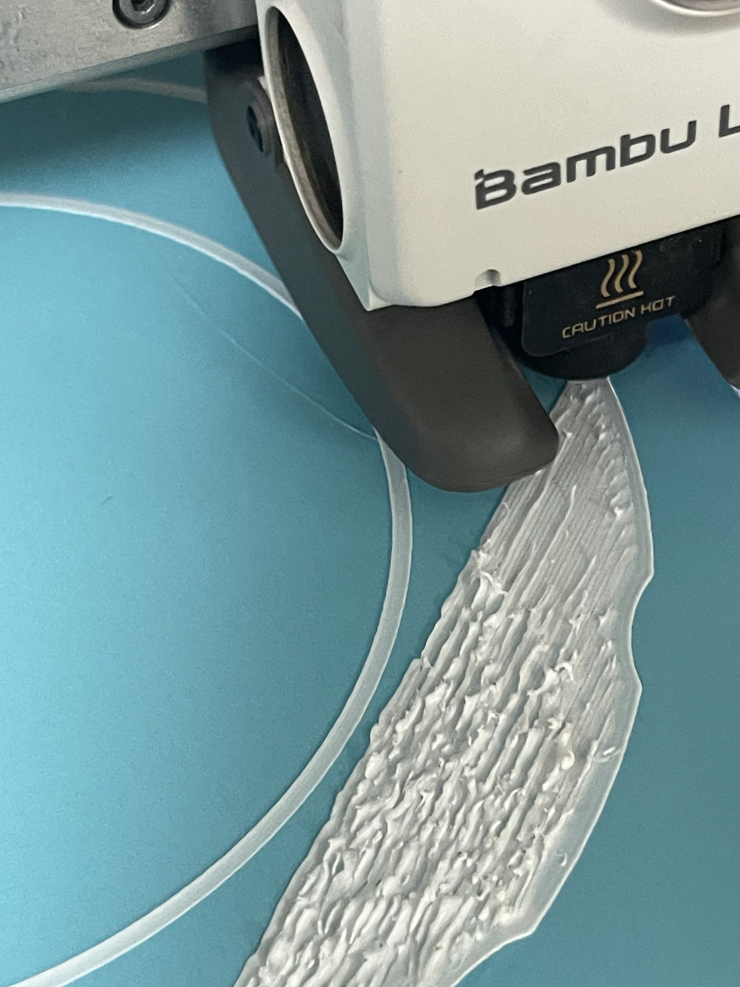

Rough 1st layer
*ive been getting this rough surface on my A 1 mini, changed filament, dried filament did calibration test still the same, I’ll add pictures
Is it limited to one side of the plate? Any chance there are some debris under the plate? Have you been letting it do the bed levelling?
I’d check the head clips first and make sure it is seated properly and if it is OK check the screw tightness in the head.
Rough surfaces on the A1 mini can sometimes be caused by flow rate or nozzle issues rather than just the filament. Even if calibration looks fine, I’d recommend doing a flow rate calibration in OrcaSlicer and trying a slightly lower flow to see if it helps. Also check the nozzle closely—if it’s a bit worn or partially clogged, that can create rough texture on prints. Another thing to check is your Z-offset; if it’s too close, the layers can get squished and look uneven. Once you share the pictures and print settings, it’ll be easier to narrow it down.
It’s wet.
