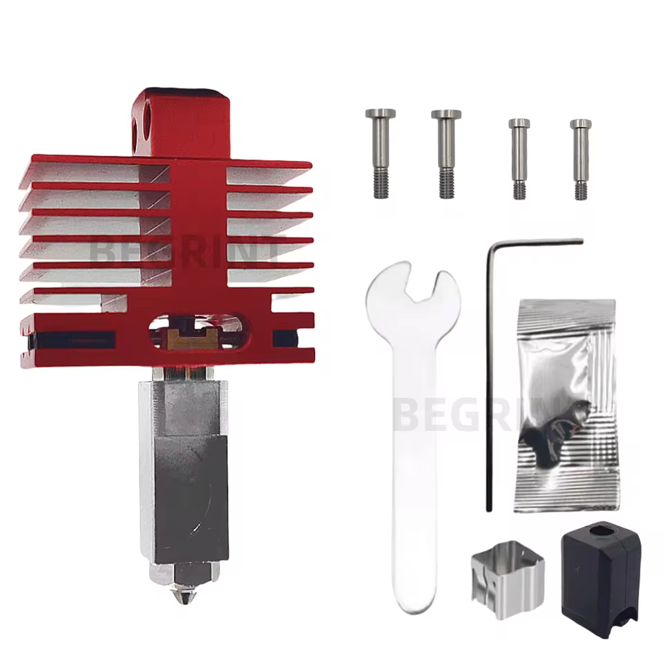

Another Unofficial option are these AliExpress nozzles.
Cant get the link to work, but a search for P1S or X1C nozzles will find them.
I am not that versed in these, so I can’t swear they will accept a Diamondback. I think this thread contains info from users of this nozzle.
I haven’t been so impressed by these, but to each their own.
