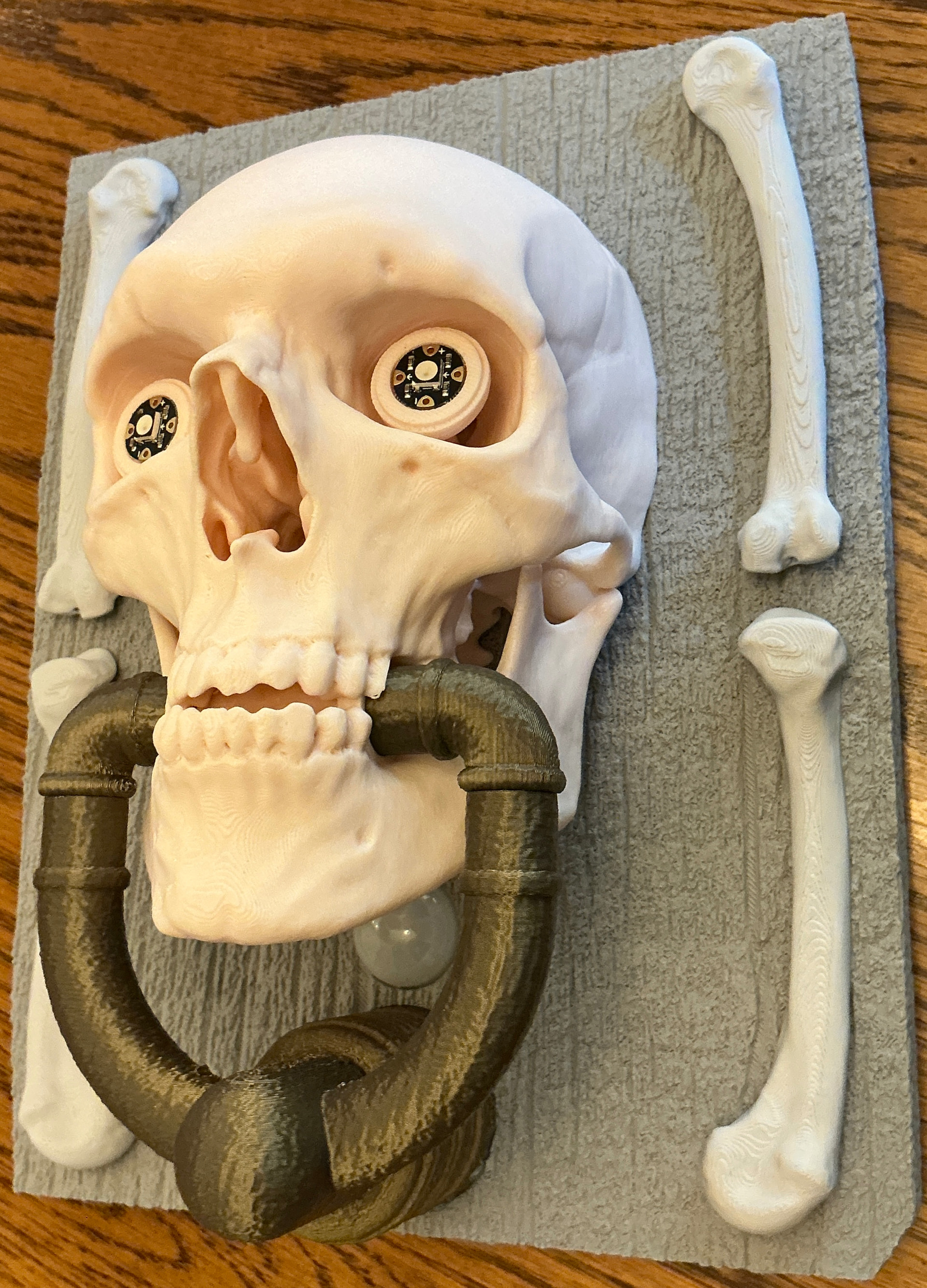

I use Fusion and it is one that lets you edit mesh surfaces like that. I applied a wood grain texture to the back plate and a hammertone-like texture to the knocker parts. It can really make a model pop but can also blow up the size of the model files.
