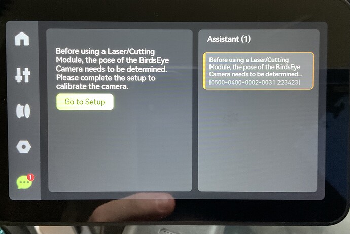

Just got my cutter module for my H2D and installed the Birds Eye camera, but when I install the cutter module I get an error on the printer about Birds Eye not calibrated, but when I look at the error, safety key is installed, printer won’t turn on otherwise :grin:
See pics from printer
If I were you I would disconnect the camera. Cutting module can work without it but if the H2D recognizes the camera as installed it may bring it to confusion and ask for calibration which you cannot do yet without the laser module.
Disconnect the camera and re-test
The emergency stop button must be mounted on the right side of the printer in its designated location; otherwise, the machine will not operate. A Hall sensor is built into that position, and the Safety Key must be inserted in the emergency button itself — not in the back of the printer — when using the cutter platform.
Are you sure the emergency button is required when using the cutting module upgrade on a non-laser H2D? Bambu does not list the emergency button in the kit and does not mention it as being required.
I think the warning is due to the BE camera installed with an improper firmware (yet).
In this case, it’s most likely because the system detects the Birds Eye Camera and assumes a Laser Module should also be present. For printing or cutting, the Emergency Stop Button is (or at least should be) optional.

Must be firmware lagging behind then.
Thanks all for the feedback, I’ll try disconnecting the Birds Eye camera and re-test, did not think of that.
Just disconnect Birds Eye camera and yes it cuts, and just to make it more fun, Bambu suite says just before you make that having the Birds Eye camera installed will make it easier to identify and align cuts…
Per the cutting module product page:
" The H2D Cutting Upgrade Kit contains all items required for cutting and drawing.
When paired with the H2D, the Birds Eye Camera requires the Laser Module for calibration. Without it, the camera cannot function with the Cutting Upgrade Kit for photo capture. Support for calibration without the Laser Module will be added in a future firmware update."
This was updated a few days ago. The cutting module still works, just no birds eye view. There is no need to disconnect the camera.
