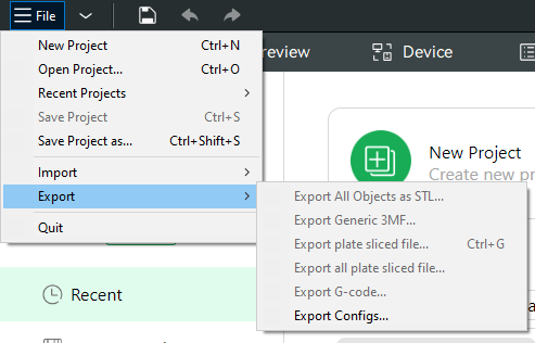

Also, it’s not automatic but you can export the gcode to a folder using the file menu:

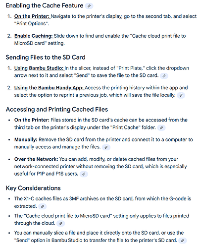

Have you looked at the contents of your SD card? The root directory should show *.gcode.3mf files sent in LAN-only mode (not sure about cloud mode, I do not use it). If you have enabled caching, files sent via cloud should be in the cache folder of the card.
AI: response to search for bambu sd card cache:
You can use FTP access to simplify file management and recovery of cache files from your computer without removing the card.
