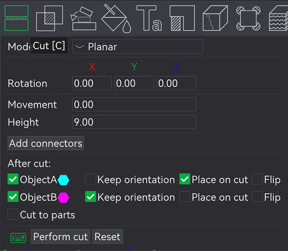

Scaling only a portion of a part using Bambu Studio
Is there a method or technique to scale only a portion of a model part in Bambu Studio?
Often enough, I would like to scale a part, often only along a single axis. But, I end up also scaling some significant connecting element which throws off its size. I would like to be able to scale only part of a part, if possible, I’m spitballing, using modifiers or something else.
Thanks.
If the creator intended it that way and the parts are listed as individual objects, then yes: Right-click on your assembly group and select “split to objects”.
If that isn’t an option, you’ll have to manually cut the object into different parts. There are various options; the simplest one is:
It would also be a good idea to check whether the designer has provided the CAD files. If you’re lucky, there are more possibilities.
Cutting the part. That seems like it will do the trick. Thank you for that one.
