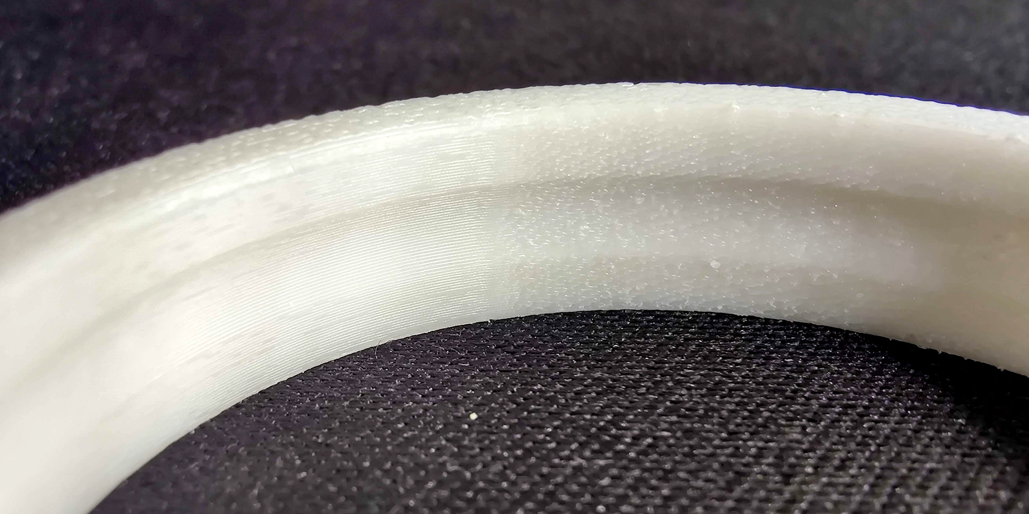

To me they look identical. Like scarf did not apply on the top one. It may be difficult to see with the forum’s aggressive image compression but the outside of the ring in my first picture has a fuzzy texture on the right side of the scarf joint. (It’s not the fuzzy skin setting though). The same defects are visible in the video. This defect is not present on the inside of the ring. I would expect the same defects even if the scarf seam was bad.

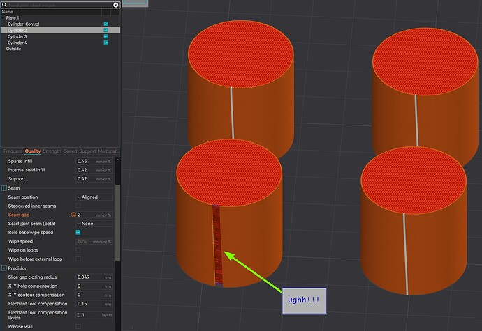

Second, try modifying the seam gap. Here’s a way to do it without wasting too much time and filament. The goal is to try to create a sweet spot where the parameter creates the least gap. Once you have the minimal gap, then turn on scarf joints.
  1. Create four or more cylinder primitives. Leave the gap on one of them alone to act as a control by which other others can be compared to.
  2. In the Object/Quality menu, change the seam gap by some ±5% or 0.1mm gap. You’ll have to experiment. Chose a different upper and lower value for each experiment. Then slice and print. I suggest you mark the samples so you won’t lose track of what you did.
Here’s an example with an exaggerated value of 2mm. Obviously this won’t work but it illustrates what you’re looking for.

Yep, that was it. “and hole” means surfaces facing inwards.
Now I need to reduce the rough texture this resulted in. I suppose it’s a matter of playing around with settings.
