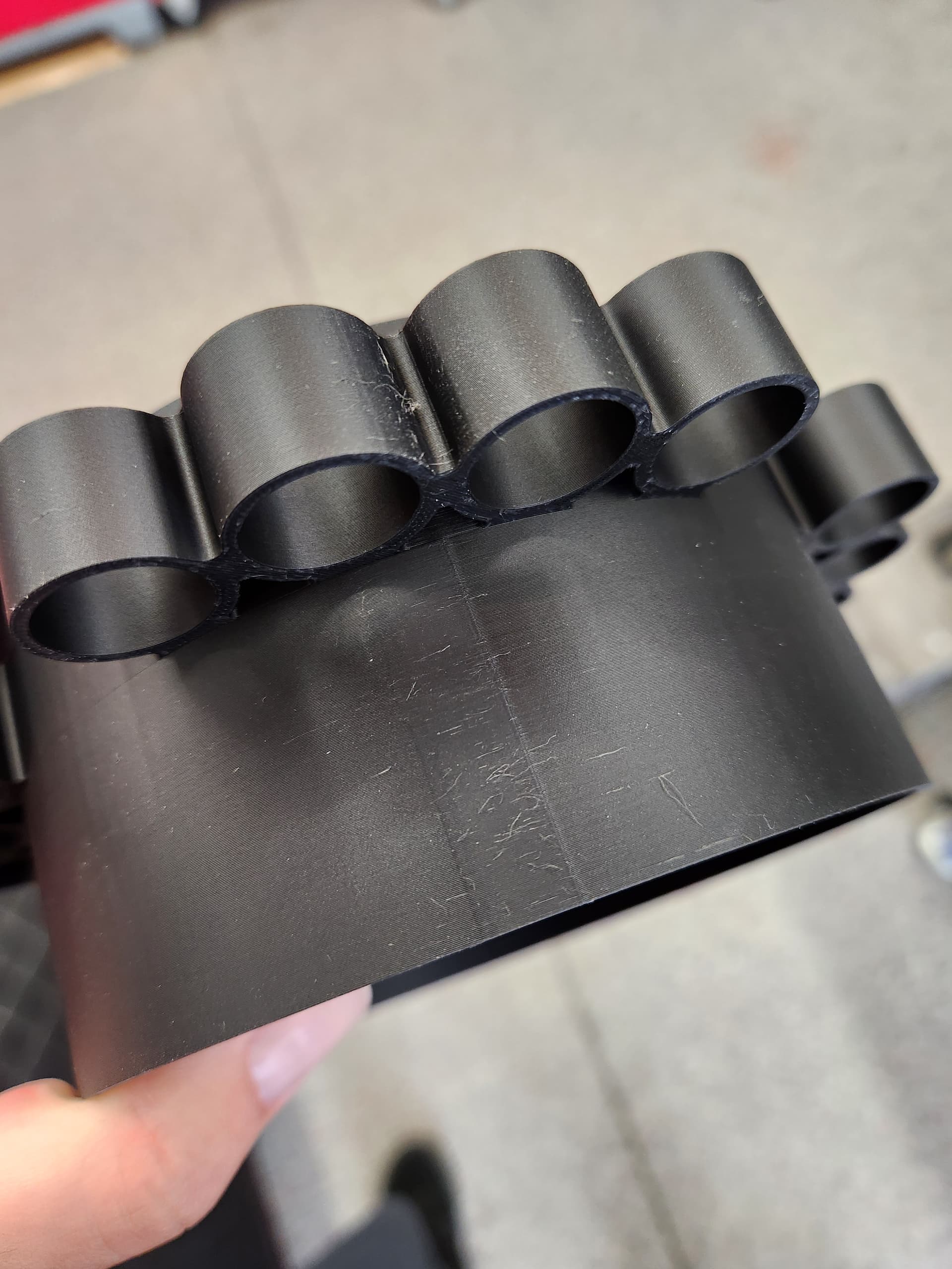

I am having issues with my scarf seam causing stringing on a P1S with bambu matt black PLA. I’ve tried lowering my printing temp to 220 and lowering the outer wall acceleration speed, both have not helped. The filament is flow rate calibrated. I was thinking about adjusting the scarf start high, but I’m not really sure what that does. Any help on what settings to try would be great.

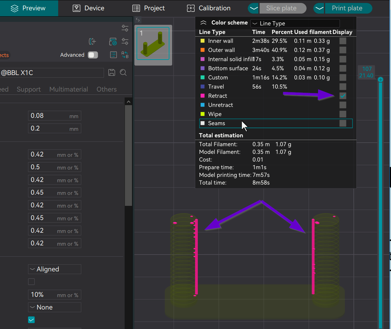

Another analysis you may want to try is to uncheck all of the line types except for retract and see if the locations of the retraction in the preview aligns with the locations of the stringing in your physical model. If it doesn’t, it’s another issue.

I did end up figuring out the issue. I had seam position set to “back”, when changing to “aligned” it solved the stringing problem. I’m assuming this has something to do with the scarf seam location being set to the same spot on the inner and outer walls with seam position set to “back” vs with the seam set to “aligned” the seam on inner/outer walls are in different locations.
New problem though, its now putting the seam in a very obvious spot on the outside. Using the seam painting feature moves both the inner and outer seam to the same location, which causes the stringing to happen again. I don’t care where the inner wall seam is at, only the outer. Is there a way to control the seam position independently from the inner/outer wall?

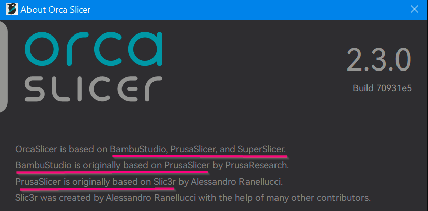

If you’re new to this ecosystem but not necessarily new to 3D printing, it may help to understand the pedigree of these slicers. I won’t go all the way back to the beginning of the RepRap DIY era and the granddaddy of open source slicers, SLIC3R but know that PrusaSlicer is based on it and Bambu Studio is a fork of both PrusaSlicer and SuperSlicer.
