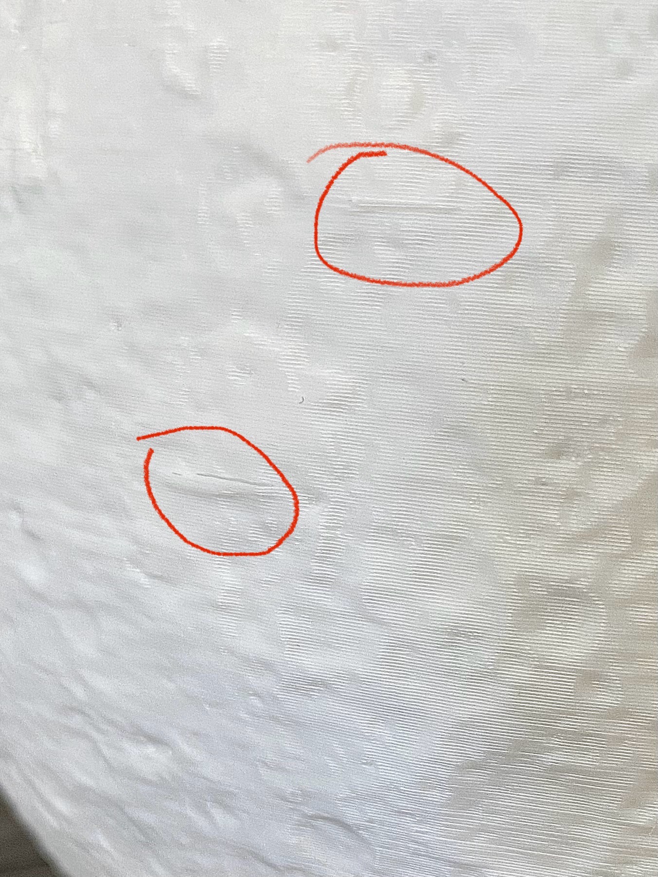

Scaring on surface of print
On the surface of a couple of prints that I have done there has been scar lines. These prints where done using elegoo Pla white at 205 degree nozzle temp which has worked well on other prints but has not worked on others. On the picture below the scaring occurred between the the positive and negative 30 degree mark on the sphere.
You should be printing at 220 which is the standard temp for PLA.
Thank you I will give that a go on my next print
No problem, keep in mind I am not 100% sure that’s why, it may also be an under-extrusion issue so it may be useful to do flow calibration.
