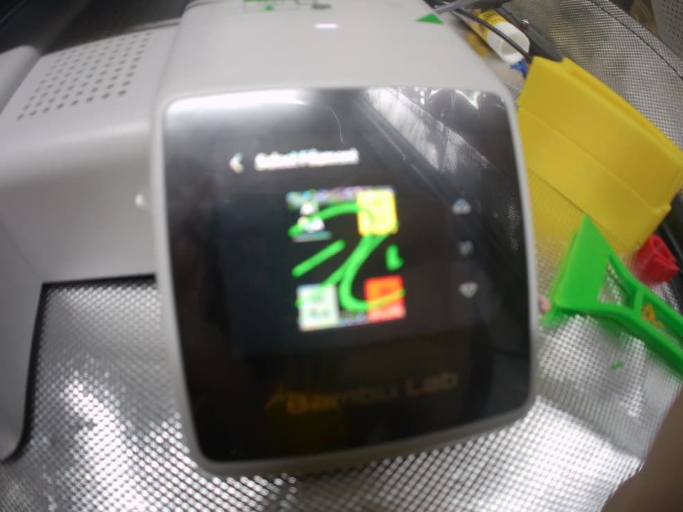

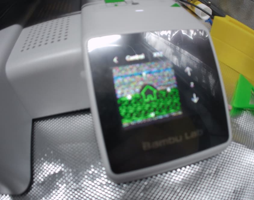

a short while ago i noticed a screen glitch on my a1 mini and my friend said he had the same problem on his a1. i reached out to bambu and after changing the mainboard the glitch disappeared. if you have the same problem, i recommend reaching out to get the replacement piece although it is a bit of a pain to install it and to activate the new sn.
here are pictures of the glitch. sorry if its blurry.
the first one is the xyz page and the 2nd one is the ams page

i have exactly the same pictures in every detail except mine are in focus :wink:
