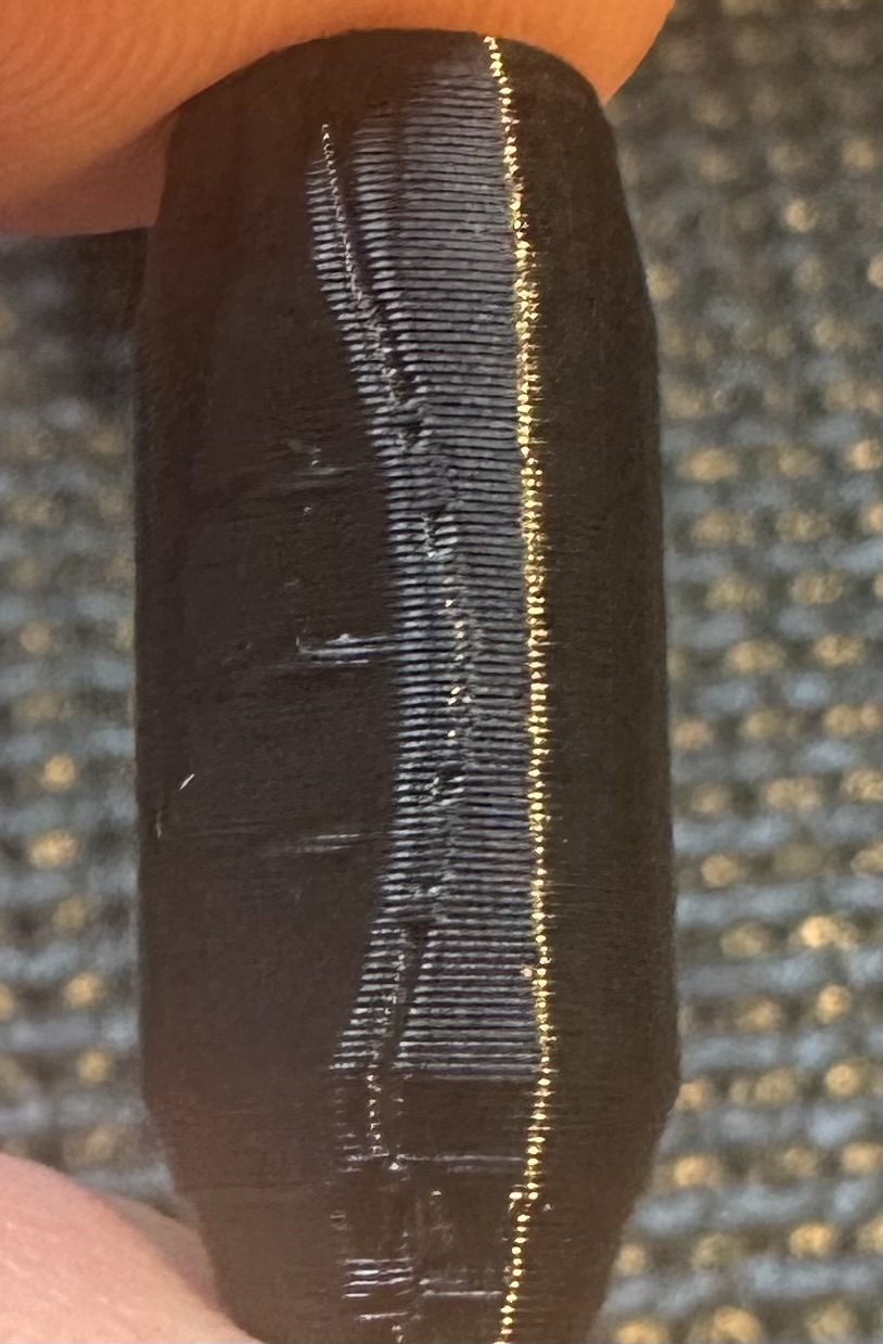

If I print a single part, the quality is acceptable. But if I print a quantity the quality is horrible. I assume this has to do with the acceleration between the parts. I am printing a full plate now with reduced speeds and acceleration to test. But any other ideas?
Looking at closeup it kind of looks like an overhang issue, but other similar parts with less overhang angle suffer similar results.

While that is neat, that isn’t going to work. I can only get 14 of these on a plate and it takes twice as long doing that. I am going to be printing literally 10-20,000 a year.
Slowing the speed and acceleration helped, but it can still be better.

I am having exactly same problem with PLA. If i print only one part it is okay. If i print multiple seams get noticeably ticker and my parts don’t fit together. Always printed multiple and never had this problem.
Same here and I don’t know why.
