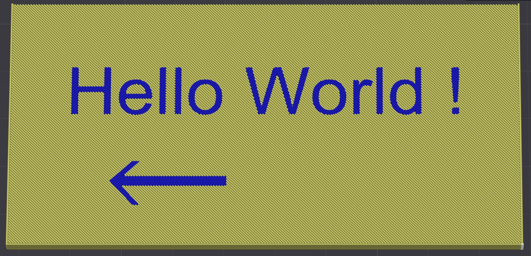

You mean some text and a arrow won’t work like this ?
I must be doing something wrong here then…
Or do you need it more like this ? >

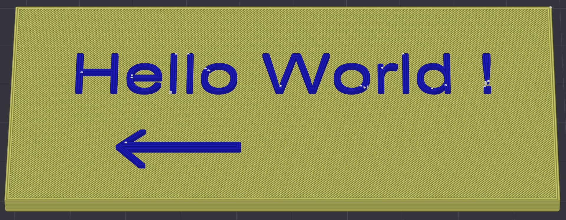

I changed a couple settings from your illustration of my previous example breaking when adding a box on top.
(1st from developer mode)
and this one previously known but I didn’t use:
Now with your added box it seems to work again but it adds wall loops around the perimeter (probably as before also). I don’t like the weird layer layer behavior (NtoN, N-.1toN, N-.1toN+.1 are all different) and why increasing wall loops act this way at all is a mystery. The wall loop increase doesn’t need to be a big number, +1 or +2 seems fine. This method is the easiest to set up.

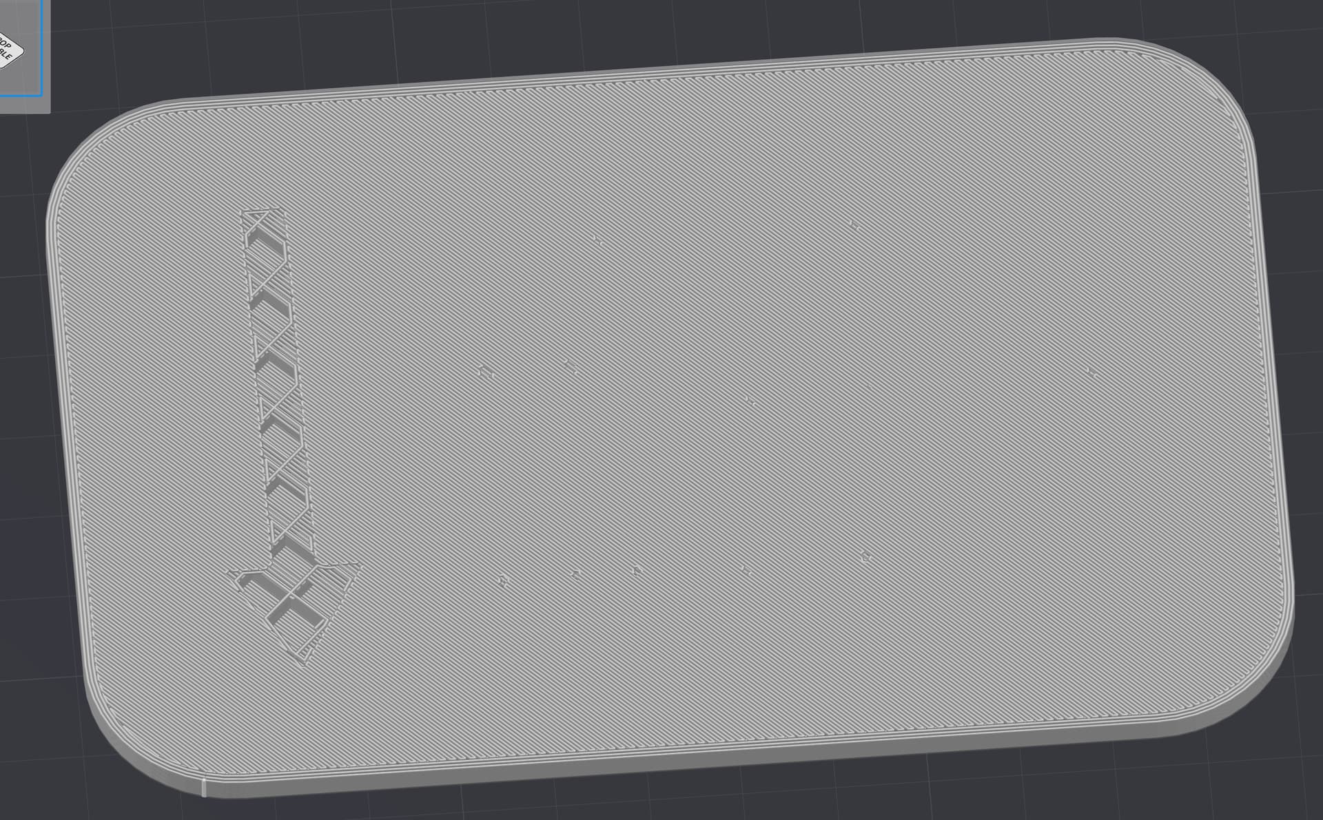

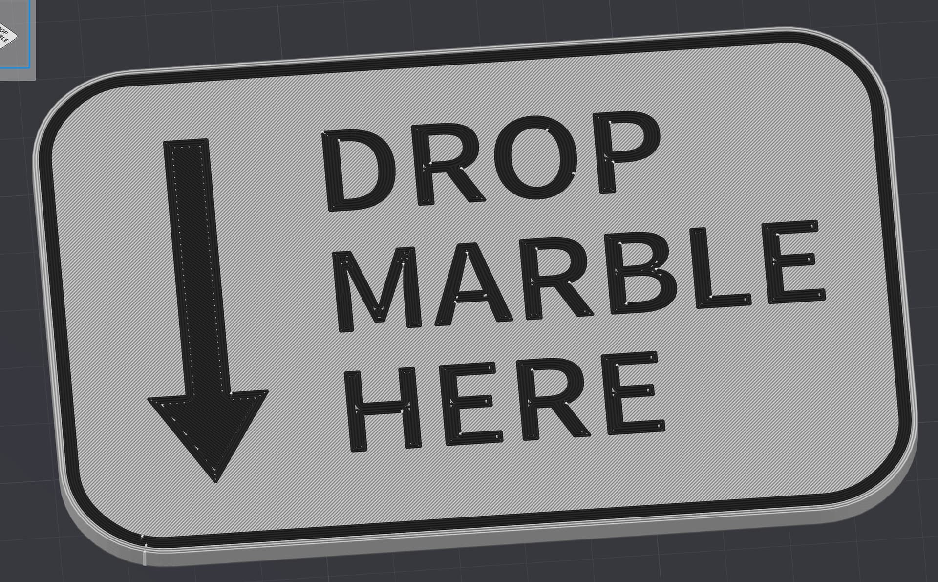

I’m not sure if you’re just reading past what I previously explained, but again I’ll attempt to explain. What matters is the artifacts hidden undeneath the text and arrow, which are not shown in the screengrabs you posted. You have to go down to the topmost layers of the sign background, and see if there are any artifacts on the 2 layers underneath the words or the arrow. If there are artifacts there, then those layers won’t be laid out in one continuous flow with the printhead working from one corner of the sign to the opposite corner. Instead, the printhead will fill in the sign body until it hits an artifact, then work around the artifact, leaving visible pattern differences with shiny filaments. Even though the entire layer is laid down in the same diagonal direction, it is filled in section by section around the artifacts, leaving visible lines that affect the smoothness of the layer above, like this:
Here is an example, from which the slicer layer screenshots below are derived.
Arrow test.3mf (1.3 MB)

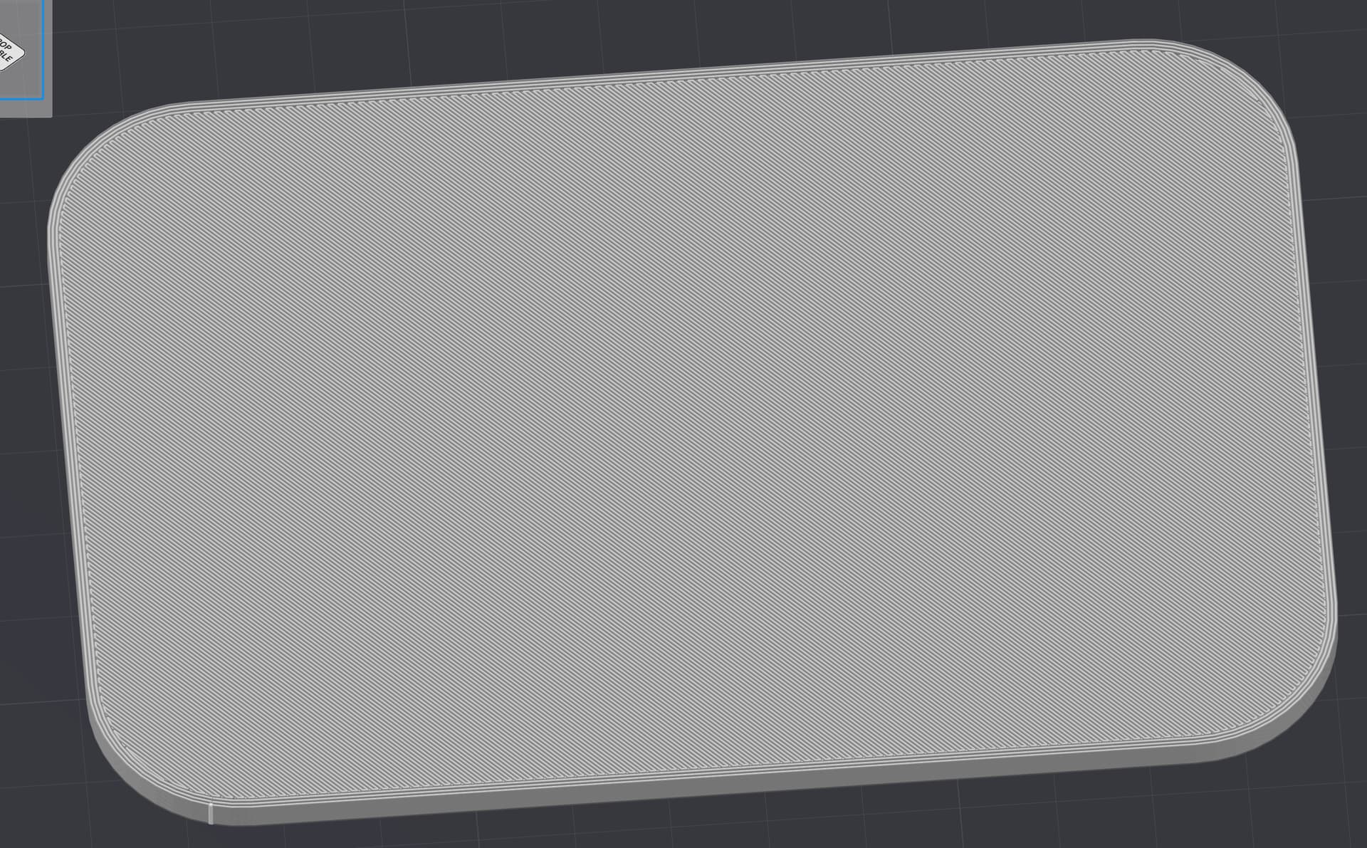

LAYER 17:
LAYER 18:
LAYER 19:

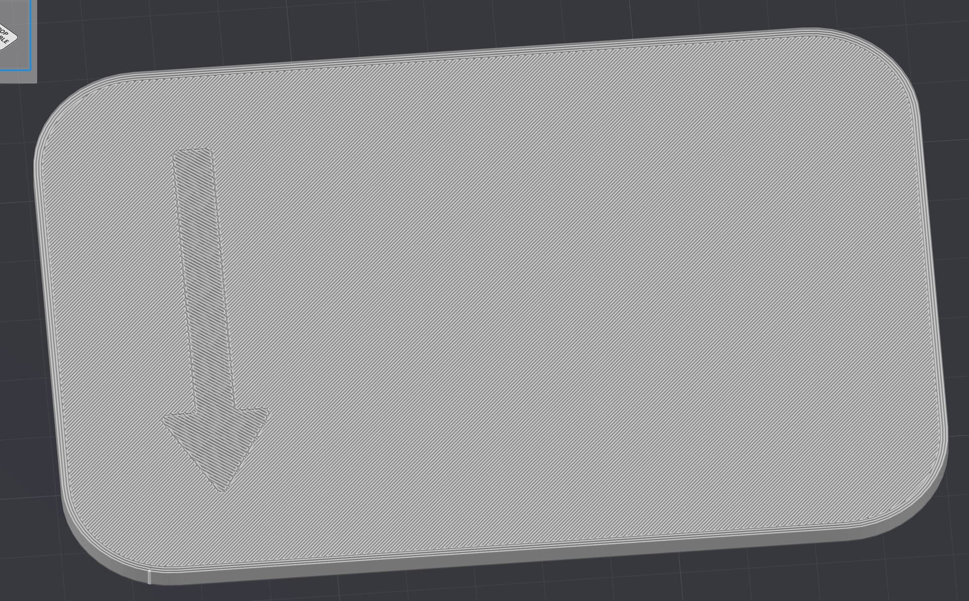

LAYER 20 (the critical layer prior to printing the text):
LAYER 21:
The arrow-shaped artifact on layer 20 (which is hidden undeneath the arrow on layer 21) causes the print head to not lay down layer 20 in one go from corner to corner. The slicer fills in the layer smoothly until it encounters the arrow artifact, then fills in by sections around that artifact. With the glossy silver filament I am using, this creates noticeable lines due to the filament head filling in filament from the opposite direction until that section is complete, with seams meeting in the central portion of the sign, rather than working from one corner of the sign to the other.

I am interested in seeing the head movement in layer 20. Just looking at the completed layer as per your image, it looks like the lines are smooth and unbroken. Maybe a picture from partway through the layer would show how’s the lines around the arrow are being broken up
Download the arrowtest .3mf file in my post above with all the screenshots. It’s after the first picture. Slice it and trace the toolhead movement on a layer with the separte arrow-shaped filled-in area.
This worked for me. Setting ‘Only one wall on top surfaces’ to ‘Not defined’ results in layers 19 and 20 both being sliced as full-layer monotonic lines, which is what you are looking for I think.
