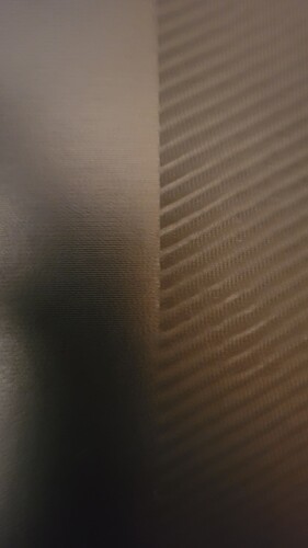

Any idea?first layer perfect, my second + layers have bad finish, i did all the calibrations ( + flow calibration and pressure) and still same issue , bambu basic black pla
It doing that when it get towards center
Door close
Rise mod
Using ams
Second + layer was 200 speed but dropping down to silent mode didn’t make much difference, .4 nozzle , .08 layer hight
Flow rate .98 pressure .015
could you give a little more detail on this? or maybe a second image from a different angle?
This looks very strange, almost as if you have some kind of pattern.

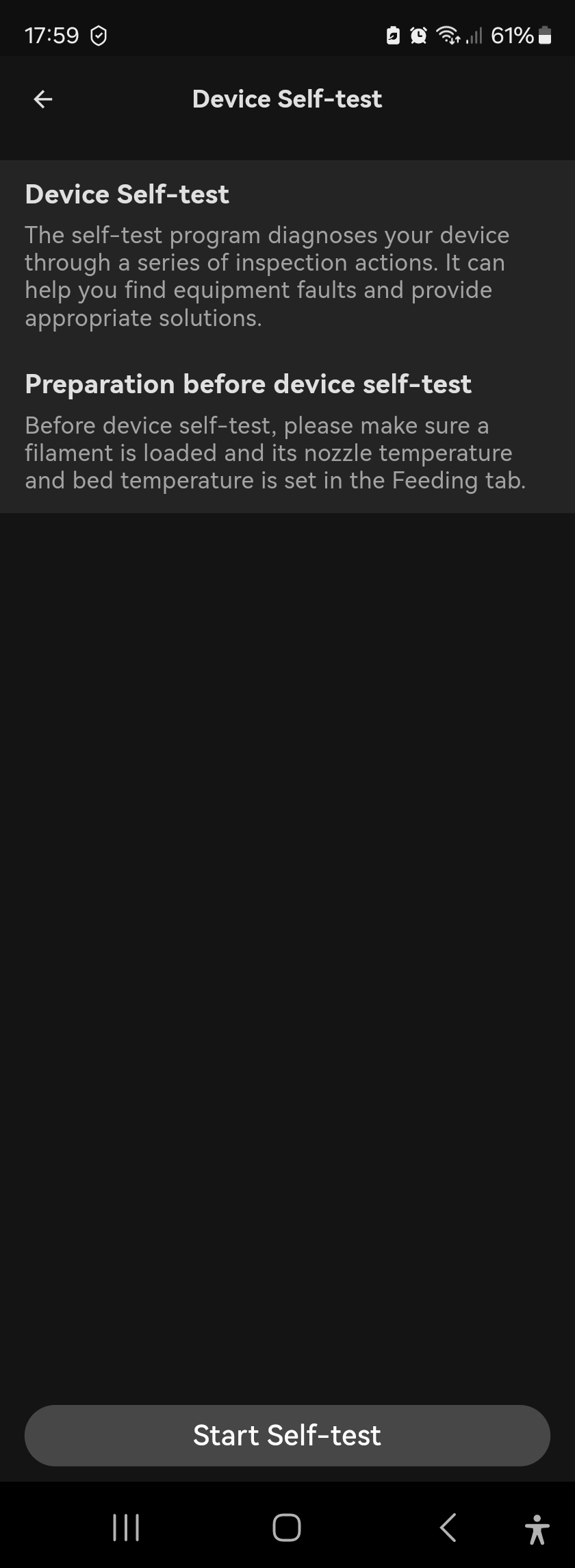

All sorted it,ive only did that self check or something
Ive run it with white filament and it was perfect then with same black one as before and same it end up perfect , I’m a bit confused about that but it works so I’m happy

Just go to you bambu handy app and go to machine assistant and choose that self check option, and try again , that what i did end of the day and it works since
