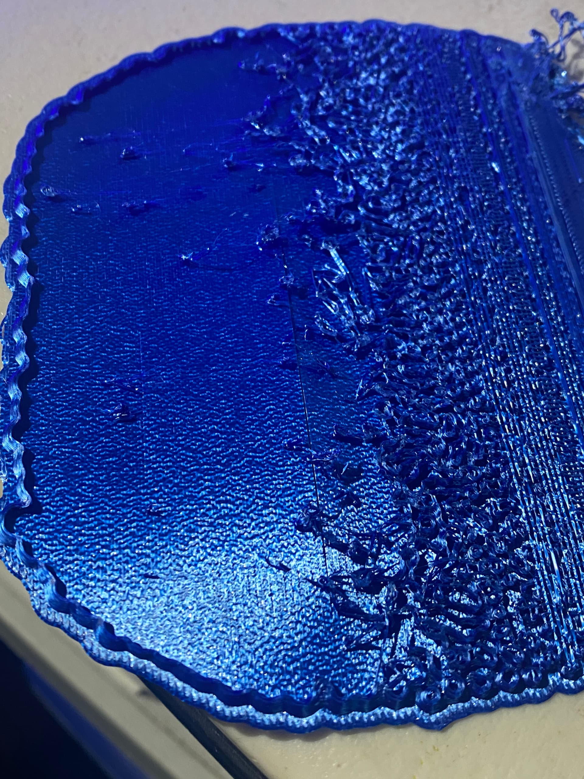

Second layer print not a smooth print

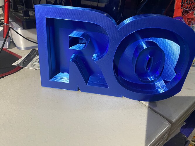

Hello all When I am Printing out letters I created from fusion, the first layer will print out great, the second layer will start messing up not smooth tiny circles or squiggles.the first print is fine the second print is my trouble print.I am cutting and slicing in bambu studio,the first print is good then the second print comes out like this the third is what I am going for.can someone help me please.. thanks.
First let’s start with what type and brand of filament you’re using? The second layer prints a fair bit faster than the first and filament that isn’t “high flow” will exhibit issues like you are seeing. If you print the model in silent mode does the print look better?
