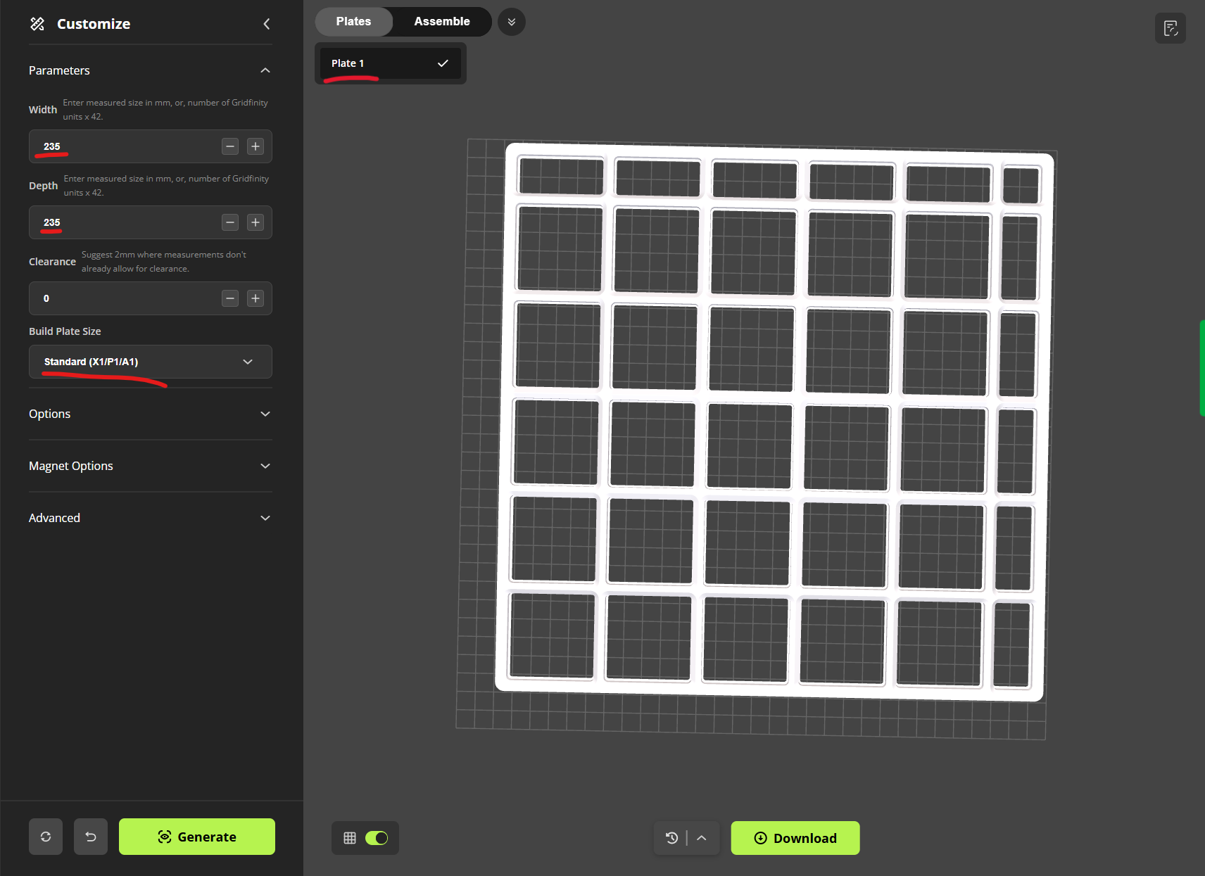

There are a couple of issues with the recent changes to the Parametric Model Maker which adds selection of the Bambu printer.
Issue 1: The prompt for printer selection should come after selecting .3MF export. It doesn’t make sense to select the printer for .STL export, and is all a bit confusing if you were after a generic STL file.
Issue 2.: When object auto-arrangement is disabled, the positioning for H2D and A1 Mini is done in a problematic way, inconsistent with the default X1/P1/A1 positioning.
I will just use my model to demonstrate. It uses the 3MF version of the customizer. I underlined changes from default settings in red. GRIPS: GRidfinity Interlocking basePlate System by TooManyThings MakerWorld: Download Free 3D Models

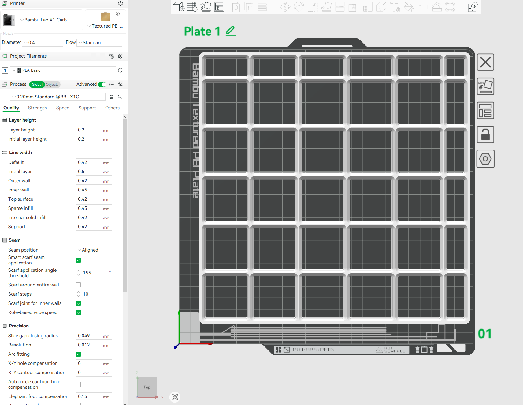

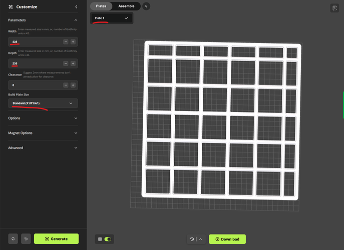

For X1C for example, everything works great. The script intentionally positioned the model slightly off center to avoid the printer’s exclusion zones. When loading the exported 3MF into Bambu Studio, the positioning matches.

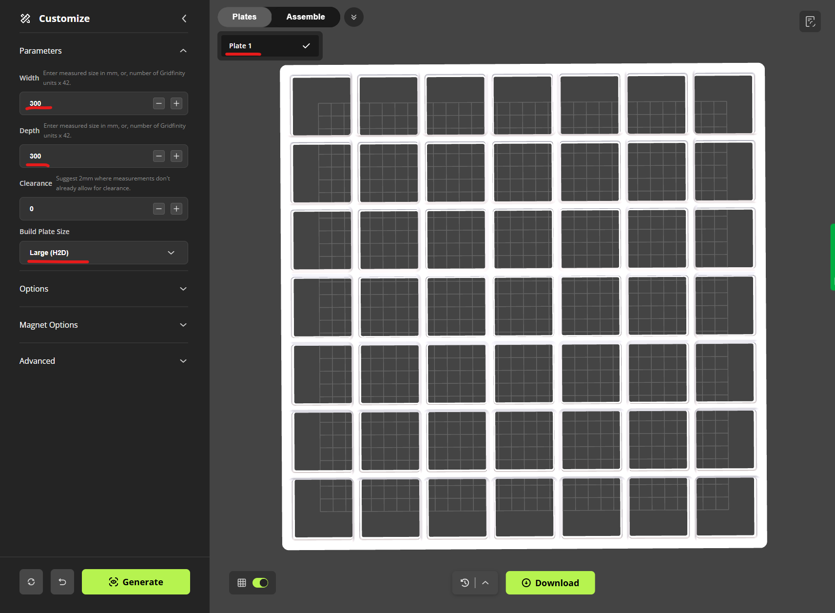

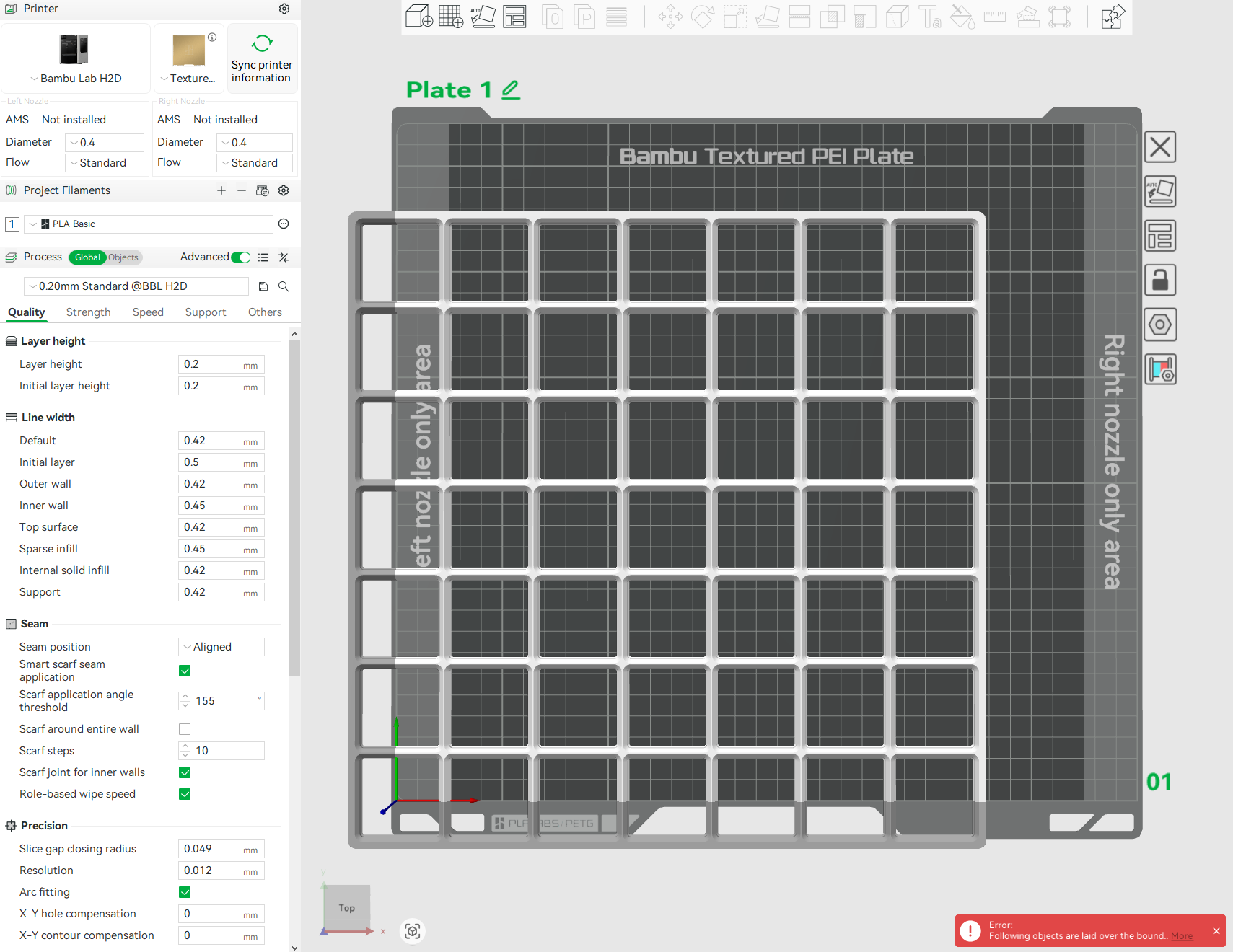

For H2D, it does not work the same. I center the model in the Parametric Model Maker and then when loading the 3MF into the Bambu Studio, it is offset, and off the plate.

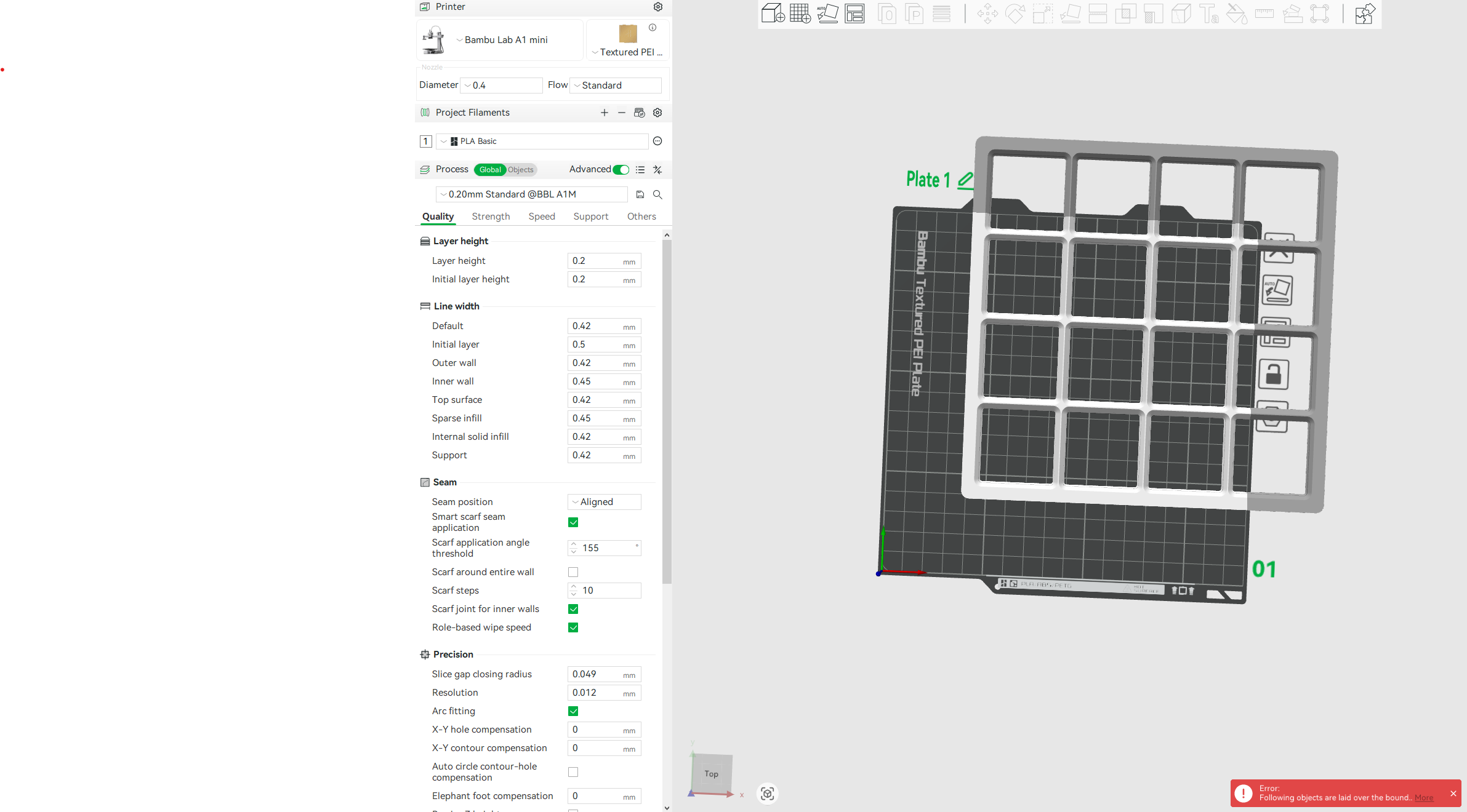

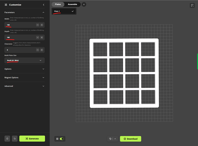

Similarly, this 180mm x 180mm model should fit on the A1 Mini plate, however if I center it in Parametric Model Maker, the 3MF has the model offset again.
I can see why this is happening - the 3MF export is computing the position relative to the bottom left corner using the standard 256mm build plate. But I think it should be doing that computation using the target printer build plate size.
We can sort of correct for this in the openscad script, but we can’t be certain of what printer the user will select. The script would need always put models in the bottom left corner of the parametric model maker grid, but that causes problems because we don’t know in advance what printer is being selected. Bottom left of X1/P1 has an exclusion zone that needs to be avoided. Bottom left on H2D would force the model onto the left nozzle, which is also not what we usually want.
What we want in all cases is the behavior we get with the 256mm x 256mm build plate: centering the model in parametric model maker centers the model on the build plate.
