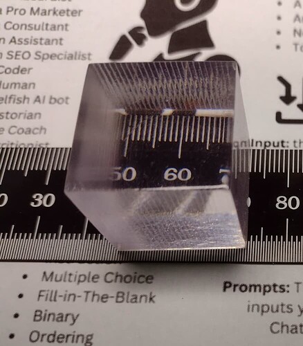

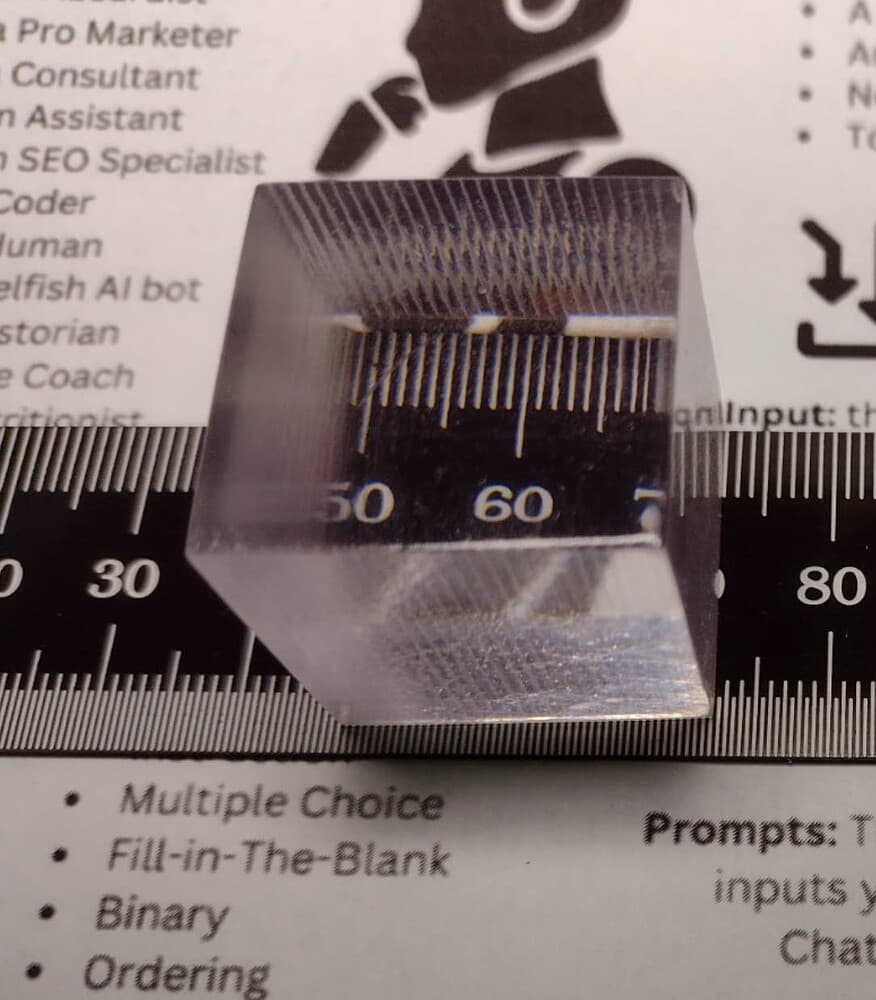

Here is an “extreme” benchmark example of what is physically possible using a combination of methods. I realize this is well beyond what you are aiming for, and most people will never reach this level. I am including it deliberately so you understand where the upper bound actually is. If you can approach this, everything below it becomes easier by comparison.
This is one I did in 2023 during a very good exchange with fellow forum members. You can adapt elements of these methods to get closer to a “molded plastic” appearance, but doing so requires specialty build surfaces, surface modification, repeated tuning, and patience.
This thread is long, but it documents how optical transparency was achieved and the techniques the group used to get there. In all candor, this is from what I consider “the good old days” of this forum, when the majority of contributions were focused on how to achieve results rather than asking for shortcuts. It shows what sustained collaboration and experimentation can accomplish.

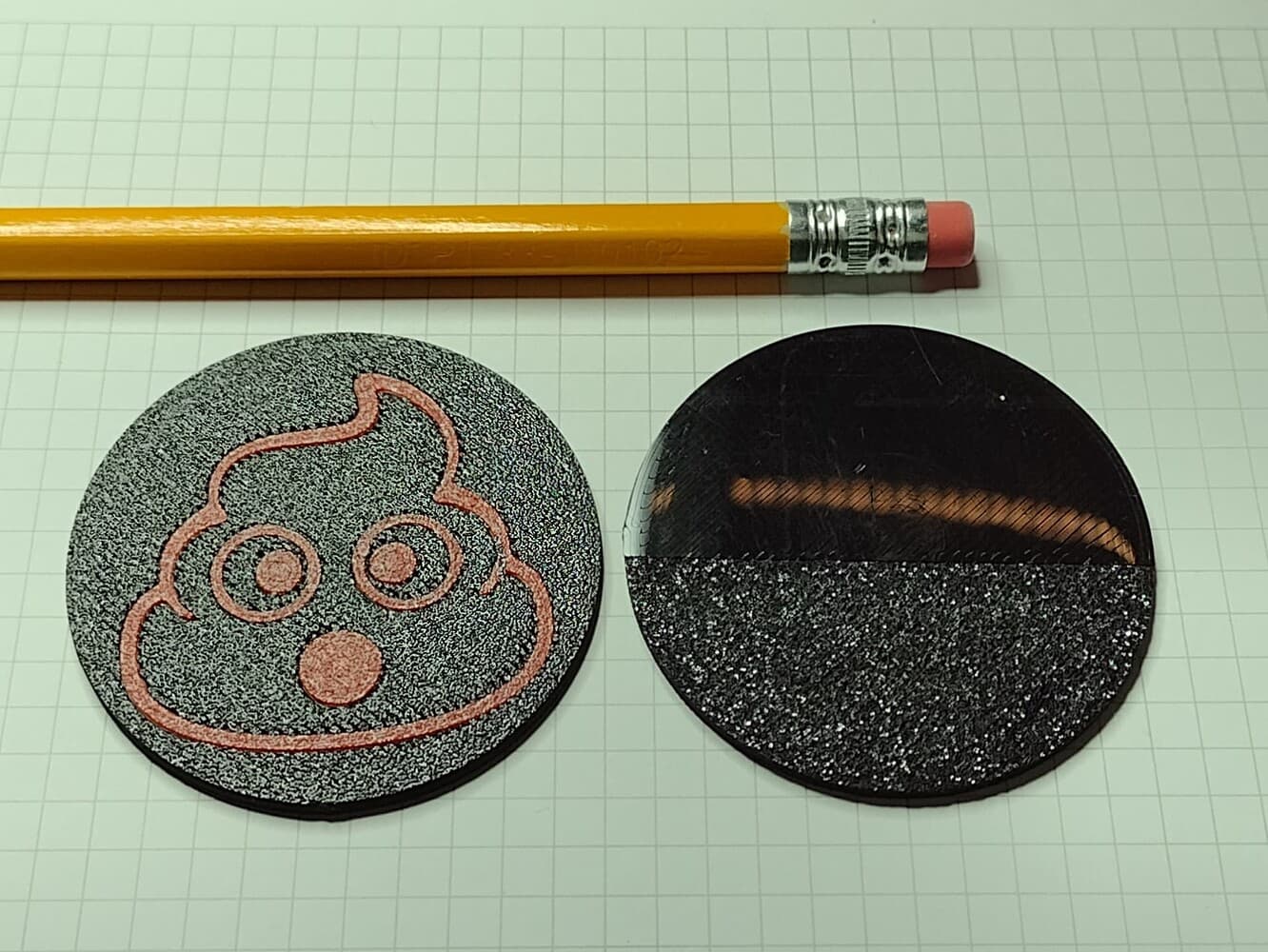

2) Modify the build surface using Kapton (polyimide) film
Once you have sourced the smoothest build plate you can reasonably obtain, surface modification becomes unavoidable. This is not optional if your goal is to minimize visible nozzle paths.
Here is another long post that goes deeper into this subject:
Below is an example using a combination of methods, including a strip of Kapton tape, with filament similar to yours. No, this is still not molded-like. But it is materially closer, and that difference did not come for free.
