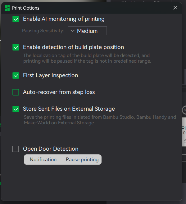

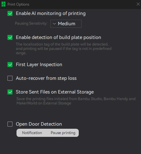

If you want to transfer the print to the printer sd card and start it you will need to enabled “Store Sent files on External Storage” in the settings and then use the “Print Plate” as you normally would.
i tried it. same thing. it used to work before, then i was busy for a few weeks and wasnt able to print anything, but when i got back i started having issues

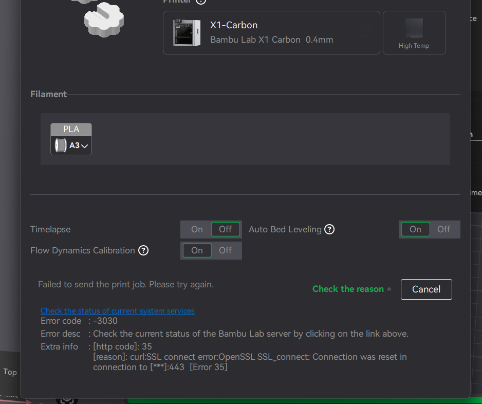

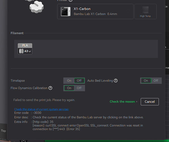

and i get this, it loads to 97%, jumps back and starts loading again to 30% and shows this

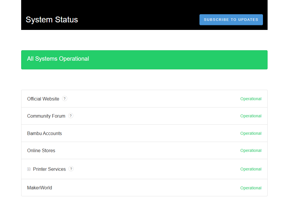

and here are the current system service statuses
