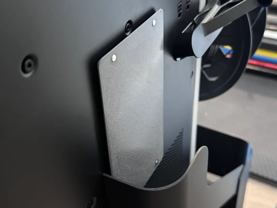

You need to seal the poop chute to avoid fumes. Can be something as simple as this:
I don’t want to just close it off; I want to completely expel it from the room using the ventilation I installed on the exhaust. But that’s not the main issue. The main issue is Bambu constantly restricting us. They should let people be comfortable and manage the machines as they see fit.

As I said a better way to deal with fumes is by making sure all of the holes like poop chute and belt tightening holes are sealed. Also if you put suction on the exhaust outlet, even when its closed, it will pull some air though the gaps if you want to create negative pressure inside the printer.
Or did I completely misunderstand you… and you just wanted to vent? :joy:
I don’t know how to explain it more clearly. I don’t recall asking for suggestions on how to prevent smoke from escaping. All I want is to be able to control the printer the way I want.

Or just use an enclosed poop chute… “cheap plug for my design…”
