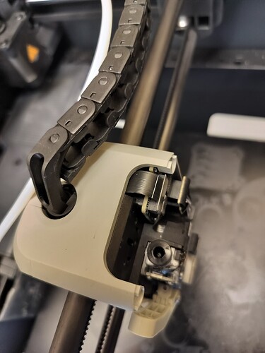

Short filament stuck in extruder
After trying to pull filament back after a failed print, the black PETG broke off inside the extruder. What is the best way to get printing again???
You may be able to heat the nozzle up and extrude the filament in the extruder while feeding in new filament.
If it is clogged or the filament has deformed so it can’t be extruded you will need to take the extruder apart to clean it out.
Here is the wiki for doing this (its for the x1c but it is very similar to the P1 Series)
Here is the wiki for getting the P1S extruder out.
Manually actuate the cutter, reach in with tweezers and remove the bit of filament.
