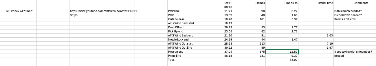

Did some frame by frame analysis of Albert’s @247Printing short AMS clip if it is of any interest.

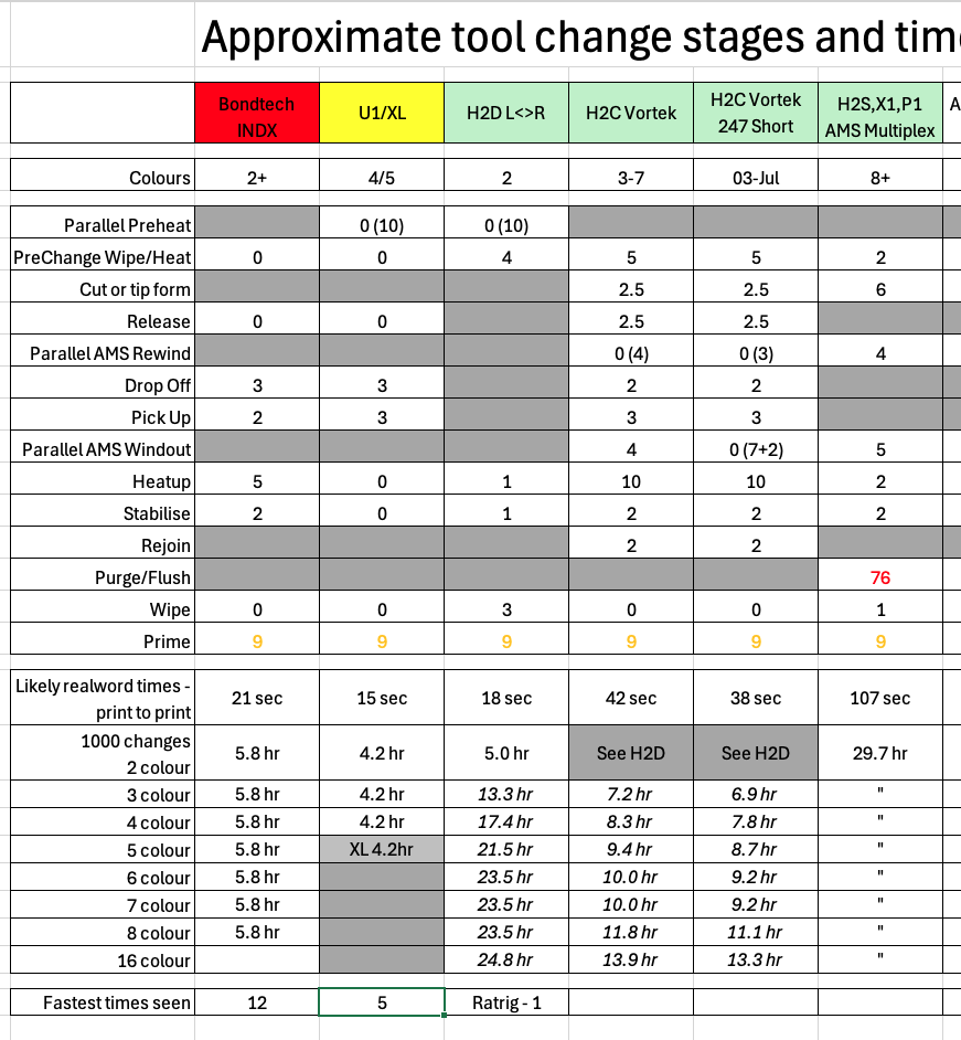

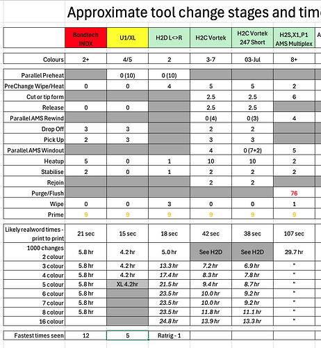

Added this 38 sec time into my comparison table, together with 247’s 4 second longer 42 second timing - for comparison with U1, INDX etc.

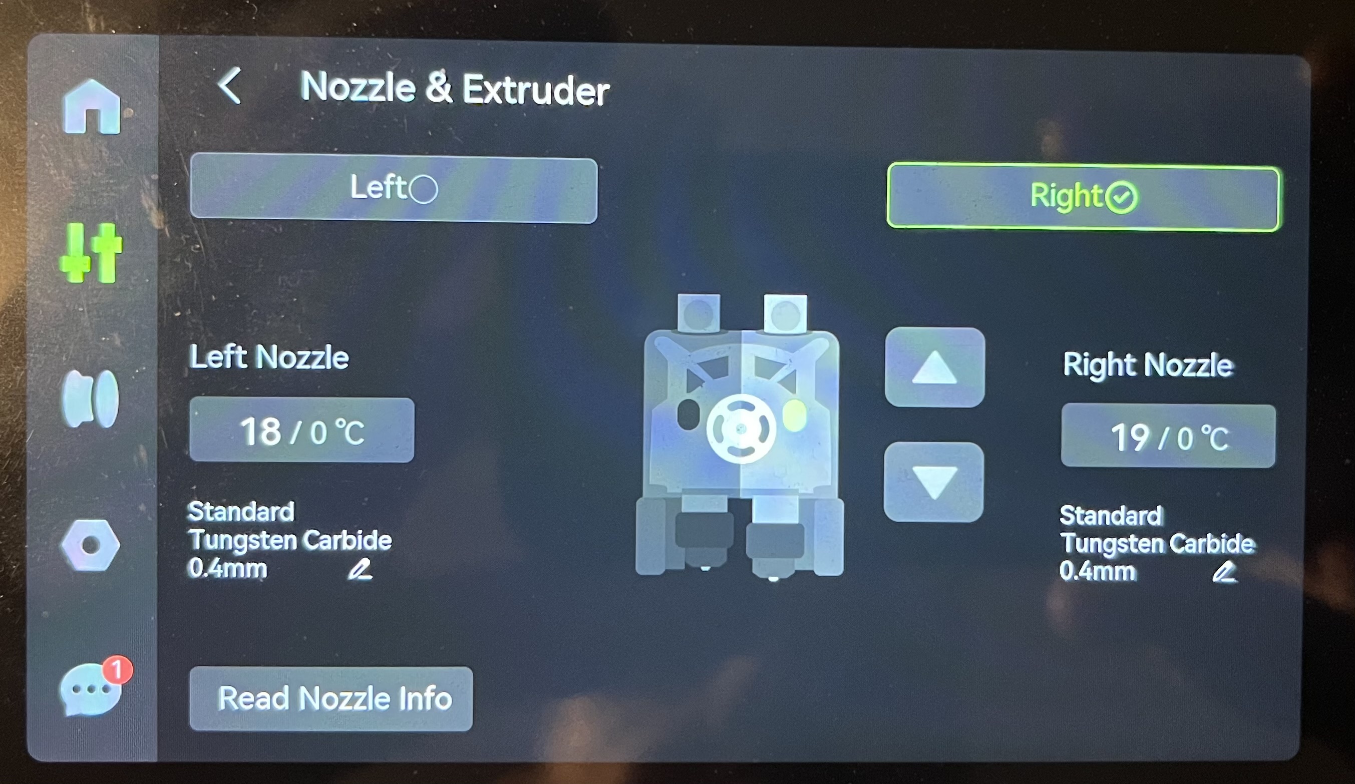

Then probably that wave has already arrived for the H2D.
When I scan the Tungsten Carbide nozzles from the printer menu, it reads them without any problem and nicely reports the correct nozzles.
Also Bambu Studio doesn’t complain.
That’s nice – mine will never detect them. It’s currently dead, waiting for spare parts after both the hotend cooling fan and the TH board failed.

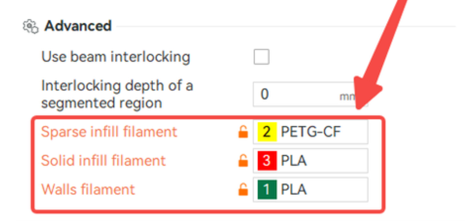

How did you get that feature to show up?! Im refering to the filament assignment for sparse and solid infill. Im on V2.4.0 and have an H2C and would love to change the infill material.
