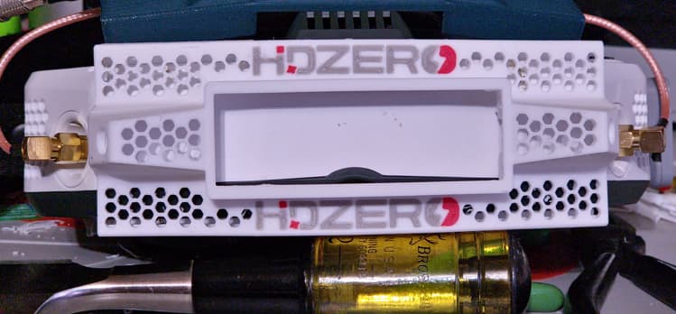

I did this 3 color print in PETG. I think it ran 5 hours (0.12 layer height). Door closed, 260ºC extruder, bed at 60ºC. Printed face up (so the lettering was horizontal when being printed). You can’t see from this angle, but the color changes all happened around the 4th hour of the print. So it was running white a good long time before the first switch. The colors only took a few seconds for each layer. More time switching filament than printing it.
