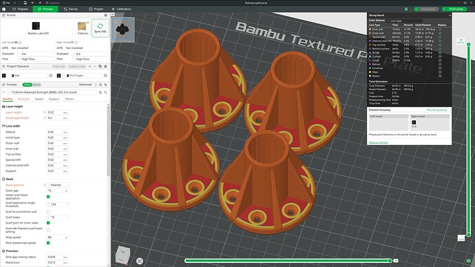

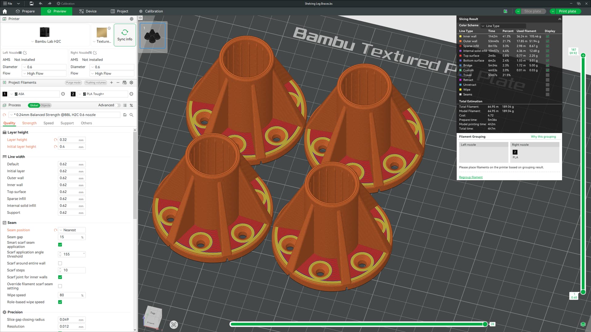

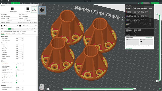

Sometimes it can save time, sure. Overall time depends on many factors. And some parts may not need high quality surface or high precision.
As a simplified example here are some wire shelving leg brackets I needed to anchor a shelf bolted to the top of a work table (shelf is over the printer, so lots of wobbling). A .8 nozzle worked great for this since it was more about strength than refinement. With only difference being line width, the whole print saves ~40 minutes, or around 16% faster. Not ground braking, but not zero.
0.8 nozzle:
0.6 nozzle:
As I mentioned this is just a simplified example… one could also increase line width of a .6mm nozzle, increase layer height, print speed, and whatever other settings to speed things up.
Anyway, I think playing with different settings and nozzles in the slicer can be very interesting, and doesn’t cost anything.
And I agree the .6 size seems like a great middle ground, and I end up using those more than the .8 size.
