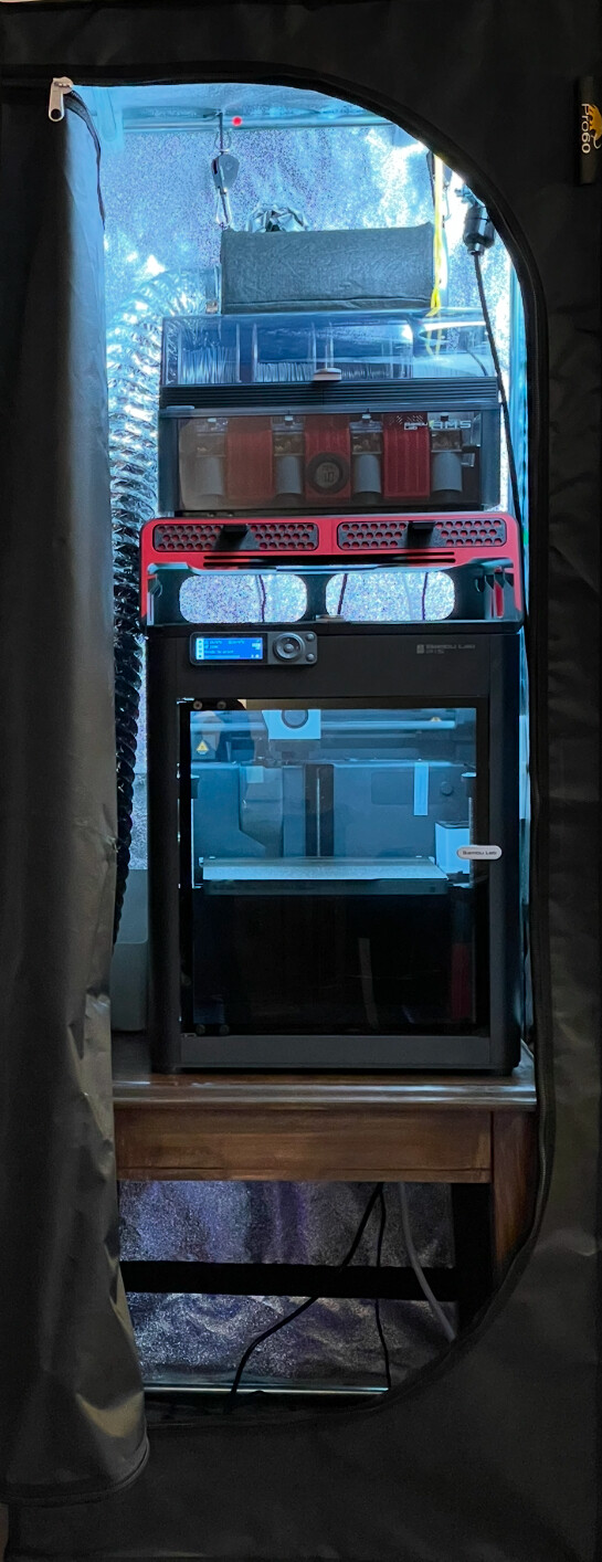

A grow tent houses my p1s. At the top is an activated carbon filter attached to common dryer ducting. This ducting runs to an inline fan and then through a printed petg adapter which I attached to a thin wood plank using double-sided tape.
It is in the window only when in use.
