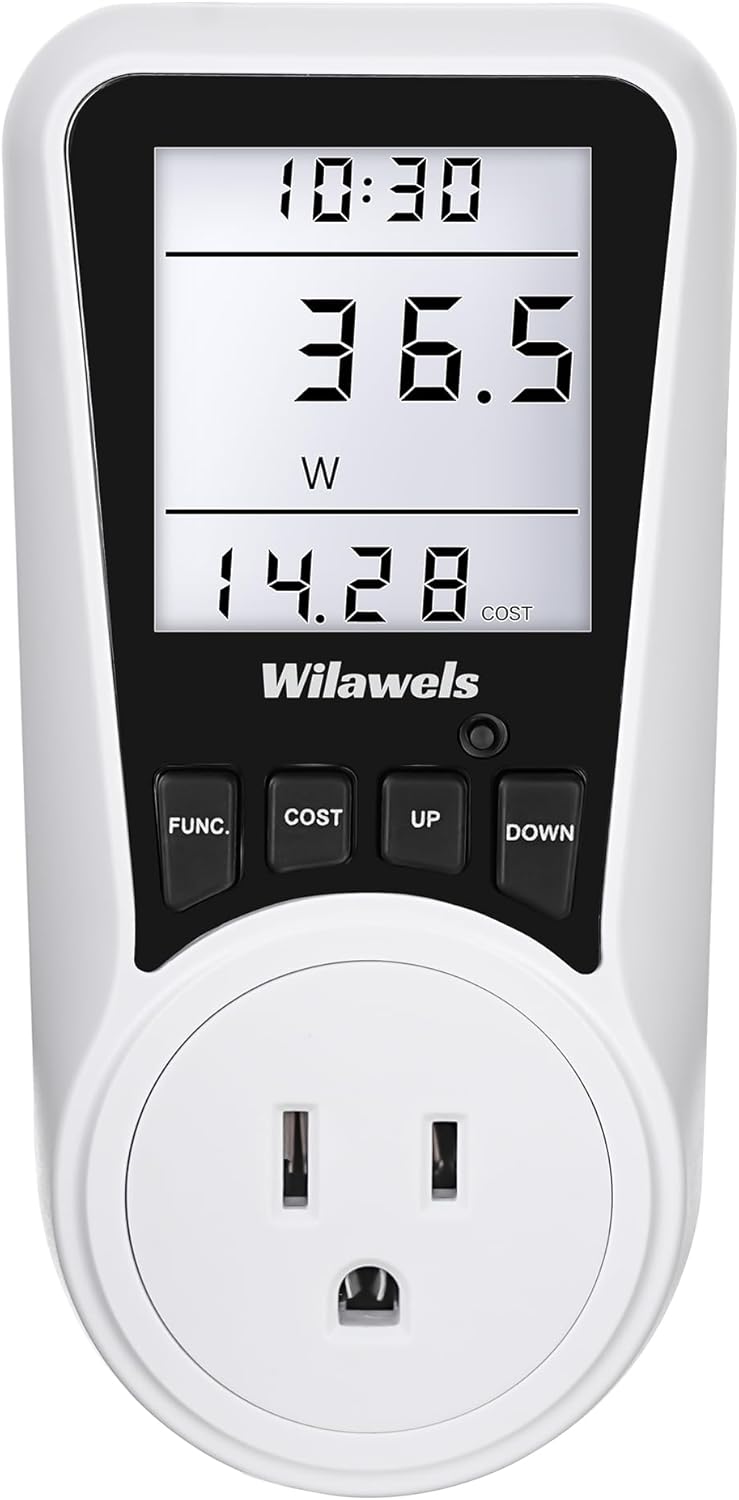

As someone who builds systems for both hobby and sport. I can tell you that I have yet to find any internal system cant accurately measure current draw without influencing the draw itself. That’s why in data centers, we use intelligent Power Distribution Units which measure the power draw at the outlet.
There are devices out there and algorithms that can “estimate” a computer’s graphic cards power draw as an example, but at the end of the day my own measurements have proven to that these are wildly inaccurate. That can mean anywhere from 5% to 20% off.
Why do I know this? Because I didn’t read the brochure or marketing BS. I actually plugged one in and graphed the data in a spreadsheet. The data that every system I’ve ever measured vs what was coming out of the wall, was all over the place as far as accuracy.
I have four of these devices kicking around in my home integration lab and one that I keep on my P1. My primary use is not because I’m trying to measure cost, although they are used for that, but rather a system’s power draw can say a lot about what may be going wrong when certain operations ensue. But only if it’s accurate. When I mean system, I mean microprocessor based platforms.

And then the other end of the spectrum at $10
https://www.amazon.com/WILAWELS-Meter-Calculator-Electricity-Consumption/dp/B0CLDFX882/
Both do the same thing.
