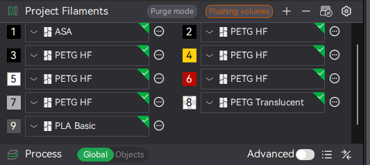

Hi,
i currently have two AMS 2 (connected to the right Nozzle of my H2C) and one AMS HT (connected to the left Nozzle). In Bambu Studio in the prepare Tab i see all the filament that is in all of those AMS but from that overview i am not able to see in which AMS the specific Filament is.
See here:

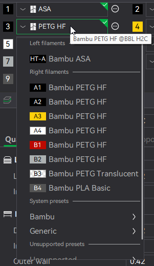

Only if i click on one of those Filamentes i can see in which AMS that filament is located.
See here:
I did not find one, but is there any way to also display that in info in the overview?!

The overview does not reflect the content of the AMS but it is just a list of the filaments that you need in your project. You can also add more filaments or reduce the list if you want to.
The sync is just a convenience feature to copy the filament from your AMS. But you could also select completely different filaments in the overview, then slice your project and only then load the required filaments and start a print.
Also the order of filaments is independent from the order in your AMS. You match them later when you send a job to the printer.
That seems awkward at first, but it is crucial for preparing projects that use different filaments than you have currently loaded, especially when you plan to publish them e.g. on makerworld.
For inspecting the currently loaded filaments, you best go to the device tab. There you can see the individual AMSs and the loaded filaments with the actual order.
