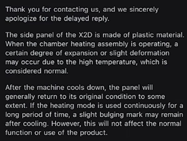

This reply from Bambu Customer Service regarding side panel expansion was shown in a You Tube video around the 4:10 mark although the whole video is worth watching…https://www.youtube.com/watch?v=u-xF4iKVmIc
I like Bambu Lab products. However, seeing the wording “generally return” and “to some extent” doesn’t particularly instill confidence. Maybe my expectations are too high for products.
I think having a housing that, at least, doesnt defom under normal operation for a 600$ and above machine should come as a “default“ but certain members in this forum will jump right in to tell me how everything is great and that I should be happy that bambu made such a “cost effective solution”

I understand that Bambu is claiming it is normal and downplaying the impact, which appears more cosmetic than anything else. Nevertheless, it doesn’t help if the market perceives this as a quality problem.
