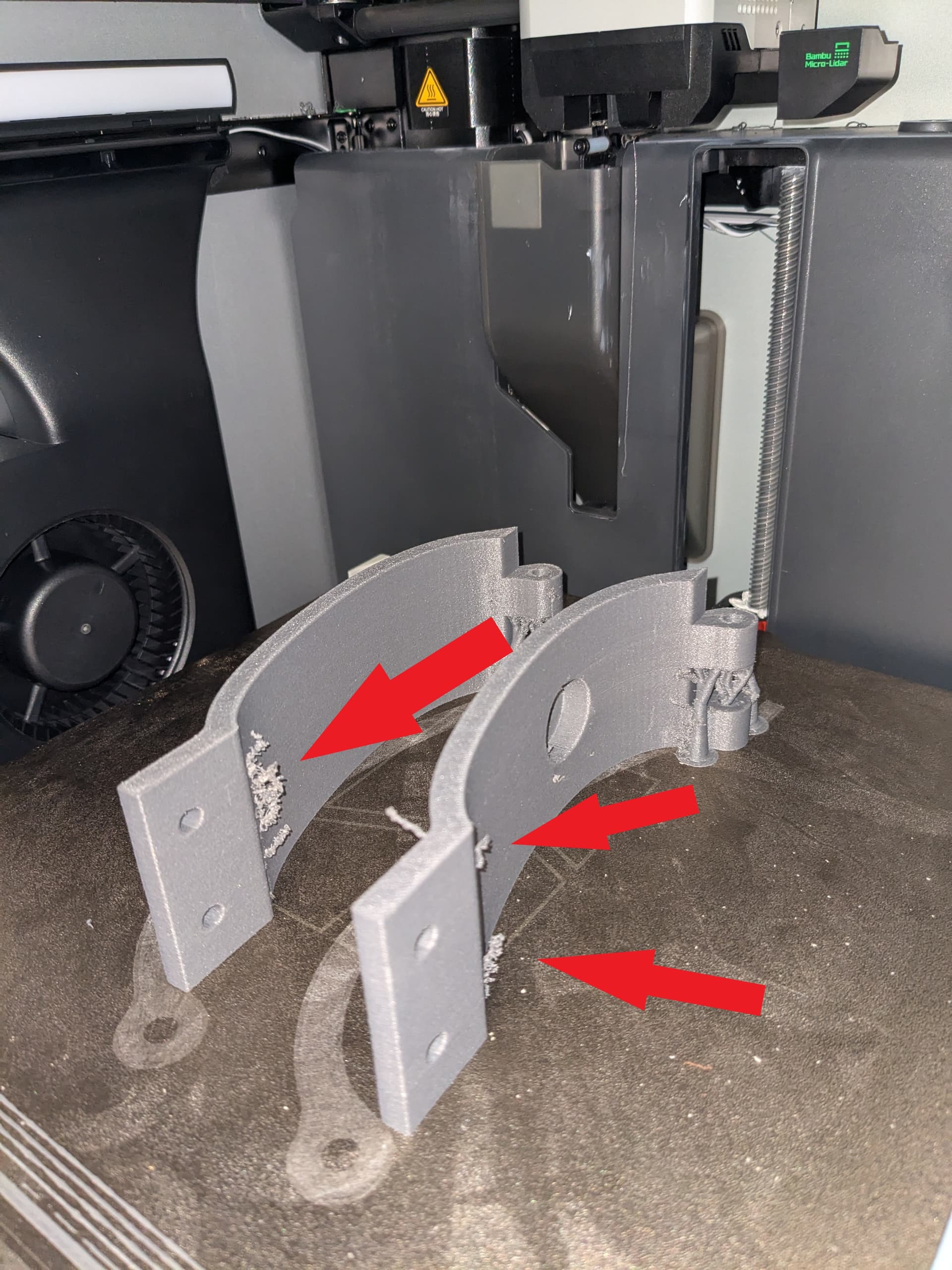

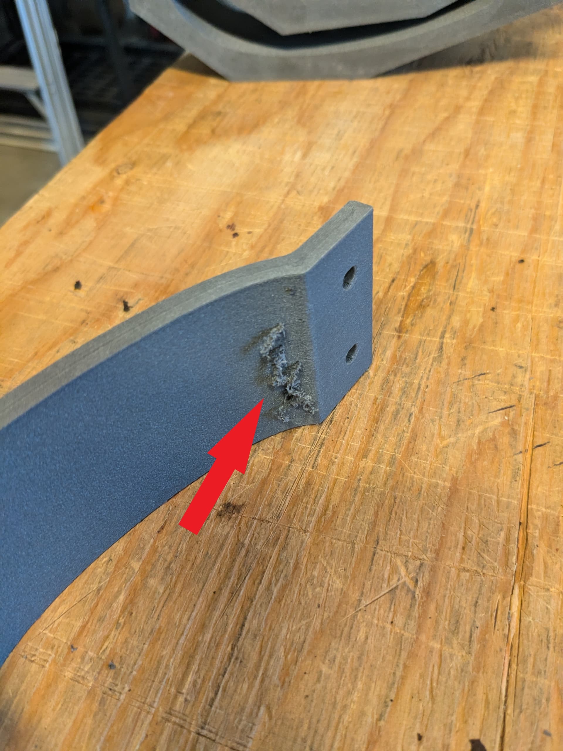

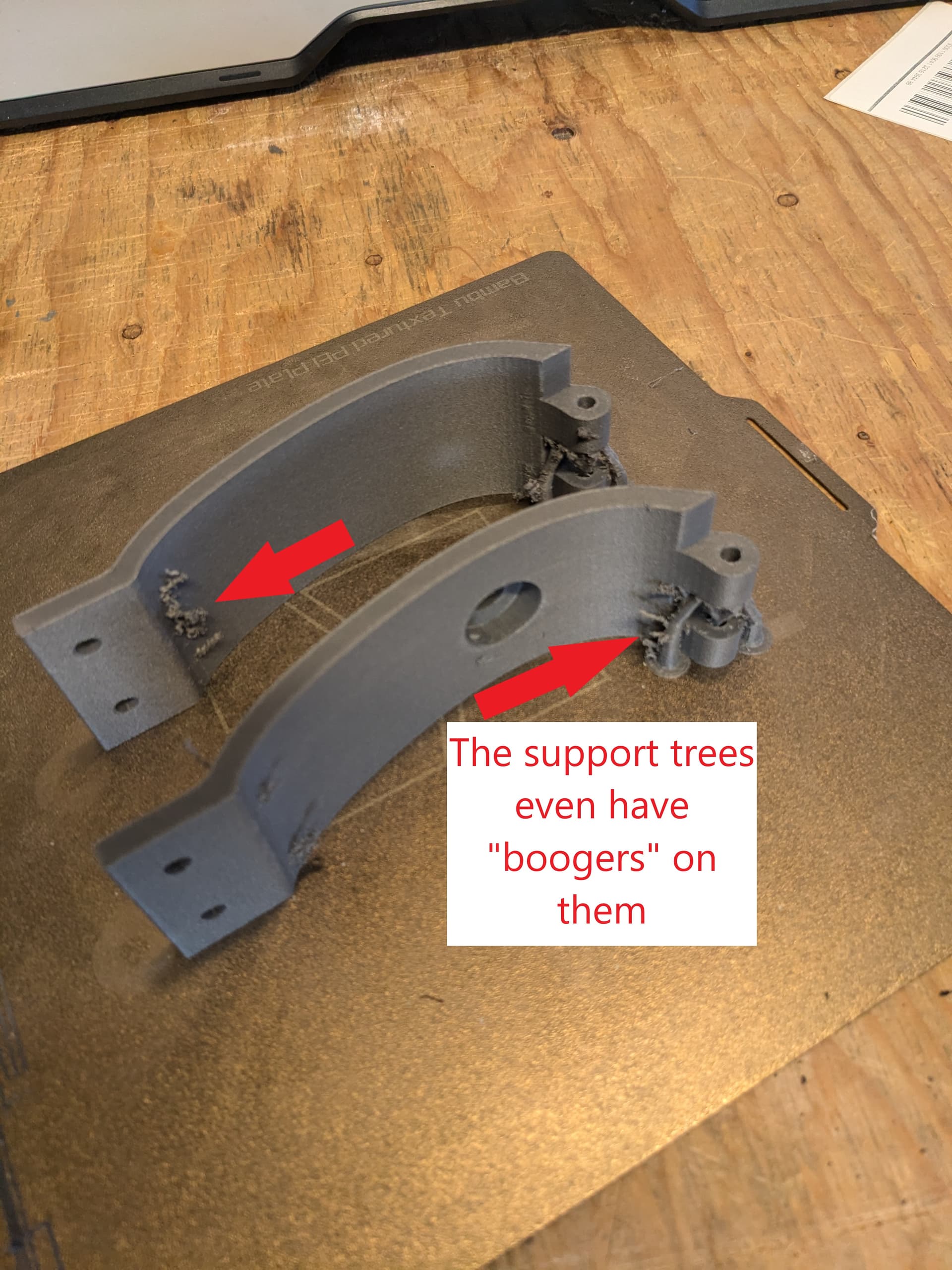

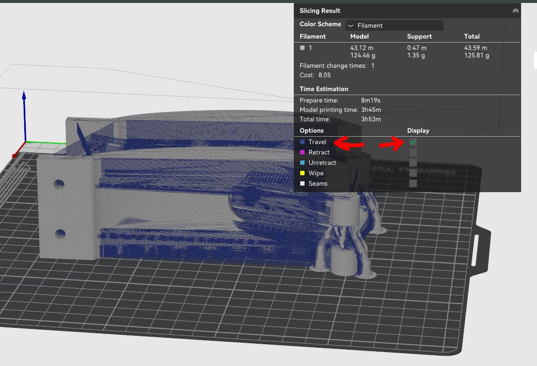

I have two X1C’s that I print almost exclusively with PA6-GF. One of them prints flawless parts, even on 24+ hour prints. The other one is starting to print what I will call “boogers” on the side walls of the parts and it getting progressively worse. I use Fiberon PA6-GF and use their recommended 40C bed temp and 300C nozzle temp on both printers. All prints are done with 100% infill. Both printers have the exact same nozzle, a 0.4mm Diamondback nozzle. I have almost Attached are some pictures I took this morning of a couple parts with these “boogers”. It is even printing “boogers” on the tree supports. Any idea what is causing this and how do I fix this?

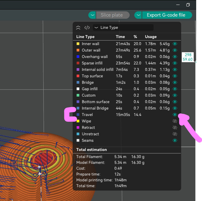

Enable visualizer for travel
Do these pileups match a spot you see in the travels? Yes - Ooze, dry it again, or attempt to dial in retraction settings a little bit but IMO this is oozing.
@Bullocks
Sorry, but where do I find “visualizer for travel” in bambu studio?
This toggle
@Bullocks
Is this it? Your screen has way more stuff than mine.
Yep thats it. There are 10+ visualizers in that dropdown to analyze, you’ve got the same breakdown [line type] but its hiding in there.

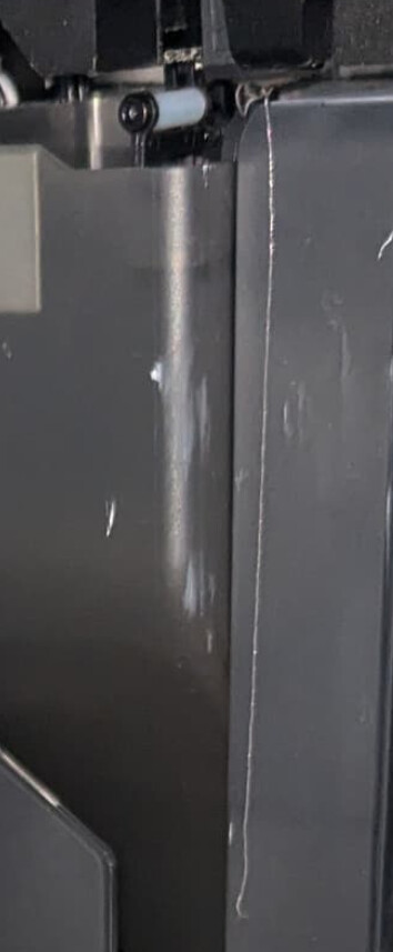

I would like to note another clue re: moisture/ooze/uncommanded extrusion:
@Bullocks
Good find! How do I address and fix this? The filament is in box and rarely goes above 10% RH per the meter I can see inside the box. Is this a nozzle issue or a settings issue?
I can’t readily find Fiberon’s recommendations for drying, but Bambu’s flavor of PA6-GF calls for 85C 12h of drying. and is probably a good starting point.

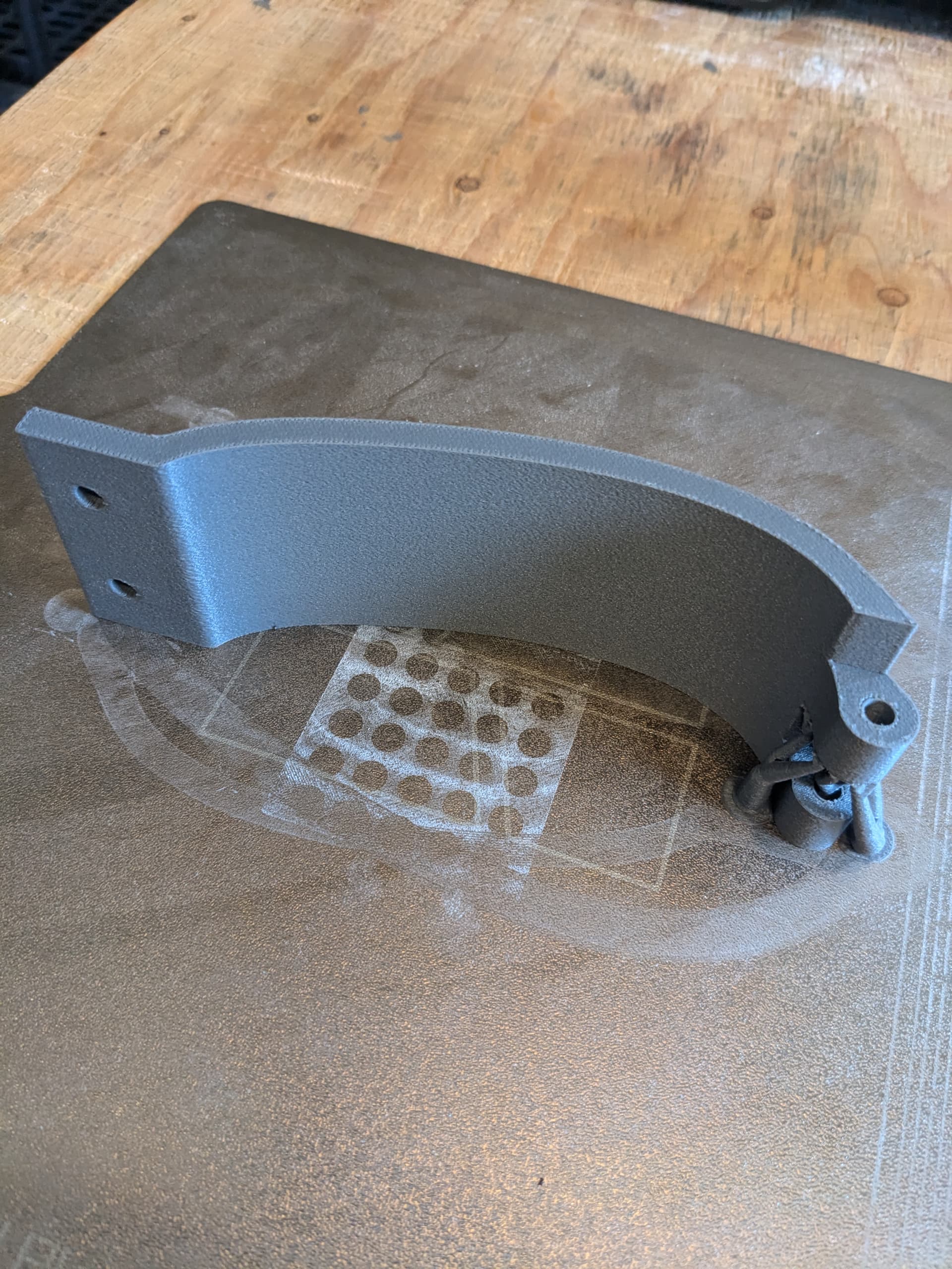

I ran the pressure advance tests this morning. I used the same spool of Fiberon PA6-GF on booth printer 1 and printer 2. The results were very different for each printer. Printer 1 came back with a K factor of 0.016 and printer 2 came back with a K Factor of 0.023. That’s a 35% difference! I then set printer 2, the one that was ozzing badly, to the K Factor from the test and did a test print on the same part. Wow, it came out almost flawless. See the attached picture of the test part from the this morning. Problem solved…thanks for your help!
