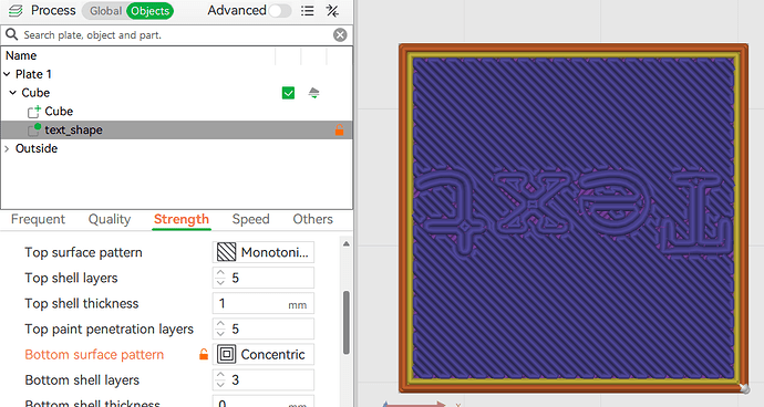

I want to put identifying text on the bottom surface of a model I am designing. I don’t want it recessed or in a different color. What I would like is for the text to have a surface that is different from the rest of the bottom layer so that it is visible but subtle.
I tried the Text tool but it is not flexible enough. Also, even on the bottom surface, it orients the text so that the viewer would have to look down from the top with x-ray vision to read it correctly.

This basic idea could work in Studio, No need to mirror, just apply the text to the bottom surface or perhaps a .SVG logo as a modifier, changing the bottom surface pattern for the text object. (Bottom surface texture depends mostly on the build plate.)
Some experimentation will probably be needed, results can depend on several factors.
Try different Bottom surface patterns for the main model, orientation of the text, size of the text, etc..
Ideally, the individual lines of a bottom surface should not be distinguishable, so if your print were “perfect” this idea would not work. But if you want subtle in a real print, this might be a solution.

or if the object is big enough, you could try and create an object from the text, so you can choose a different filling pattern, which woud become more visible with a thin bottom shell (ie 1 layer)
You could use text that is embossed with a font that has very very thin line width, so that walls actually fuse together. Then you have a closed bottom surface but where your text is, the regular first layer pattern is interrupted by the walls around the text.
I like this one. However, I need a way to apply text that won’t be upside down and backward. Do I have to flip the model over, apply text, then flip it back?
When you enter the text tool, you can move the text around. It will always be flush on the surface under the cursor. So when you move it on the bottom side, it should be readable from below without modification. Just turn the view around so that you can see your part from below the build plate. Then move the text on the bottom surface.

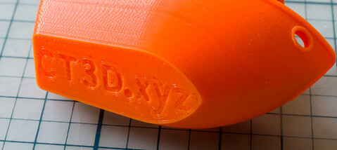

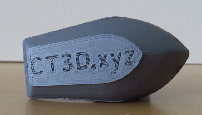

The benchy’s bottom text is recessed 1 layer and often looks near flush since like, layer 2 just flops down onto the build plate completely overhung.
Depending on the color, it can be subtle
Recessed one layer, so 0.2 mm?
