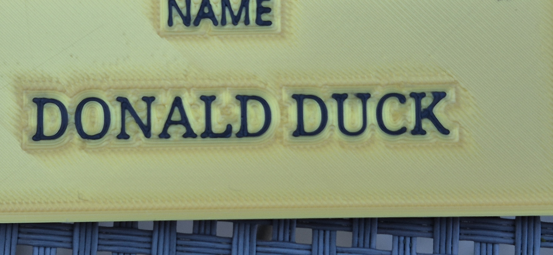

I make some personalised souvenirs which are very popular. Usually I have made them from standard PLA and the finish is very good. As an example the item is usually finished in yellow with black writing. I print the first few layers on the bed with the yellow and black writing, so the finished item has the black writing flush with the yellow surface and it looks great.
Recently someone asked me to make a special gold one, so I ordered some Sunlu Gold Silk PLA + and used the same design. However because the item is so small (about 40mm high & 2mm thick), the black writing was over powered by the gold walls around the text. I think there were 3 or 4 gold lines around the text which looked shocking. With the flat yellow, you dont see the walls as they blend perfectly with the rest of the yellow and are hardly visible unless you look really closely at the actual structure of the print.
So, for the moment I have changed the design for the gold one and printed the text on top of the uppermost gold layer, so the text is embossed. While this looks OK I am not as pleased as I am with the flush text - but its a compromise to get the appearance I want.
Is there a way of having the black text flush in the gold without being spoiled by the walls? I did wonder about reducing the number of walls (perhaps to 1) but havent tested this yet… or alternatively can the first 1 or 2 layers be printed without walls and then the rest of the layers be printed with 3-4 walls so the item maintains its strength?

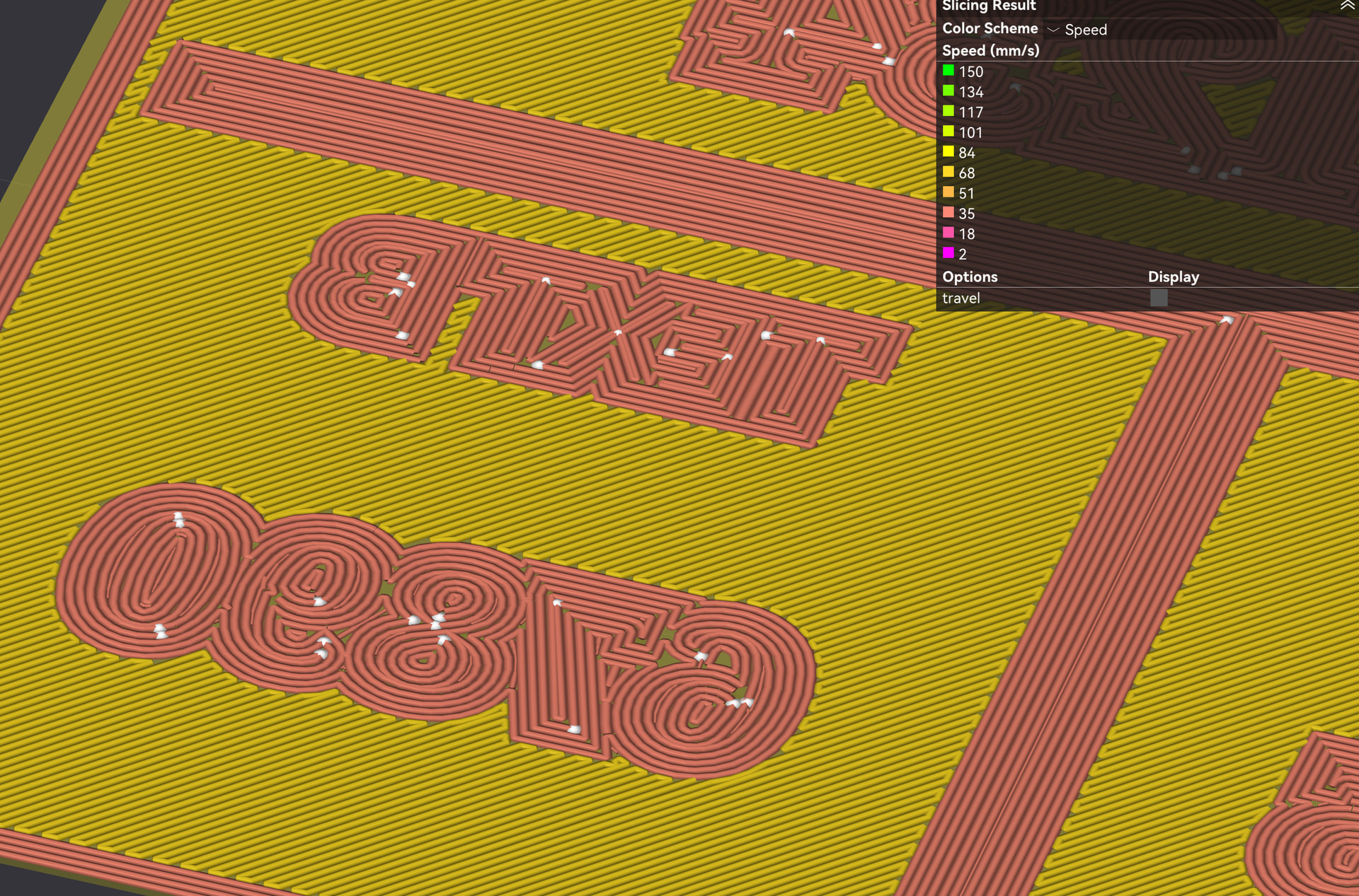

Hi @RetroSharky

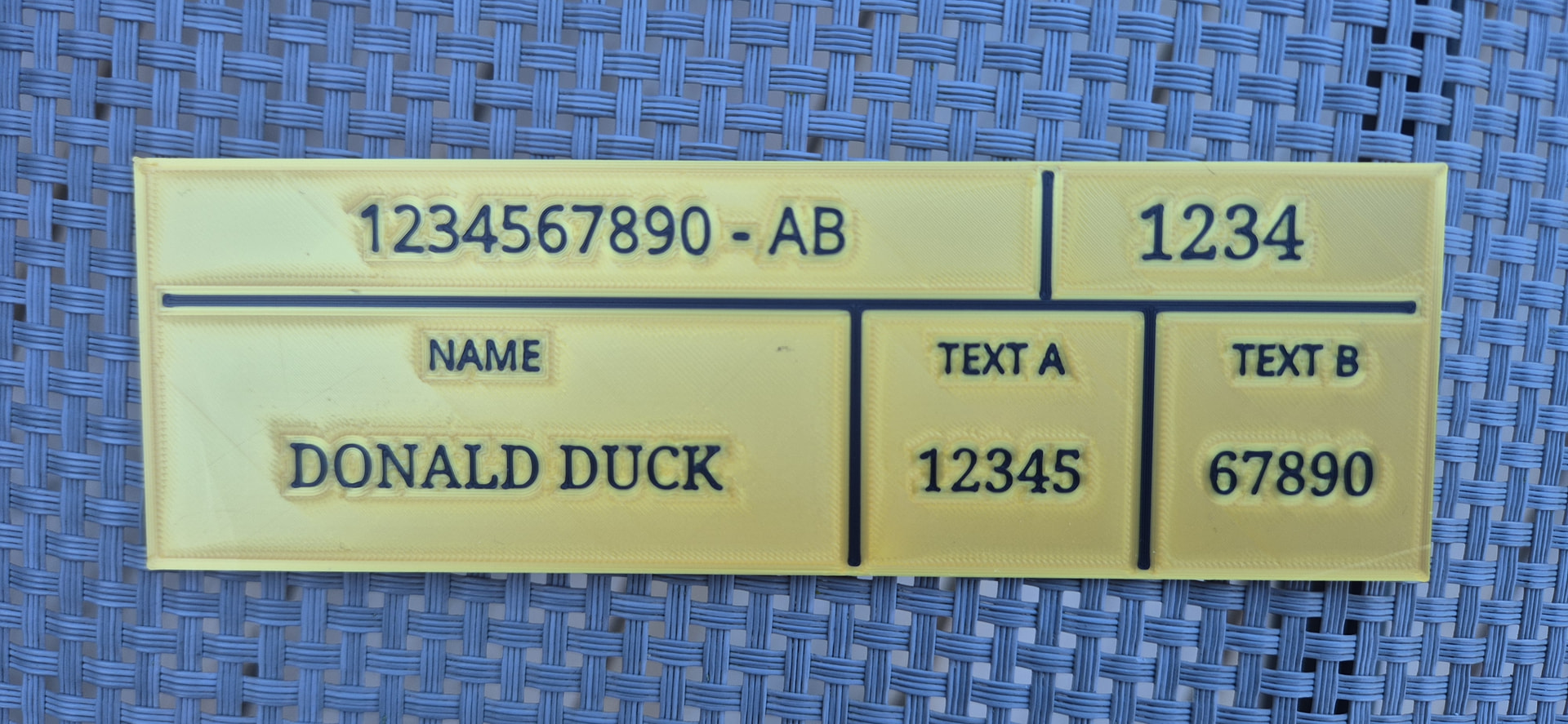

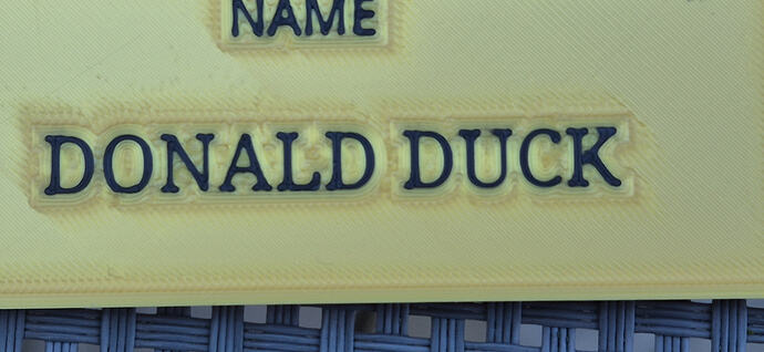

Here are some images of a finished test plaque - as you can see where the gold lays walls around the black text & lines, it leaves a halo affect. This is very noticeable in bright conditions. I did wonder if you can have 0 walls on layer 1, or maybe 1 & 2 and turn walls on for the rest of the layers… but not sure if this is possible and how it would compromise strength. Or maybe set it with something like 100+ walls, so the whole plaque is the same? With non-silk filament this looks OK as the reflection is the same for the walls and the main part of the layer - so its great, but some people ask for silver or gold and with silk PLA I get this horrible (in this instance) halo.
Any thoughts would be very appreciated as at the moment, the only way I have found as a work around is to print the text on top of the top gold layer - but this means its embossed and also the top gold layer is not as shiny as the one on the bed.
Images & 3mf for Bambulab x1c are attached

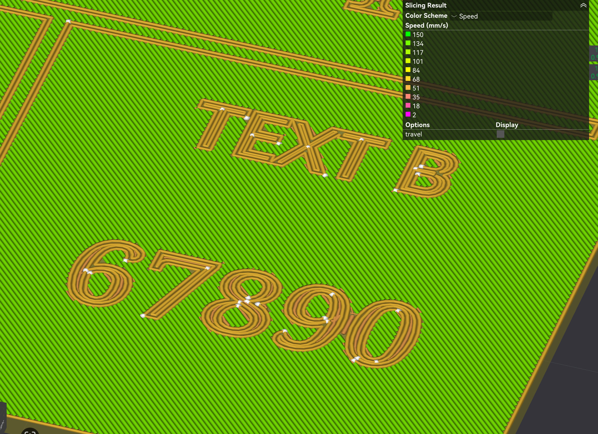

I found the problem: Depending on the orientation, the pattern, temperature, and speed all change. These are all factors that significantly influence the color of PLA Silk and cause it to vary in color. This is one of the drawbacks of Silk PLA.
When the text is facing up, you have these patterns, these temperatures, and also different speeds:
However, if you place the text facing downwards, you’ll get exactly these halo patterns, plus a different print speed and additional heat from the print plate:

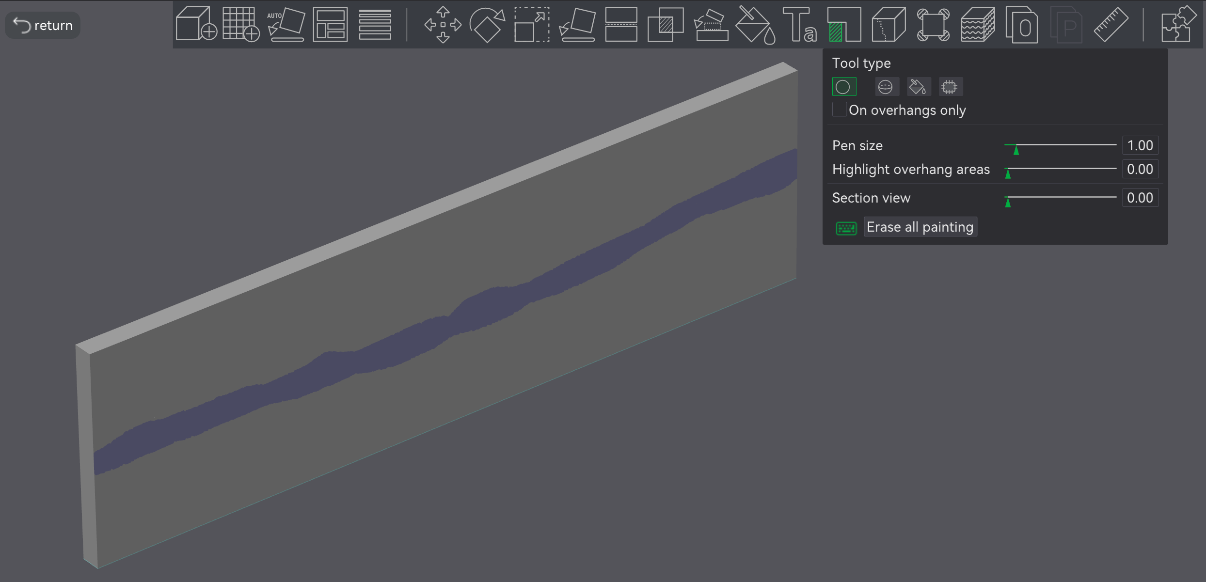

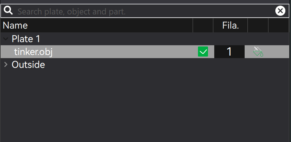

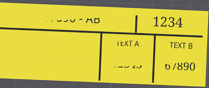

I think one factor contributing to the problem - and it would probably be better - is if you loaded it as two separate objects: the text and the plate separately. Linked, yes, but as separate objects: Right now, it’s a single object, probably from Tinkercad? And that’s known to cause some problems.

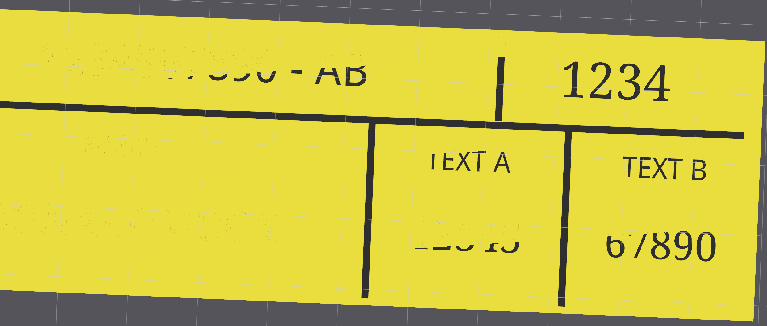

Here you can see how the slicer is already having trouble displaying this correctly:
It would be better to have two separate objects rather than just one:
There will probably be a part two to this comment…

Yes, these were from Tinkercad. Funnily enough I have done some more complicated souveniers which were too big to open in Tinkercad, so have just started playing with Studio using different oblects.
When I preview it in Studio, I too have had issues where the lines/text are missing if its not viewed 100% straight on - I didnt realise that this was the slicer struggling… I assumed it was just a quirk with previewing it!

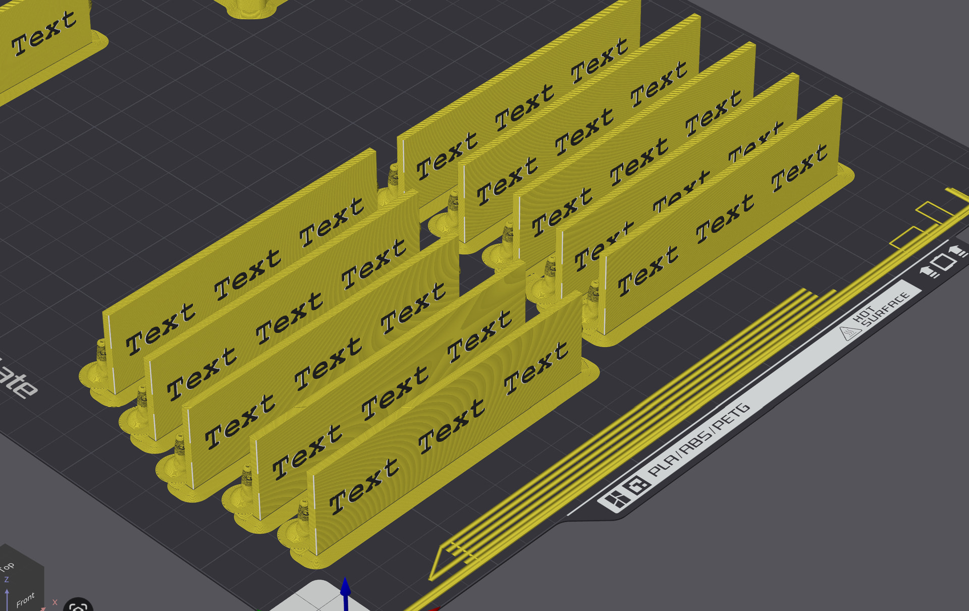

So if you really want it to be perfect - and this is the most important thing of all:

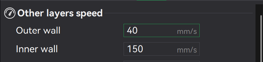

  • Slow down the print speed: PLA Silk only shines when it is printed slowly and optimally printed upright on the outer walls. Lower the speed of the outer wall.
For this to work, you have to orient the object upright. I’m sure you have a lot of questions right now, but just follow my line of thinking: Your flat surfaces will now become outer walls.

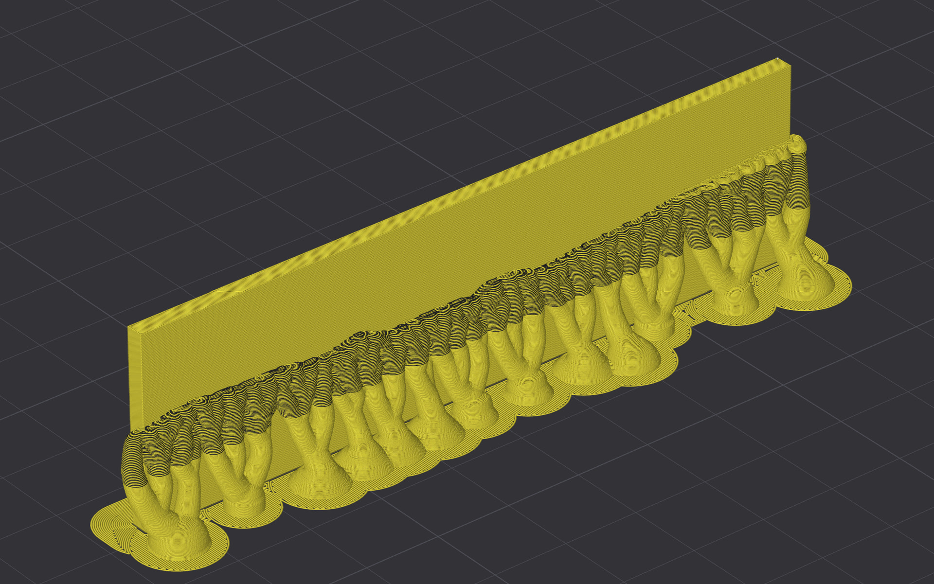

Draw the support yourself at the back:

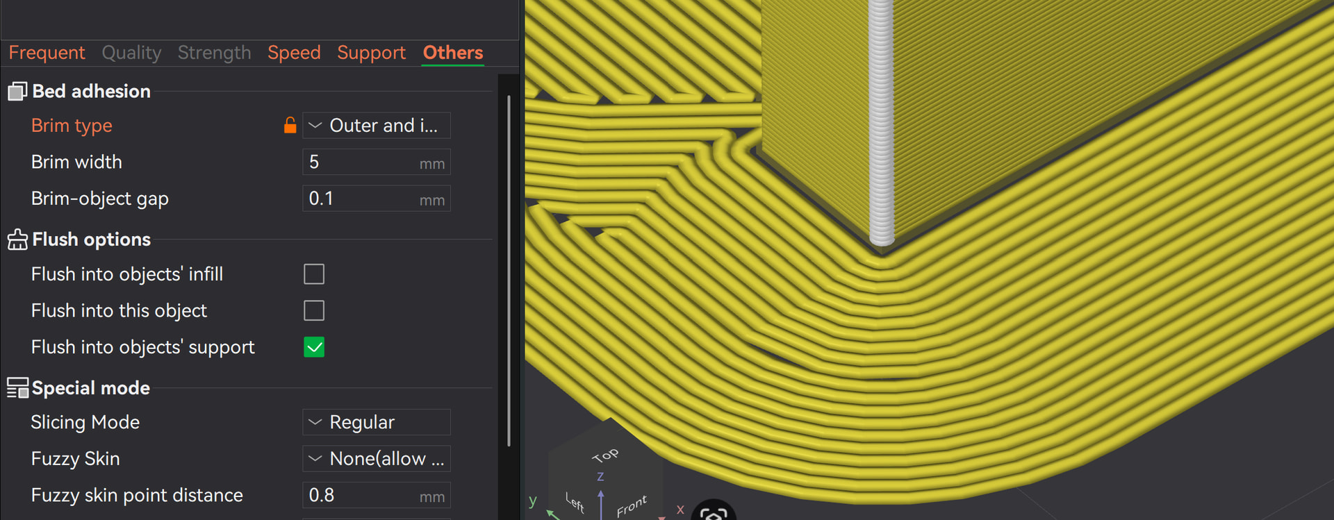

Don’t forget to enable brim as well:
Now you’re going to say: “Yeah, but wait a minute - that creates a ton of waste! ” Well, yes, but not in your specific case; if you print a lot, it stays within reasonable limits:

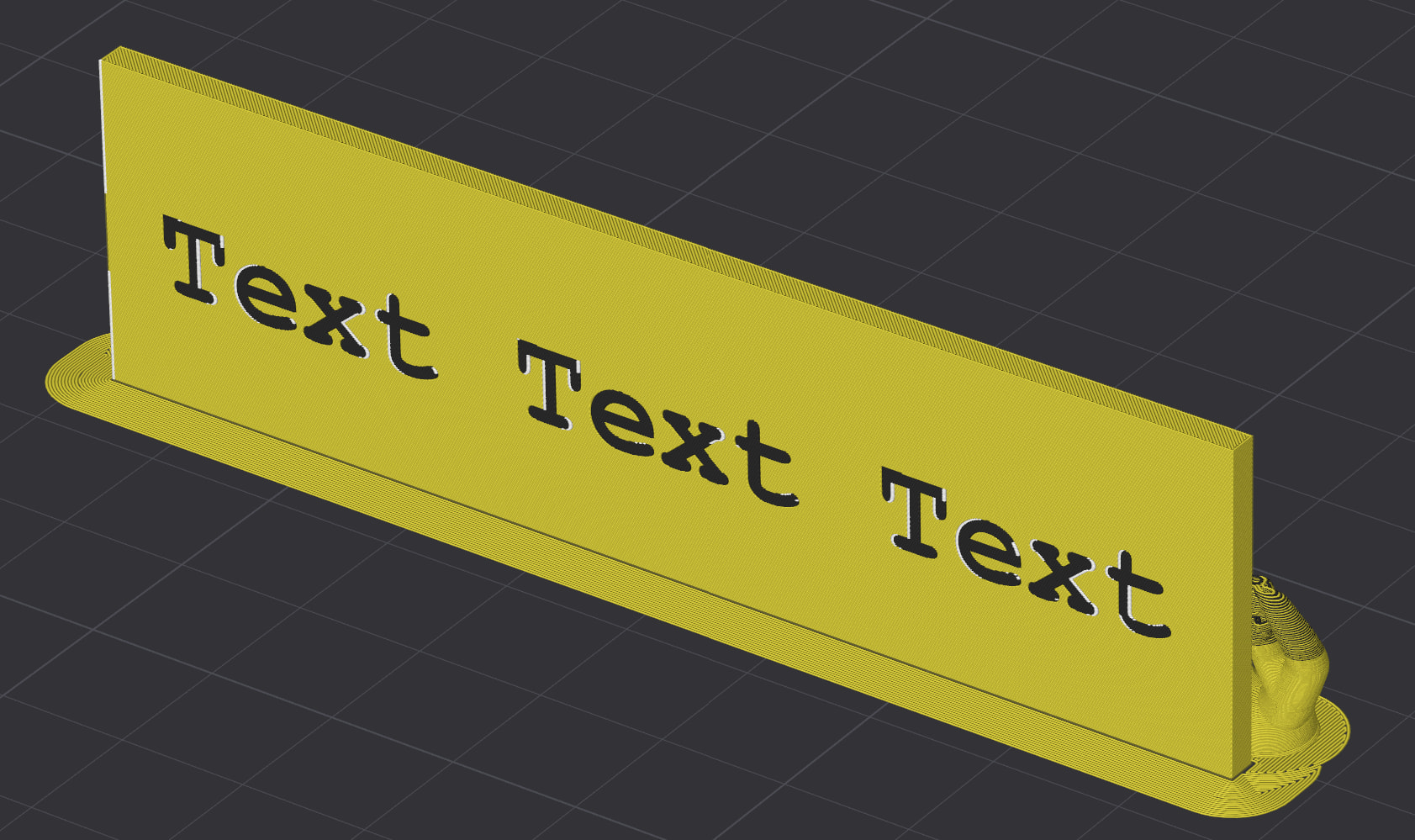

Your PLA Silk will then have a golden sheen like you’ve probably never seen before, while still producing perfect lettering.

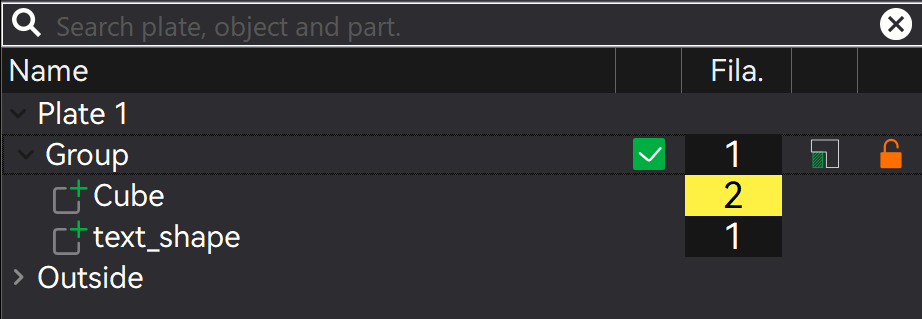

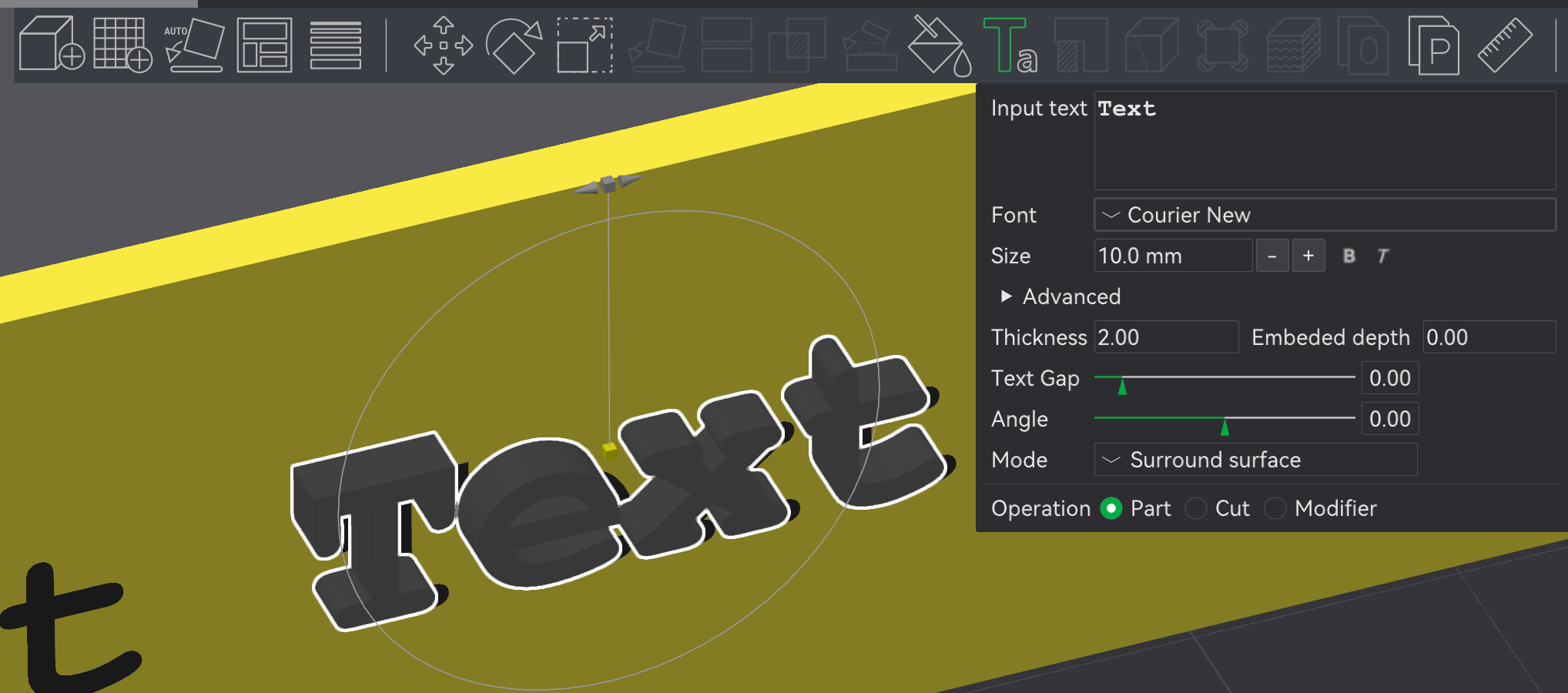

But what I did, as I mentioned in my first comment, was separate the plate and the text. I inserted the text using the Bambu text tool:
So if you absolutely want the text from Tinkercad, make sure to separate it. But keep in mind: It has to be in a group!
Your PLA Silk should then have a glossy finish like in the pictures, not a matte finish like in the photos you showed:
I’ll just say it straight out: You wouldn’t have had to buy Silk PLA, because that kind of gloss isn’t produced that way you print at all. This gloss is produced on the outer walls, not on flat surfaces.

Not sure that the vertical print is the way to go as it will take nearly 2 days to print :frowning:
So think I will try printing face up as in the slicer it shows only 1 wall loop around the text on the top layer - then I will iron the top to see what the finish is like

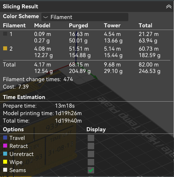

It’s only worth doing if you fill the whole plate - if you place 20 or more.
Obviously not like that - printing just 12 g and ending up with 235 g of waste makes no sense. I said it because I thought you needed a lot of them and were planning to sell them as souvenirs.
You now have 474 filament color changes, but no matter how full you make the plate, the number doesn’t change, so the plate should be fully filled. Whether you place one souvenir or 100, the filament changes are always the same, and that’s where you save a ton of time.
Give it a try - place a few more, and you’ll see that the number doesn’t increase.
Sure, if you only want to print a few, it’s not worth it.

The problem is that they are personalised with peoples personal details on each one - so every one is unique - this would mess up the filament changes too as each one would need different colours on each layer so it isnt always true that each plaque has the same changes on each layer.
