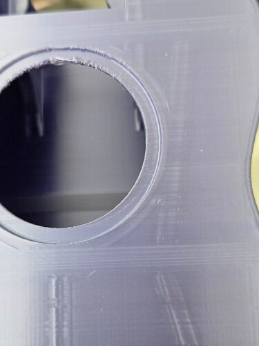

Hi all, using silk pla at 220c, chamber about 28c with fan on and door open.
I have lines that shows thru the walls where it connects with other inner sections. This is even through 5 walls. How do I avoid these lines from showing?
This was printed upright.
(I also have some overhang problems to correct)
Thanks!
First, a fundamental question: Have you adjusted the settings? The standard PLA Silk profiles stored in Bambu Studio are insufficient. You have to adjust them yourself, depending on the manufacturer.
PLA Silk in particular requires specific settings, which are usually slower printing speeds.
For Bambu Filament, for example.
If you mean the enclosure fan? Make sure it doesn’t blow against the large walls of your 3D object.
