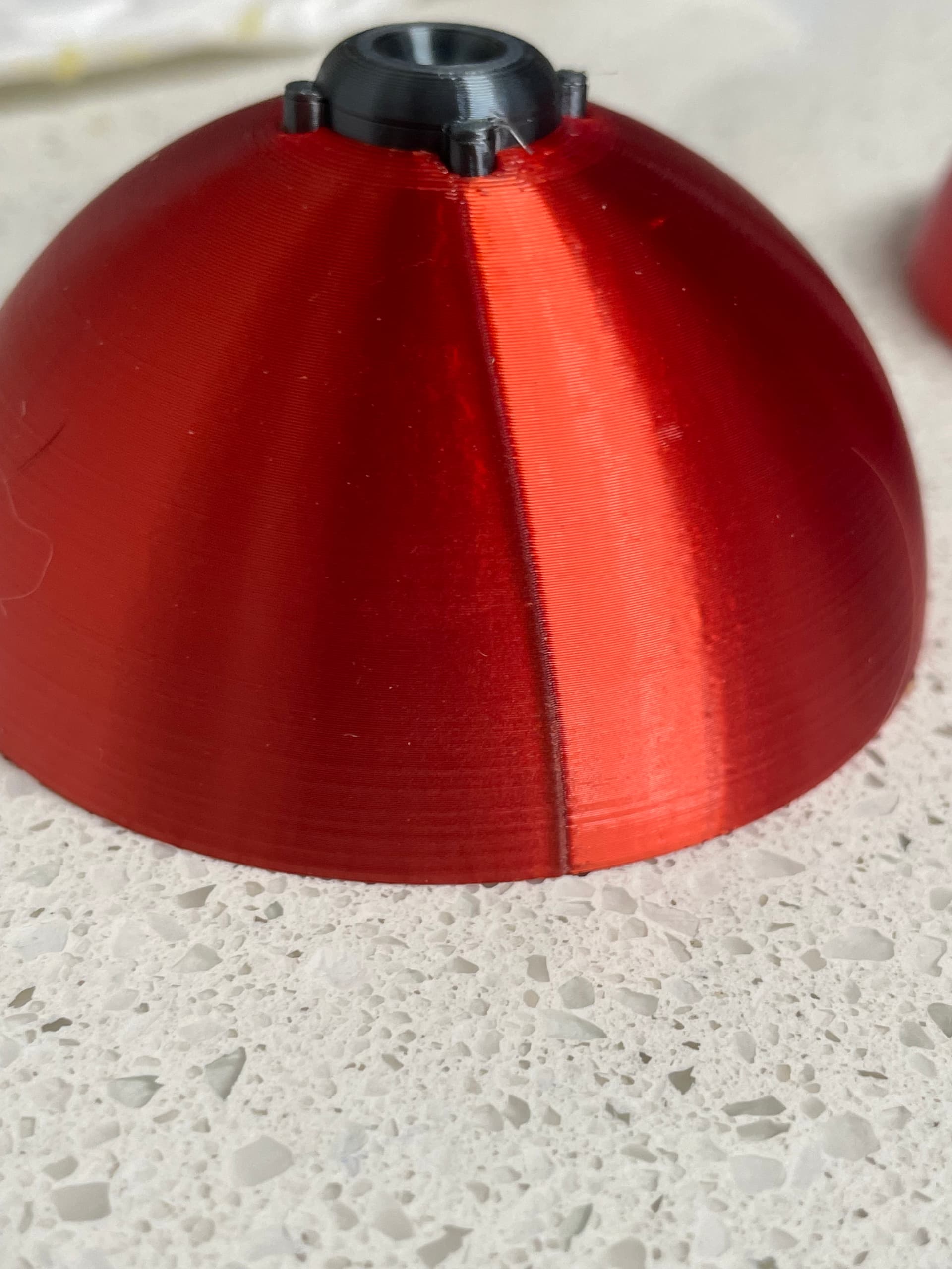

im printing this half sphere for part of a model and it turned out great printing from the bottom up but theres a seam that throws it off.

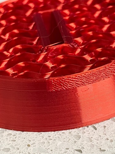

if i try a scarf the print gets mess as you can see in the 2nd pic.

silk filaments are hard to control extrusion and they are heat sensitive. This means unless you fine-tune your scarf seam settings with lots of care and efforts, you won’t get a good result easily.
I’m not a fan of trying to use scarf seams on silk, especially the coextrusion stuff. “2 passes of flow that together equal 100% of the height” works well with simple filaments, but I find that silk coextrusion just looks like a big smear. something something elastomers etc
Your pic doesnt look like what I experienced though, it looks really struggling to control the flow but its not obvious whats acting weird. Perhaps too hot? Try to craft a smaller test object.
That’s cooling/speed issue. You are probably going too fast and/or too hot on way too steep overhangs, which then curl, cause nozzle drag and manifest overextrussion . Try to print with with the flat side of the hemisphere down, if it’s hollow use supports, and slow down 25%
I did and the results were great but it had that seam as you can see in the 1st pic. I want to print it with a scarf or print it on the edge to hide the seam.
