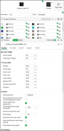

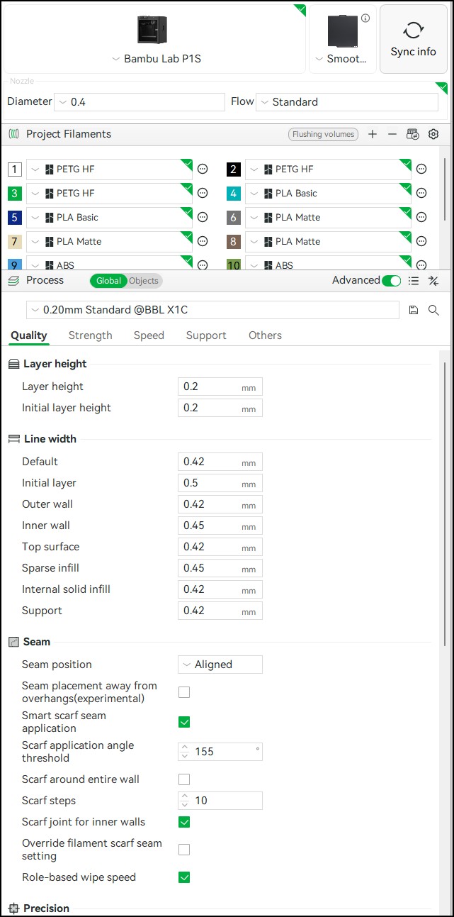

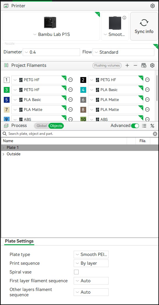

Here are pictures of various changes.
First is my configuration prior to loading a model. I have a P1S, 3 AMS, Smooth/High Temp build plate. Picture reflects that.
Upon loading your model, my configuration changes. Along with the alert. It has loaded an X1C even though I selected P1S at Maker World and have P1S as my configured printer.
Here are the settings that get changed. It loaded an X1C, a textured “gold” build plate, and (I guess?) a single AMS with two spools of black PLA Basic loaded, the second one a copy? of the first spool.
