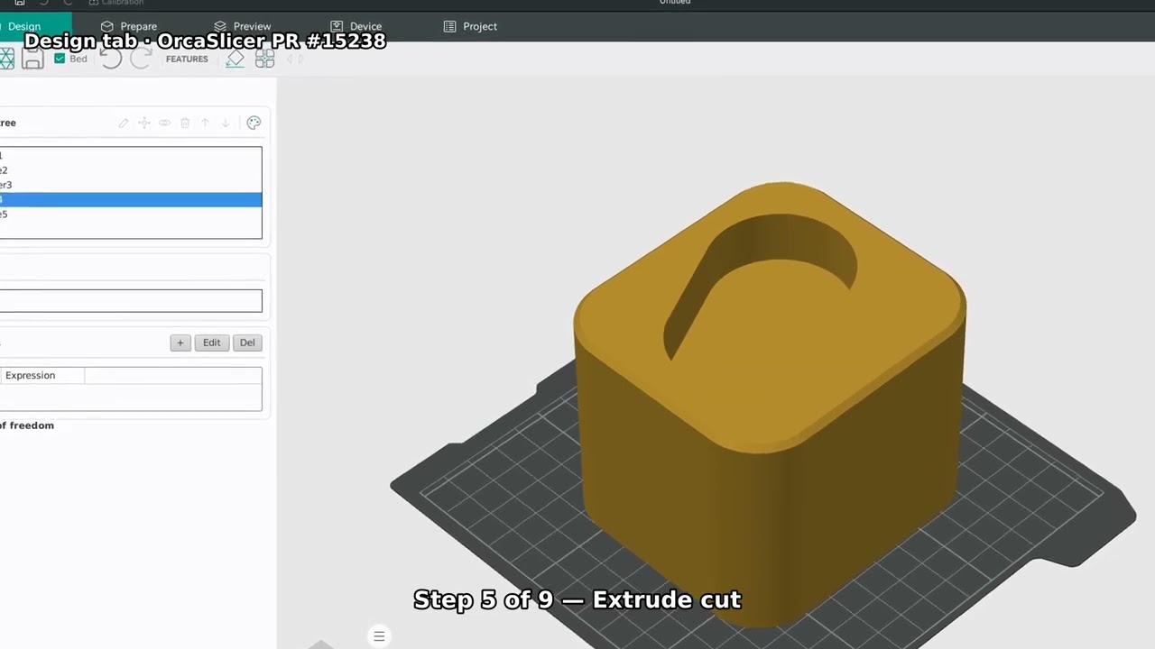

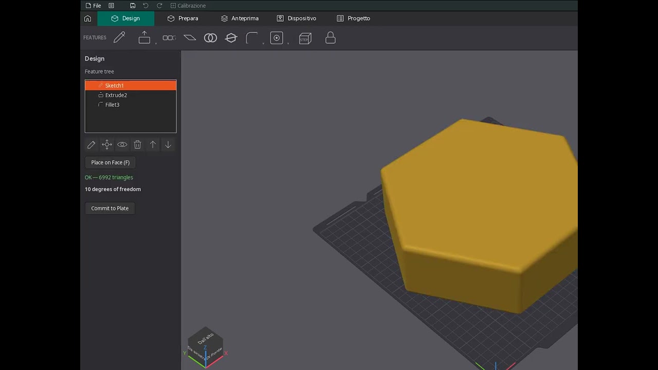

Design tab: sketch → constrain → solid features → commit to plate. The feature recipe persists inside the 3MF, so reopening a project restores an editable model rather than a frozen mesh.
This feature is now on mainline OrcaSlicer as an open pull request:
→ Design tab: sketch-first parametric CAD inside the slicer by tommasobbianchi · Pull Request #15238 · OrcaSlicer/OrcaSlicer · GitHub
Walkthrough: 1) design & sketch → 2) extrude → 3) chamfer → 4) sketch on face + slot → 5) extrude cut → 6) hole + thread → 7) commit to plate → 8) print parameters → 9) slice. The full parametric workflow, without ever leaving the slicer. Real constraint solver, OpenCASCADE B-rep kernel, STEP import, in-canvas gizmos.

Interesting but the video that slowly zooms in and puts the sidebar (where all the magic happen) out of frame is an odd choice.
Much prefer the previous video the channel released.

Thanks, that’s a much better video. I tried the Orca development version and quickly gave up because I did not understand the interface. Now I know I’m not totally stupid, the drawing tools were missing from the build I used. I will try it again later.
