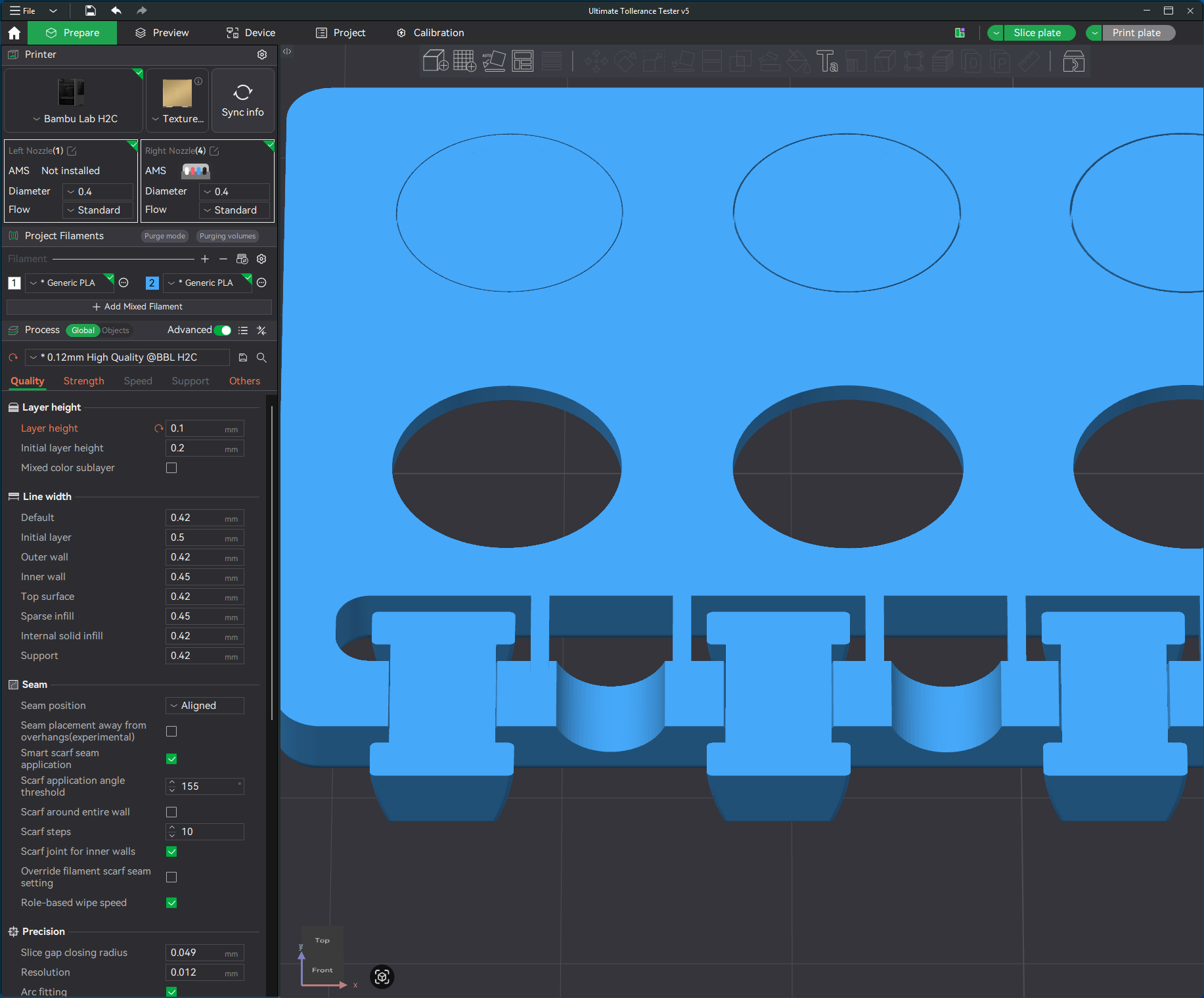

The first image is the model cut in half to show that there is a small gap between the objects:

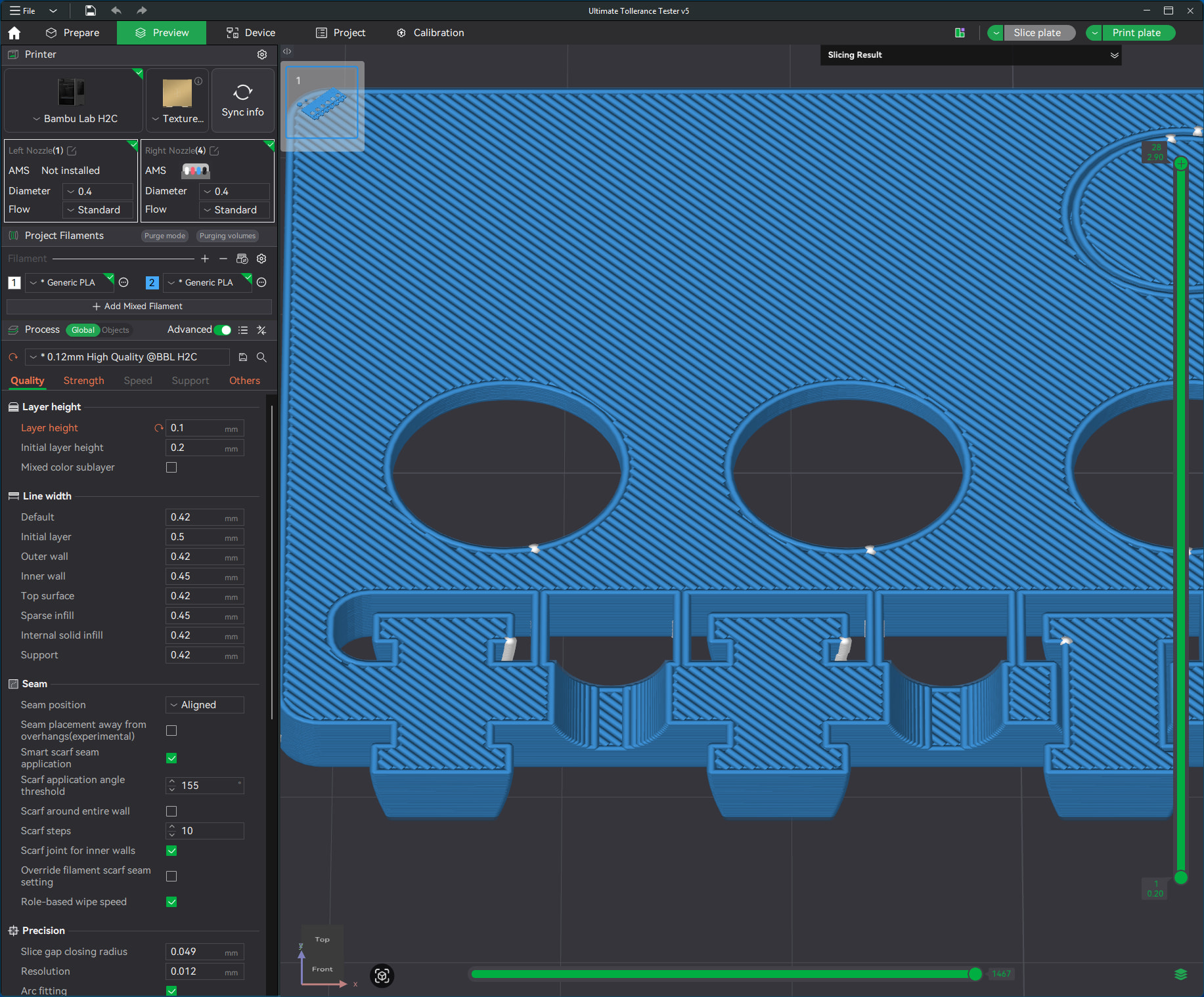

However, when the object is sliced, I get this:
Obviously, there has to be some setting that I am missing that would make the slicer split the parts. However, I can’t seem to find it.
Can someone help me figure out why the fusing is happening? Thank you.

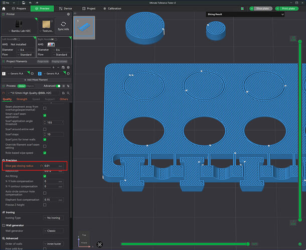

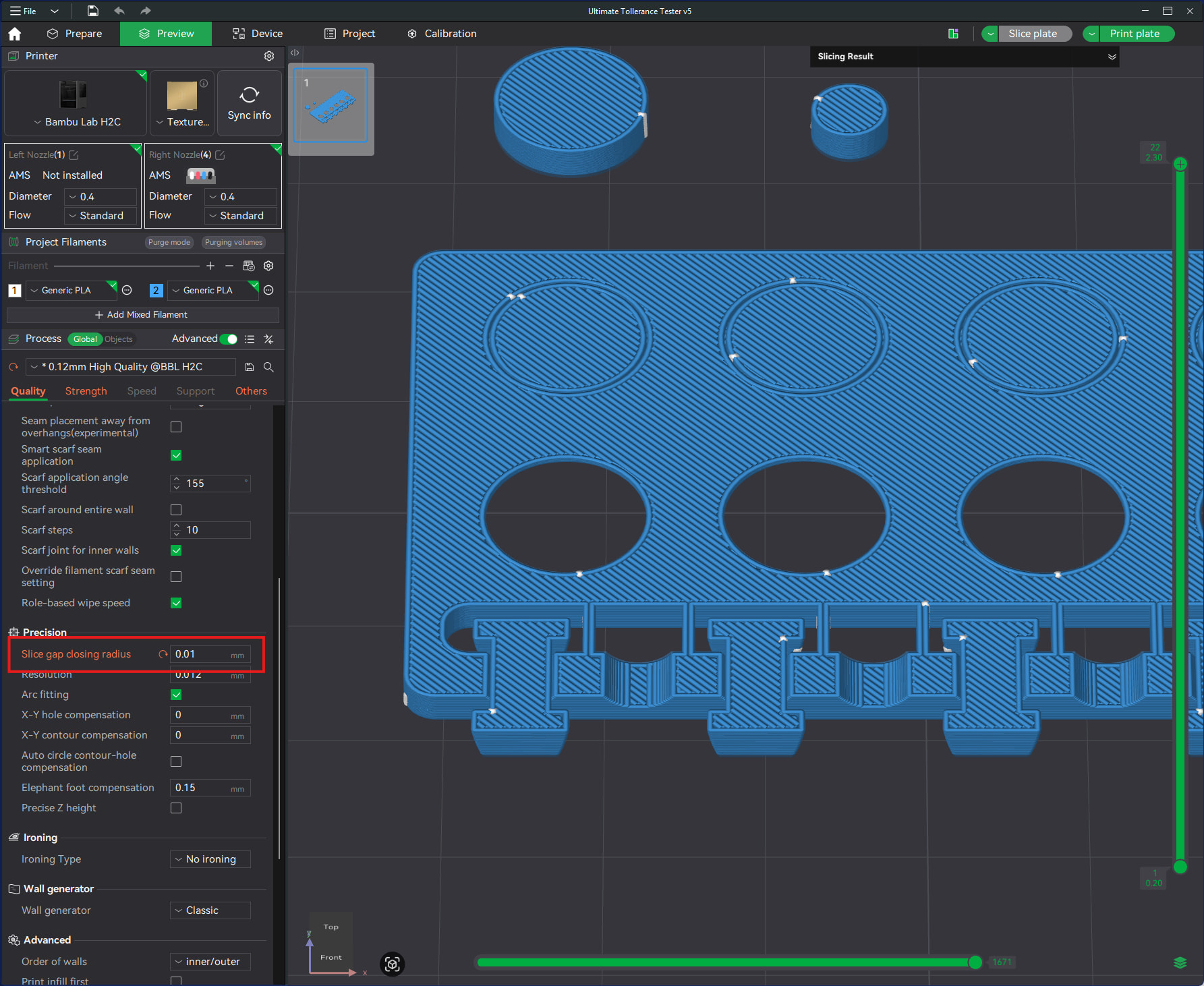

Ahh, found something - “Slice gap closing radius”.
It was set to 0.049. If I set it to 0.01, the gaps in the model are there:
Ha! Perfect.. At least had you looking in the right section :sweat_smile:
@Tool_Maker I mean… How stupid do I feel now. A whole section titled “Precision” and I couldn’t find it!!

@MaxThreeD, yes I did miss it. Although, re-reading it, the last sentence is what matters. I wanted to see how low can the printer go, so I had to change the settings to make them separate bodies.
With the adjustment, the second from the left vertical pin (0.15) comes loose with a bit of persuasion.
