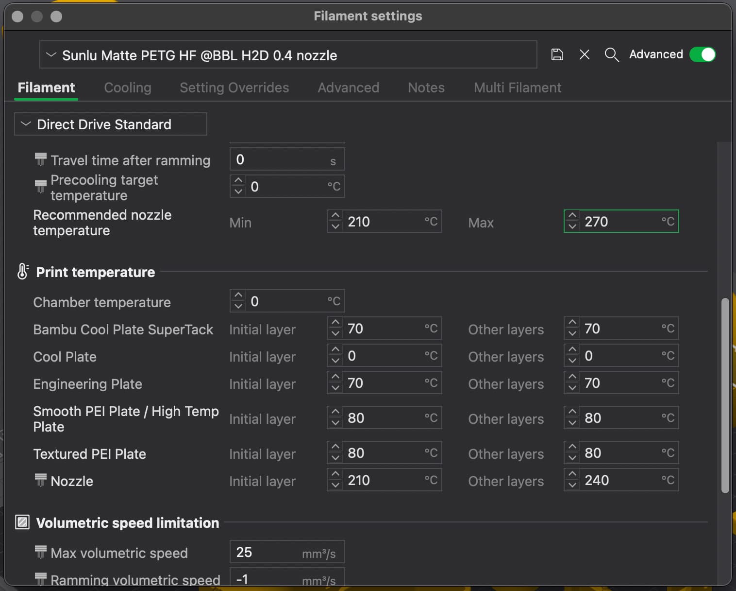

This is a strange issue I haven’t seen before today - I set up a profile for my Sunlu Matte PETG HF - with the nozzle initial layer temp of 210 and other layer temps to 240.
When I started the print - it did the nozzle initial layer at 255c - I had to manually lower it to 210. Then when it got past the 1st layer, it went back to 255c again - and I had to lower it again down to 240c.
So at first I thought I made some sort of mistake, but I checked my profile for the filament in my project and it looks like I have it set properly:
For some reason though - it is doing the first layer and all layers after that at 255C.
Am I missing something? A setting?
H2D is on latest production/stable firmware and BS is 2.1.1.52 on MacOS.

The bed is set to 80C, nozzle is set to 210 first layer, 240 other layers.
Do please look at the screen shot more closely.

So I just re-sliced it, and this time the initial layer temp is 245C, even though it’s clearly set to 210 in the filament profile.
I opened the gcode and sure enough:
; nozzle_temperature = 245
; nozzle_temperature_initial_layer = 245
; nozzle_temperature_range_high = 270
; nozzle_temperature_range_low = 210
M104 S245
M109 S245
This is frustrating.
I very clearly have the filament profile set to 210 and 240 in the one and only filament profile on this project in Bambu Studio.

Looks like perhaps the firmware is overriding my minimums due to the filament being set to PETG.
Frustrating.
Actually it looks like I need to set the filament profile up from scratch and change the Vendor [it won’t let me modify the copy I made from the Bambu PETG-HF Profile] - perhaps the FW is hard-set with a lower limit for Bambu PETG specifically.
About to test.
That appears to be the issue. PETG with the vendor Bambu Lab has a FW lower limit set of 245C.
I had to create a brand new filament profile and specify a different vendor to get it to honor my temperature settings below 245C.
It seems that when I thought it was 255C, it was 245C [that or I typo’d it and ran with it]. Beyond that the lower limit is 230C not 210C.

Are you are using high flow hot ends? If yes then you need to change where it says “Direct Drive Standard” to “Direct Drive High Flow”. You adjust all Standard and High Flow setting separately, including the temps.

I am using HF 0.4 nozzles.
That said - I set all of the settings on the profiles identical between the Direct Drive and Direct Drive High Flow tabs just to make sure that wasn’t the issue. I just happened to snap a screen shot when it was on the non-high flow tab.
I ended up totally killing Bambu Studio and uninstalling it and re-initializing everything and it looks to be behaving as I would expect.
