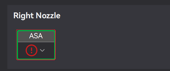

Normally for me, the external spool side is showing this:

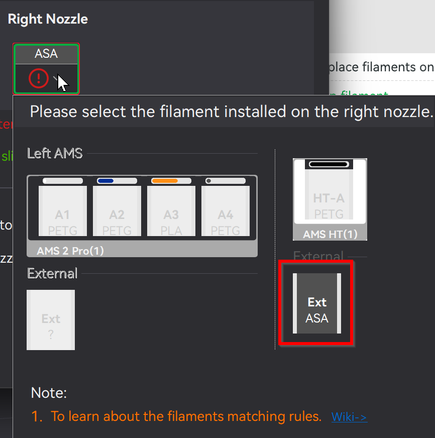

If you pick the little down arrow the following menu appears:
Select your filament, and you are ready to go.
Is this what you see?

When I do the slicing I get a window that shows both filaments.
It goes through the motions and says the slicing was OK.
Then when I go to print I get a screen that shows a filament only on the right side.
As you are still a new user, it takes some time/posts to be able to post pictures.
But what I understand, you don’t see something similar to me.

The only thing is that already for a reasonable time, I need to do this action as I explained above. In the beginning, the correct filament was selected, and the printer directly selected the external spool.
