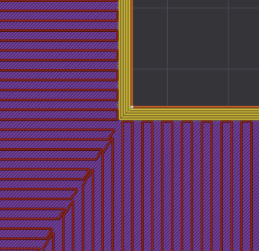

Is there a way to make the printer print in a direction for a specific part?
i want it to bridge easier since it sags a bit

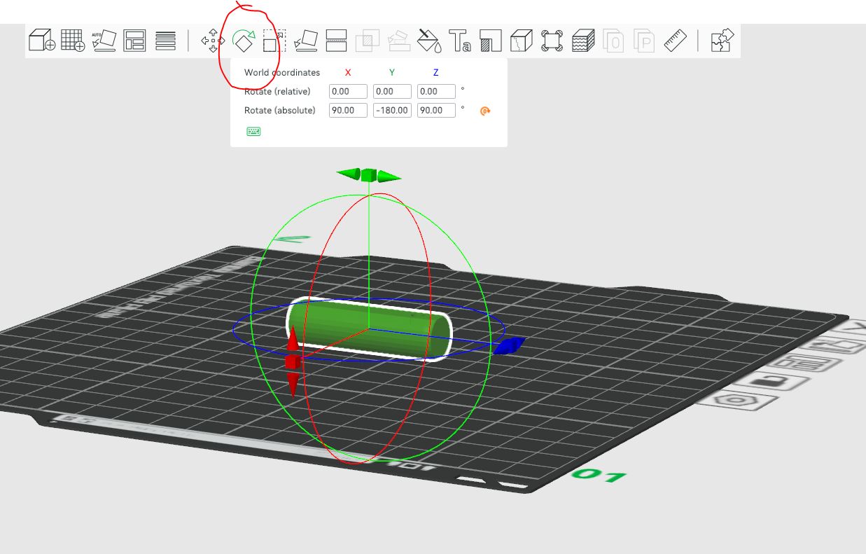

The answer is in the title of your post.,
You can rotate the model in the Slicer.
right, but it has a 90 degree turn, one or the other will always be long way… no?
I don’t think Studio has a way to change directions in the way you are seeking.
OrcaSlicer does allow you to change the direction of sparse infill. You can add modifiers to specific areas and adjust infill angles for better bridges.
Ill give this the solution since it is technically a way to do it, though its outside the preferred program, this may help someone, so thank you
