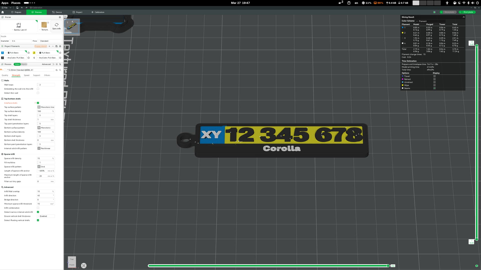

Slicing assembly object with multiple colors shows weird shifting issue
Printer bambu lab a1 with 0.4mm nozzle.
I have the following car plate 3mf (attached to the topic).
car-plate.3mf (88.9 KB)
The object looks like this.

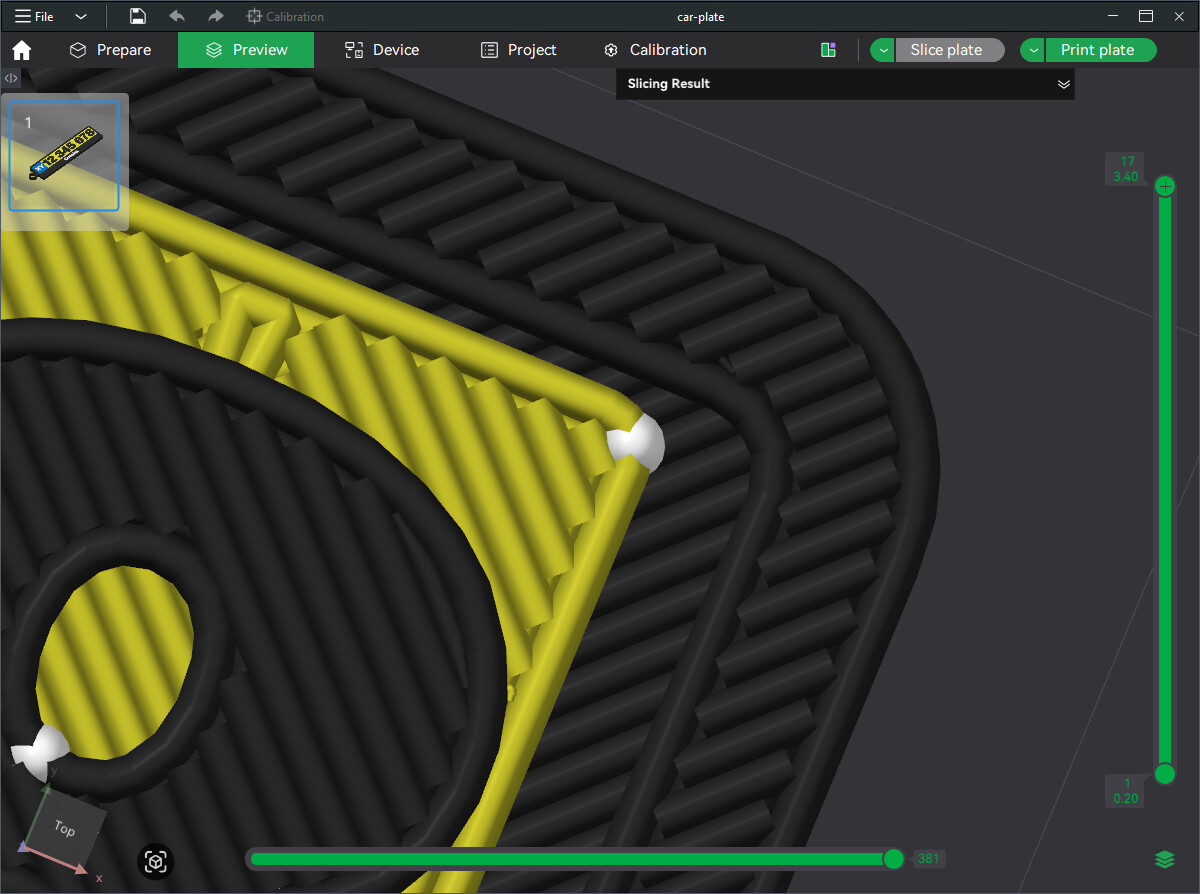

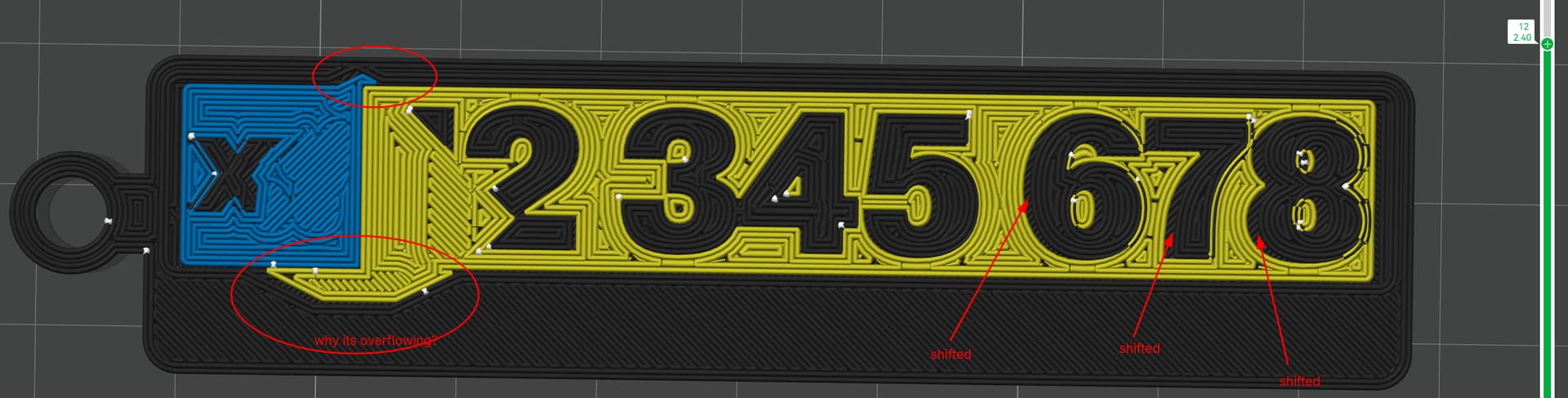

When I slice it I can see weird things happening, for example in layer 12
We can see the the numbers have shifted or the background behind them is not fully filled.
We can also see that the colors have overflowed to the edges.
if we jump to the latest layer we still can see the issue going.
this have drove me creazy. I tried to change the font size, the plate size and text text positiong, nothing worked for me, help would be appriciated.

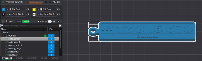

Honestly I’m not sure what the slicer is doing there. It may be fixable as-is, but…

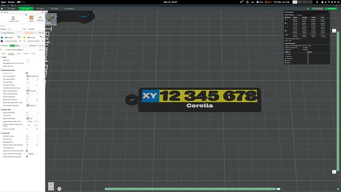

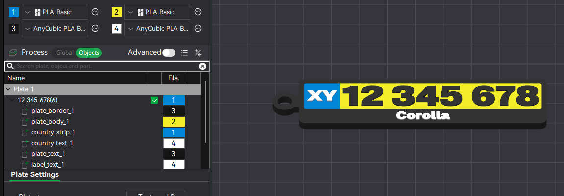

I removed all painting and assigned filament colors directly to the parts. Looks great.

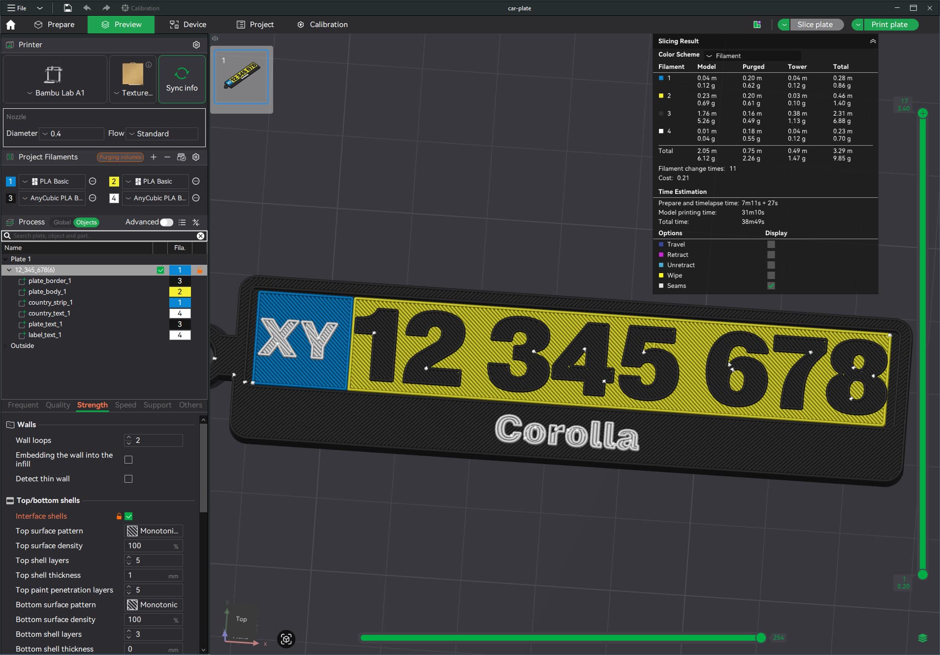

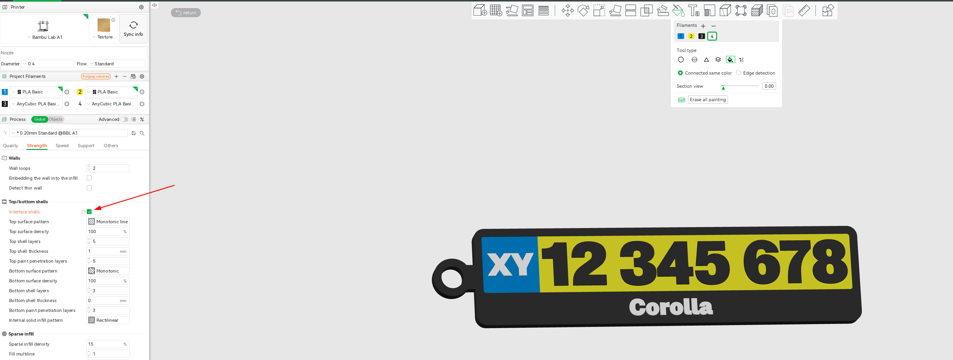

If you enable “develop mode” in Studio settings, you get a new option in “Strength” settings named “Interface shells”. Enabling that for this model cleans the print up a bit more (on the inside bits, so it’s not essential). By itself that may or may not help if you keep the painting as it was, not sure.
-Max
I tried to do as you suggested.

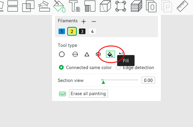

I have used fill
selected the right colors.
enabled interface shells
The object still looks bad, your result looks way better.

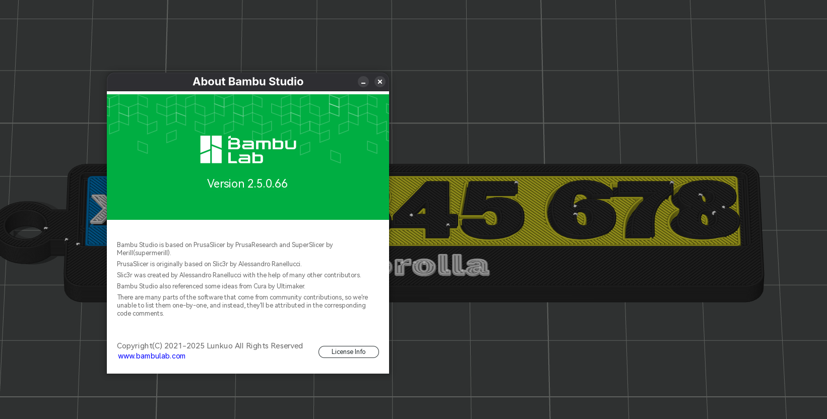

This is my bambu studio version.

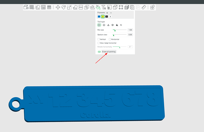

The first step, removing the painting is good.

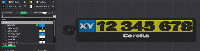

But after that, close the paint tool. Then select each part in the object list, on the left, and assign a filament to it (you can r-click that line for a menu, or just hit the digit key on your keyboard corresponding to the filament number).
The result should be like in my screenshot, with each part showing a filament color.
LMK how that works out!
-Max
thank you, I got a matching result, its weird why that is happening?
I will print a sample and check it out, thanks again :slight_smile:

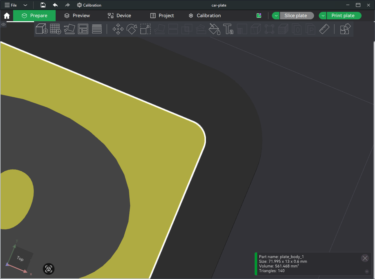

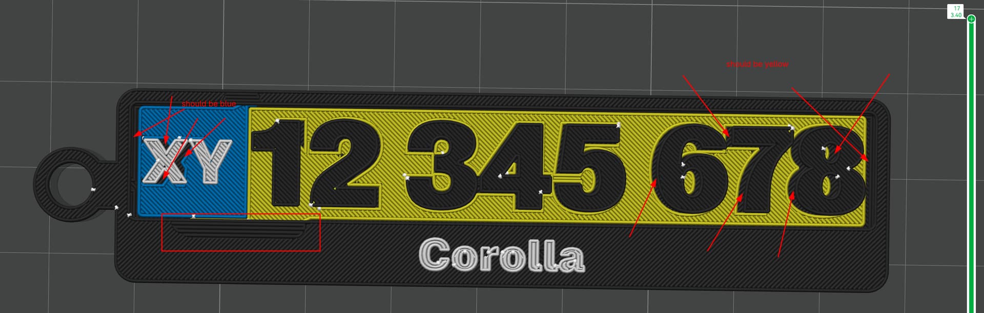

One odd thing… the sliced version puts this gap around the “pate body” and “country strip” parts, and I have no idea where that comes from. Or maybe it’s shrinking the black border area, rather, away from the inside parts. May also be one reason the painting was coming out funky.
There are no gaps in the model, AFAICT…
:thinking:
-M
yeah those gaps are annoying, if anyone knows a solution I’ll me greatful.
nevertheless the current result is somewhat acceptable still way better than the original.
Got it!
The AnyCubic PLA filament settings have shrinkage rate set to 98%. Set that to 100% and the gap is gone.
-M

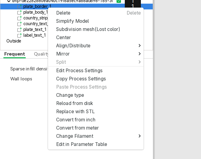

Seeing as the parts are already coloured in Studio but the original .3mf file has them all as one filament I’m guessing these parts were imported as a coloured OBJ? This might explain the issue with the odd slicing.
The fix for this issues is to right click and “Fix” the top part. This clears whatever issue there was with the model and you simply need to assign the colors to the objects.
car-plate_fixed.3mf (97.4 KB)
I don’t think there’s any issue with the model, just removing the paint is all it needed to allow filament assignment to work. “Fixing” a model also removes any painting, even if it was already watertight.

FWIW, most of that odd shift in the original post was also caused by the filament shrinkage setting. Although even with that fixed, the X is still off, and the blue and yellow overlap is sill wonky… and “interface shells” doesn’t help. Assigning filaments is 100% nicer.

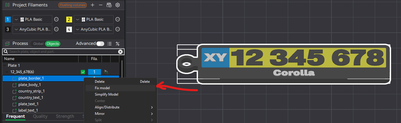

I can’t find the fix model option.
which bambu studio version do you have?
Ineed you’re correct, I got great result now, thanks for investing your time into this!
I’m learning new things everyday :slight_smile:
Are you using the Mac version? The “Fix Model” is only available in the windows version IIRC.
I’m using linux, oh how surprizing I though bambu studio have the same capabilites cross operating systems.
Fix Model
Bambu Studio will automatically repair models to a certain degree, but it may be necessary to fix the model using a dedicated service. If you are using Bambu Studio under Windows 10/11, it will have access to Microsoft’s APIs for repairing 3D models through Netfabb. Note that this feature is only supprted on the Windows platform.
