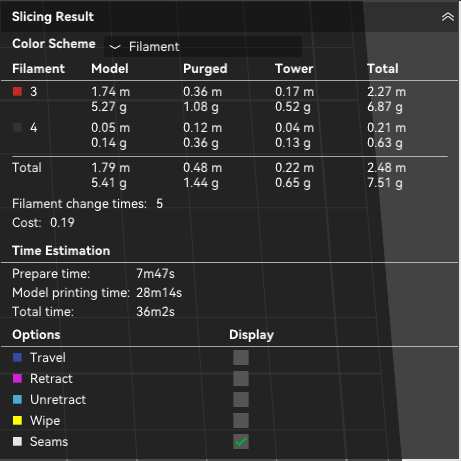

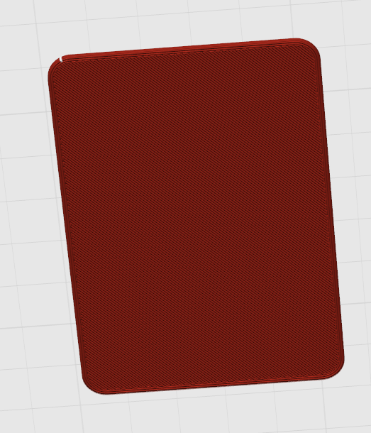

In Bambu Studio I split it into parts and re-assign the filaments to match my AMS so everything is colored correctly. 3 colors are used (red, black, blue). It looks ‘mostly’ fine (image 1 and 2). I don’t know why image 1 has a challenge showing the black power symbol, but its there and you can make it out. I assume its the software doesn’t like it since its flush with the ‘card’ piece. Then I slice it, and this is the issue I get.

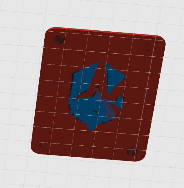

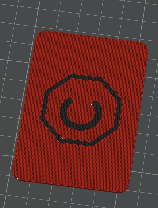

For some reason, when sliced, most of the parts are lost (image 3 and 4). When looking at the slicing results (image 5) the blue is gone completely, so I know that its not just a visual aspect but that the software simply ignored most of the parts.

Hi, are you able to post your project file? It’s hard to determine what is going on based on a few select images. It sounds like maybe the parts are being surface-painted instead of using the assigned filaments (that’s been a common issue lately), but it’s hard to say (shouldn’t happen with STL format anyway). Another possibility is that some of the parts are too small/thin to be printed (based on layer height or line width) and the slicer ignores them (or mostly). And that’s just two out of multiple possible causes… there’s no one universal solution.

Thank you for asking! I was about to do exactly that and I actually figured out what the problem was. The ‘card’ as a whole object is 12 parts. The slicing was showing the card itself (those 3 plates) and only 2 parts, the last two parts. When I organized the parts in a different order (the 3 ‘plates’ first, followed by everything else) and sliced it again, it worked perfectly!
